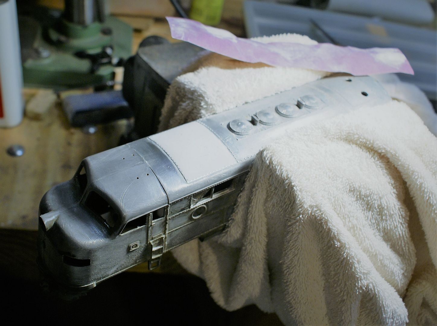

One of the now longest toothed (and largest) projects on my bench is a CGW Mill Cities Ltd; one passenger F unit, four (or five) composite heavyweights and maybe an express box car.

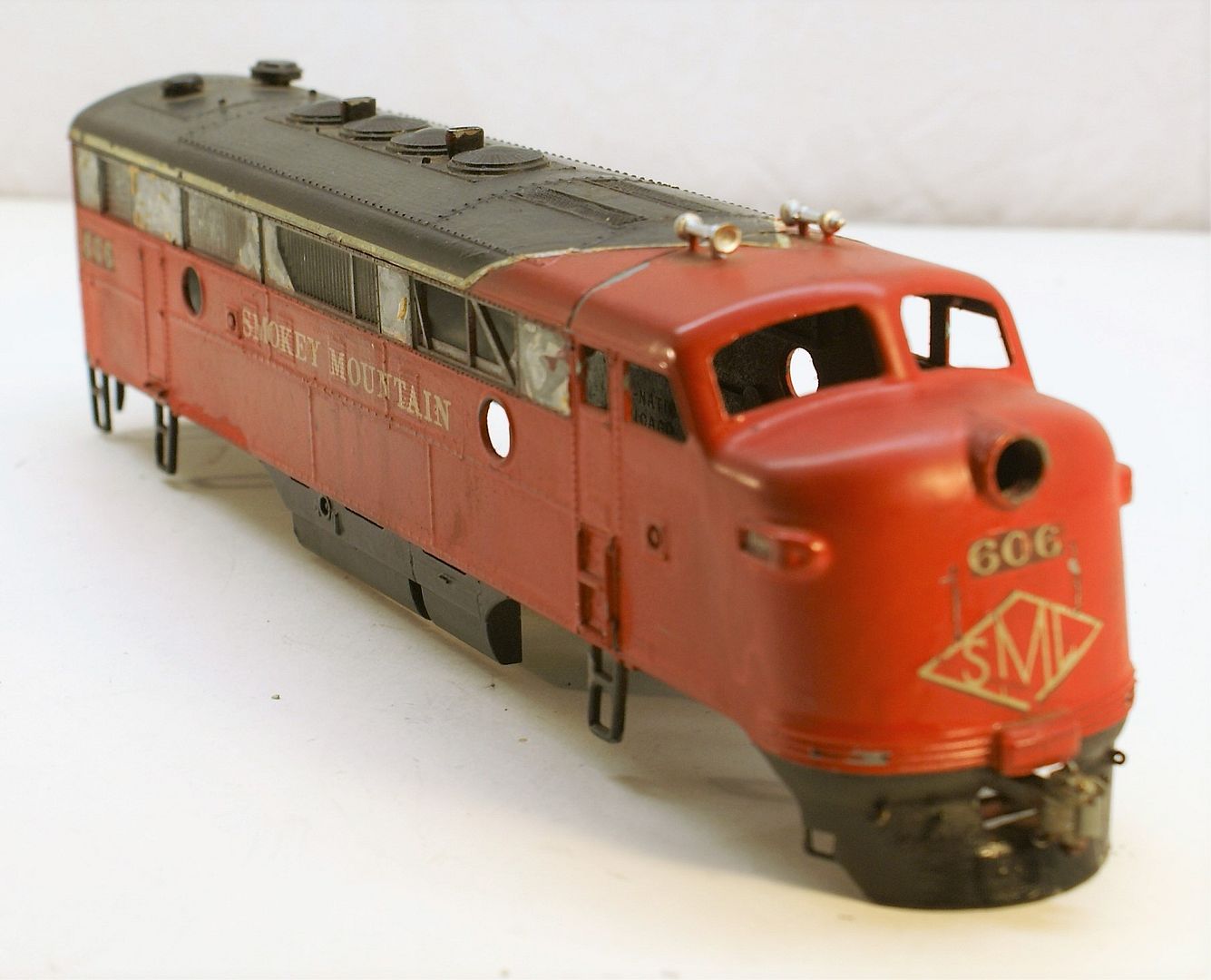

For the required passenger F unit, I’m recycling an Atwater “F7” picked up at the Chicago Meet in 2016, a well-worn veteran of the famous Smokey Mountain Lines club's.

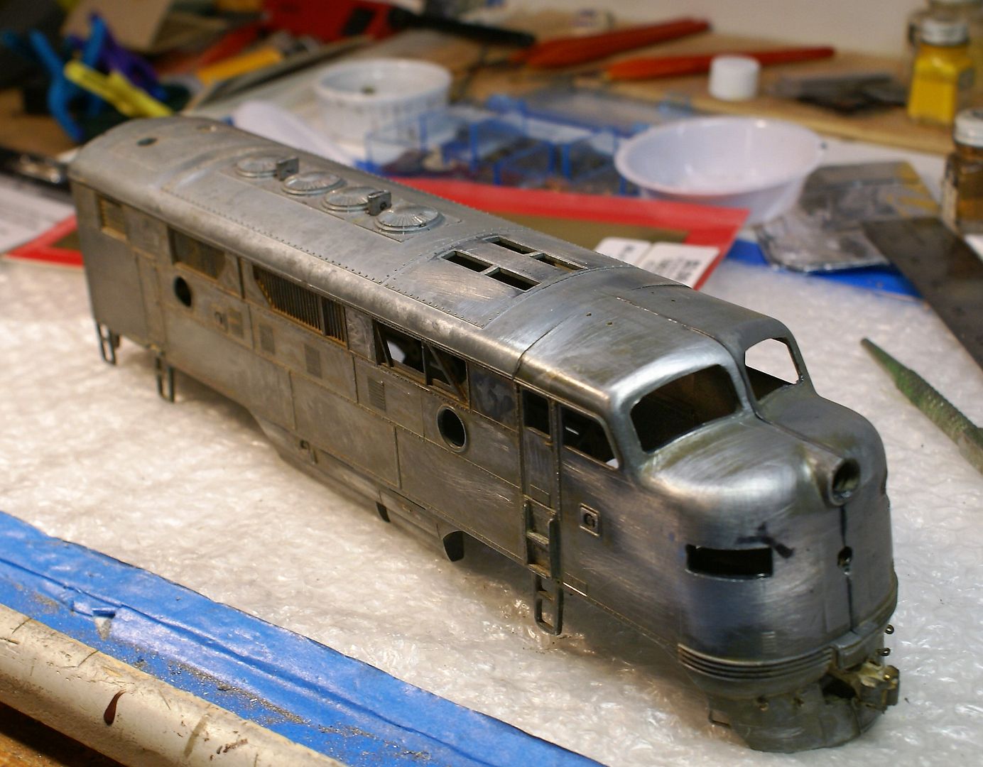

It had both trucks powered, ran and pulled great but needed some plastic surgery to CGW-ize it into one of their 150 series F3’s, specifically large number boards, a second door headlight and the early version dynamic brake slots removed, or specifically here covered over.
Dipped the paint off in brake fluid and cut some inserts out of sheet brass, applied a two-part stick epoxy that works like bondo, sanded off smooth.
More to follow, I go back to this in between the rebuilds for ebay and custom paint work.
