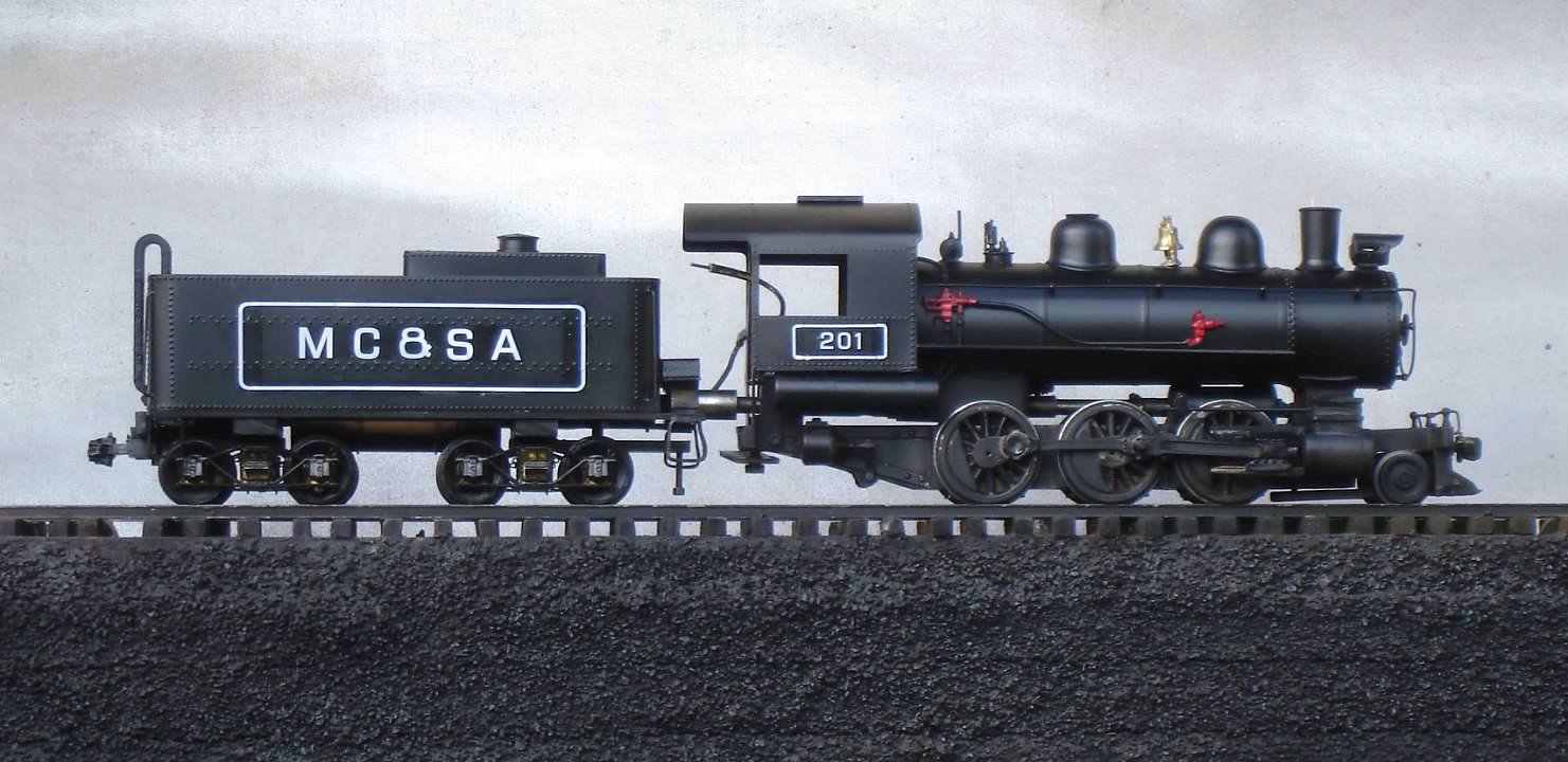

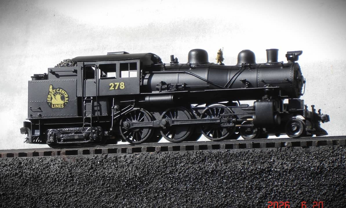

The two projects were shipped today - here is the builders photos:
Two things of note: The CNJ decals are by K4 - I shot Mike Hood a photo, and he responded right away - seems like a great outfit. The invoice said $7.50, and that included shipping. The film is perfect, and releases from the backing in 20 seconds. You can see the film, because I put them on semi gloss paint and did not overcoat - two "no-no's". But in real life you can hardly tell. Jim may redo them (plenty of decals left) or just shoot dullcote on it.
The tender trucks are Kemtron Wabash - arguably the best arch bar tender trucks in any scale! They came in a kit, but I had to make new bolsters. I may be sorry I did not loctite the tiny bolster screws in place - homework assignment for Jim.

Those are nice....I really like loco 278.
I contacted K4 about a month ago looking for some "E5" loco data decals for Greg, but Mike had none. I asked how many sets would need to be ordered for him to do run, but he wasn't interested and I understand that. But, with all our other decal manufacturers fading, it's nice to have someone like K4.

The locos look great! I look forward to seeing them run here in Dallas soon. Recently I was working on assembling 2 pairs of the Precision Scale trucks and did struggle a bit with drilling the screw holes and tapping them deep enough while not drilling too deep. So I can relate.
Im still holding out hope that you build that Chinese QJ 2-10-2. I think that would be unusual. You have mentioned it over the years several times.
