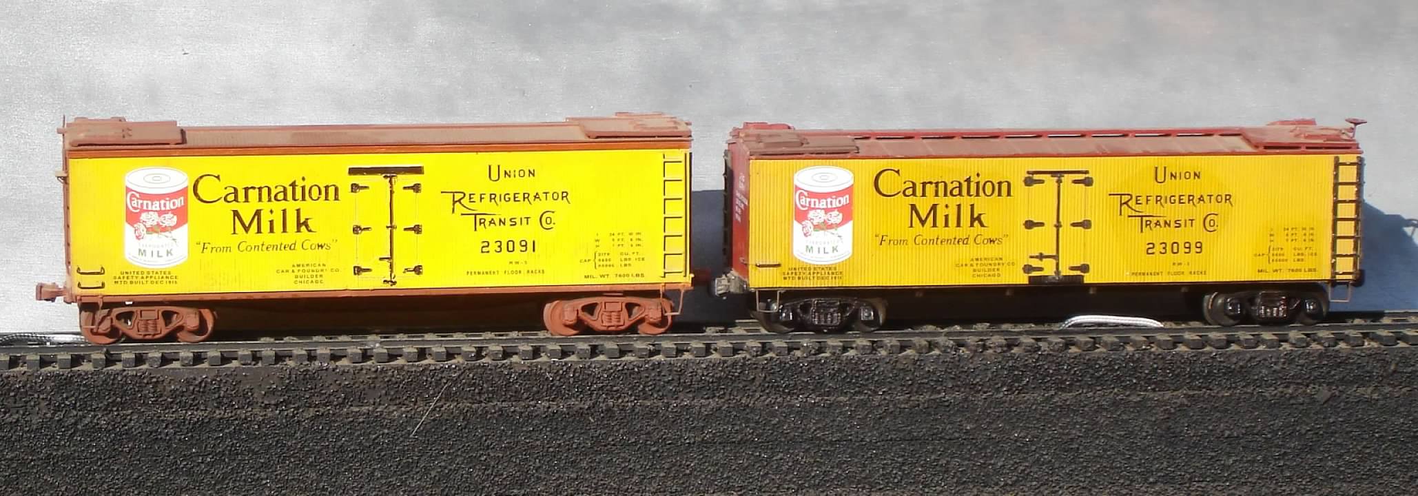

Well, I do need help. First, I believe Dennis' car is the color I am looking for - but photo reproduction sometimes changes colors. Here is one of my "good" orange cars:
This may be Milwaukee Orange - it may be also Krylon "Popsicle" - I am checking that. Probably Krylon no longer makes "Popsicle," since yellows and oranges have suffered from lack of chromium.
But here is where I need help - I have Milwaukee Orange in a very short bottle with a huge plastic top, and the label has come off. All it says for sure is Scale Coat.
But I believe the smaller bottles were Scale Coat II - and further, I believe that may have been water-based. I will try a tiny bit with water, and another tiny bit with lacquer thinner, but I welcome any hints - I have very limited experience with water based paint.

If it helps, Bob, Scalecoat 2 is solvent based.
I'd still suggest giving Trucolor a look. It also is solvent based so should be familiar ground. If you are trying for the first time, rather than one of their big bottles of thinner you can get a little bottle (same sized as the paints). The brush can be cleaned in acetone but I'd actually thin (if necessary) with their thinner which does have a bit of toluene in it. Shoot it on a piece of sheet or a scrap carbody to get a quick calibrated feel, then go for the real thing.
I'm with you on shooting water-base. I have little experience and less success with it, but I'm sure the latter is because of the former. The day might come I have to learn it; the IPMS guys use it to great effect and have several ranges to choose from.

Color looks good and one thing about yellow or orange, a little weathering can really change the color or hue of the paint.

I have a caboose painted Krylon Popsicle, and it is very close! So a can is on order - 57 cents an ounce, and free shipping!
The new model paints seem to be around $10/oz, with ten bucks shipping. Granted, that is the cost of a single Margarita at the airport bar, but it hurts something inside to be so profligate. I really should support TruColor's efforts, but somehow . . .
Let me see if that caboose is around:
Yeah - here. Built by Hal Sharkey, painted by George Wilson, admired by me -
