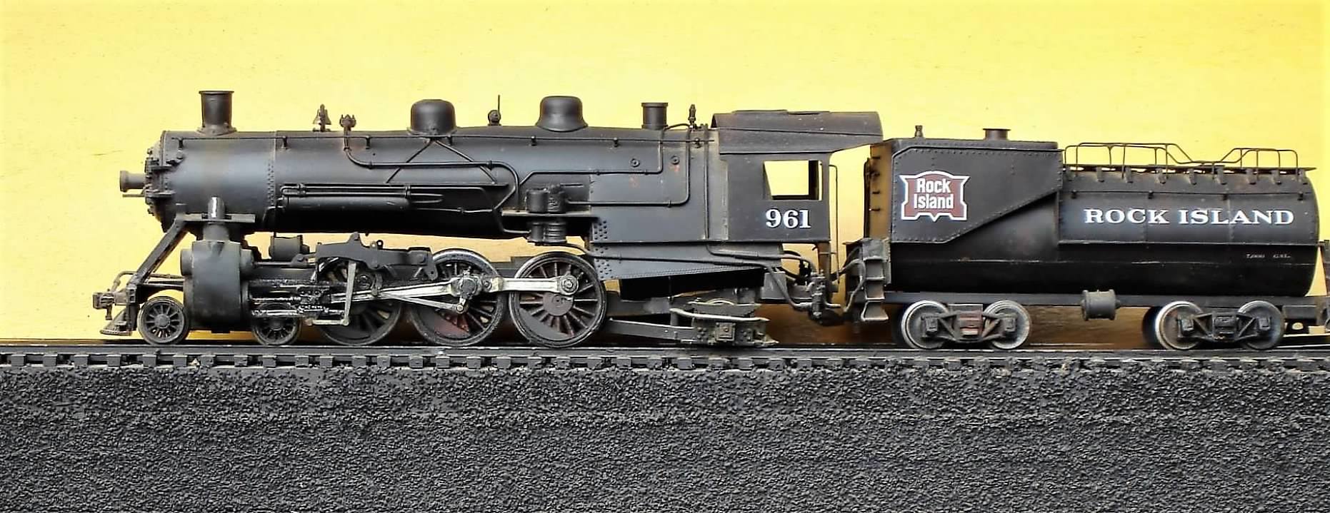

Did some study of Stagner’s photos. Turns out the Rock Island K-55 classMikes were USRA. Stagner has no photos with the original 1919 cab - they are all of the “Sport” cab that resembles a telephone booth with a slanted side. But the drawings show a cab that looks like Maroon’s model.
So, time for rattle can black and a Rock Island logo. It is possible that I have some spares.

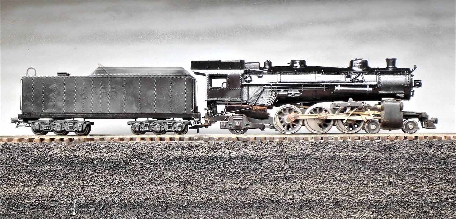

Yes - the first one is a dirtbag AN Pacific with a few modifications. I don't care if it jumps the track and falls five feet to the concrete - it would most likely crack the floor. I think it is a Lobaugh frame with Pittman/NWSL, but after four years and a minimum of wheel tread cleaning it smoothly leaped into action!
I searched in vain for a prototype - then I spotted the KATY Pacifics. Boxpok drivers, six axle tenders - close enough. Ordering vinyl from Callie for the tender soon.

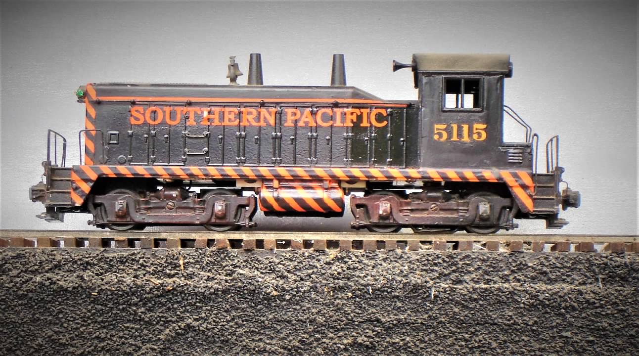

Not much is going on, I guess. Here is the latest problem child - might be my second Diesel model in O Scale, say circa 1972. It has those awful sintered iron wheels, so you can see track sliders under one of the trucks. We painted it bright orange, then masked for the black.
It was totally frozen yesterday - motor would not move, and the Liquid Wrench was elsewhere - so I used what I had - WD-40 - and got it to move, slowly. It is now once again pulling freight cars on the newly rejuvenated #3 loop.
The legend SOUTHERN PACIFIC was done by Callie Graphics in vinyl (no decal is bright enough over black, even those with white underlays) and the number is next on my Callie list, along with a pair of Katy shields for a tender and some maroon strips for my very small Milwaukee passenger fleet.
The number, by the way, was used on a GE 70-ton locomotive that hauled the Tombstone Doodlebug in the mid 1950s after they retired Mogul 1674.

Postby up148 » Mon Jun 10, 2024 9:20 am
Great photo Bob. I've always loved the tiger stripe switcher paint jobs used by the SP. If I ever built a switching module I would forgo the UP and have the SP paint job. Simple, but striking!

I am going to get Callie to make a set with stripes for my SD9. I do have double sets of the Microscale decals (you need two to get the bright orange to “pop”) but prefer the vinyl on smooth surfaces. Photo of that maybe in 2025.

Postby De Bruin » Mon Jun 10, 2024 3:38 pm
Good looking NW2, that orange and black SP switcher scheme is classic. Agree it's difficult to get the right amount brightness in the orange too. I've considered painting the entire shell bright orange first and then masking off stripes and using appropriate sized vinyl lettering for the road name and number and THEN blowing on the black. I'm sure you'd likely get some (hopefully) minor bleed-over with the lettering and numbers but I'd fix that with a brush by hand. Hmmmmm....have a SLSW RS in the queue.....

De Bruin wrote:Good looking NW2, that orange and black SP switcher scheme is classic. Agree it's difficult to get the right amount brightness in the orange too. I've considered painting the entire shell bright orange first and then masking off stripes and using appropriate sized vinyl lettering for the road name and number and THEN blowing on the black. I'm sure you'd likely get some (hopefully) minor bleed-over with the lettering and numbers but I'd fix that with a brush by hand. Hmmmmm....have a SLSW RS in the queue.....
I always hit it with clear before spraying second coat. Clear gets under the masking and usually crisp lines result.
Burner......on that NW.....what is that between the wheels on rear truck? Skates for track pickups?
Posts: 987
Postby De Bruin » Mon Jun 10, 2024 8:27 pm
A real good point Dave, prior to spraying paint; a very brief shot of clear-coat "hard coats"/locks out the edge when you do the "pull-off"" though if you're really paranoid like me, a slight run-over of the tape seam afterward with a sharp wood fine point or thin blade edge often insures that clean pull-off happens.
It helps to be able to recognize how soft the end color-coats are too, which in my case is from experience as various brands are often inconsistent in their curing qualities as well is my application itself.
Kind of masking tape is key too, I've traditionally used 3-M but these days go with the Tamiya Orange masking tape unless it's spot spraying coatings against attached areas not requiring them.
