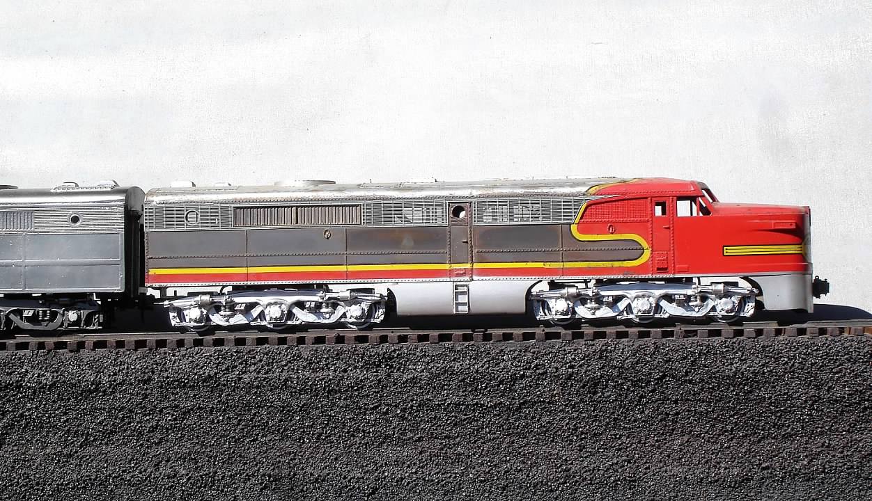

Getting ready to re-paint my nickel silver ATSF PA. I am using Alclad II stainless, but am looking for a match for the ATSF red on the warbonnet. Scale Coat SP red was perfect, but alas . . .
Any ideas? Is there a DupliColor rattle can that is close?
Posts: 13671
Re: Alco PA and FA 2023
Postby bob turner » Tue Jun 27, 2023 3:14 pm
You can see in the photo where the nickel silver is tarnished, and has sort of bled through the silver paint on the roof. Same has happened to the red, so the plan is a thorough cleanup, a light bead blast, primer all over, then black, Alclad, and rattle can silver and red where appropriate. I will add anti-climber and steps this go-around, and maybe a little light detail on the fuel tank. Nickel silver is a good idea, but the alloy used for casting always needs polishing. Almost as bad as silver. I think decorative plating would work better, but as with foundries, plating operations are few and expensive between.
