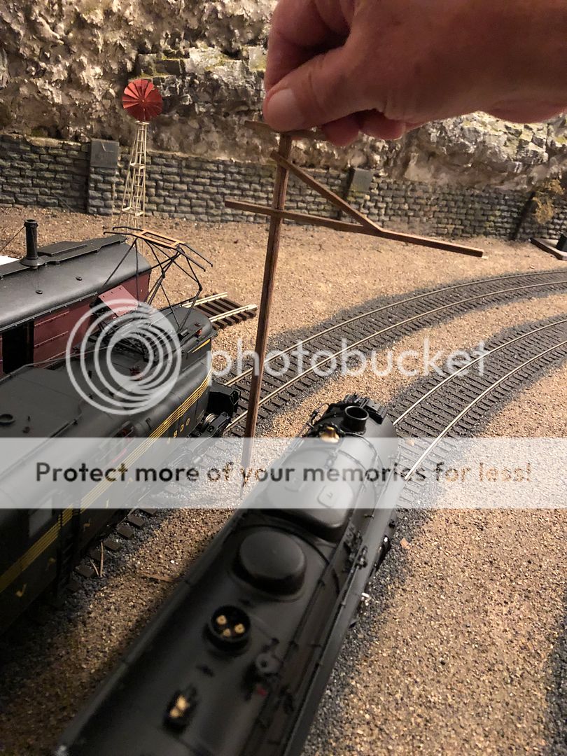

I am reluctant to thread drift here, as Jon and Pete's conversation is of interest. But, to answer Carey's question, I have never heard of or, as far as I know, seen anything by Druck. However, these came in just this week, donated by a good friend in support of the club's traction layout efforts:
All steel. We plan to use them.

R.K. Maroon wrote:However, these came in just this week, donated by a good friend in support of the club's traction layout efforts. All steel. We plan to use them.
Made by International Models, I have several loose ones and (somewhere) a box of them. The ones that I have are brass, not steel. Not shown in your photo is the rectangular base that the pole is soldered(?) into; it has two mounting holes, one near each end on the long axis.

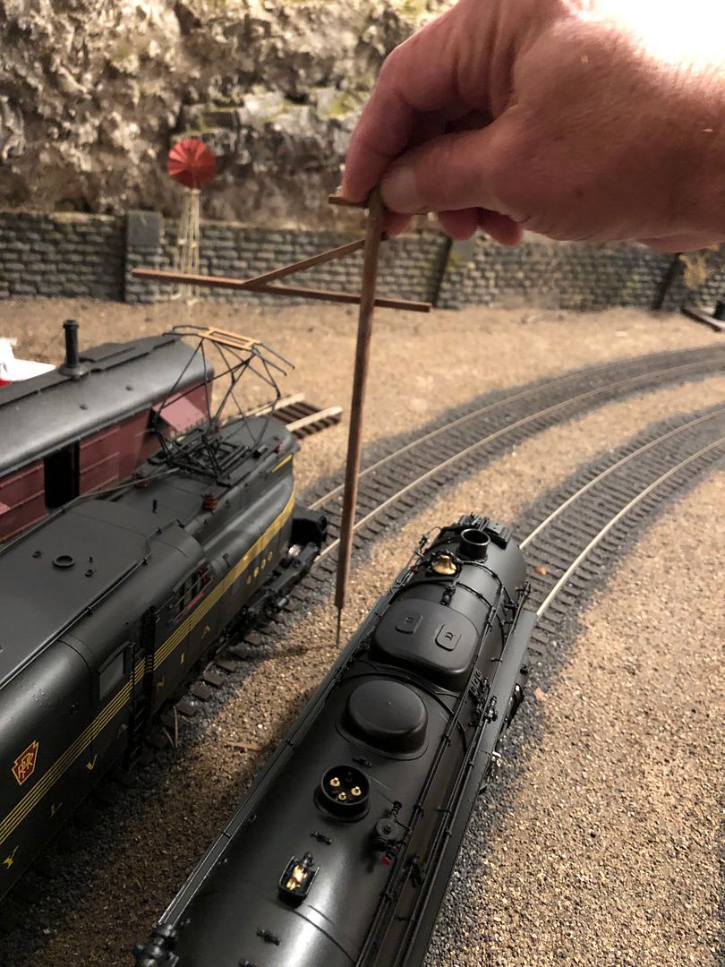

Well, the 2 track poles look mighty fine!!! I wasn’t sure if the closeness of my curves would allow me to put a pole between the two tracks. But I’m thinking it will be possible!

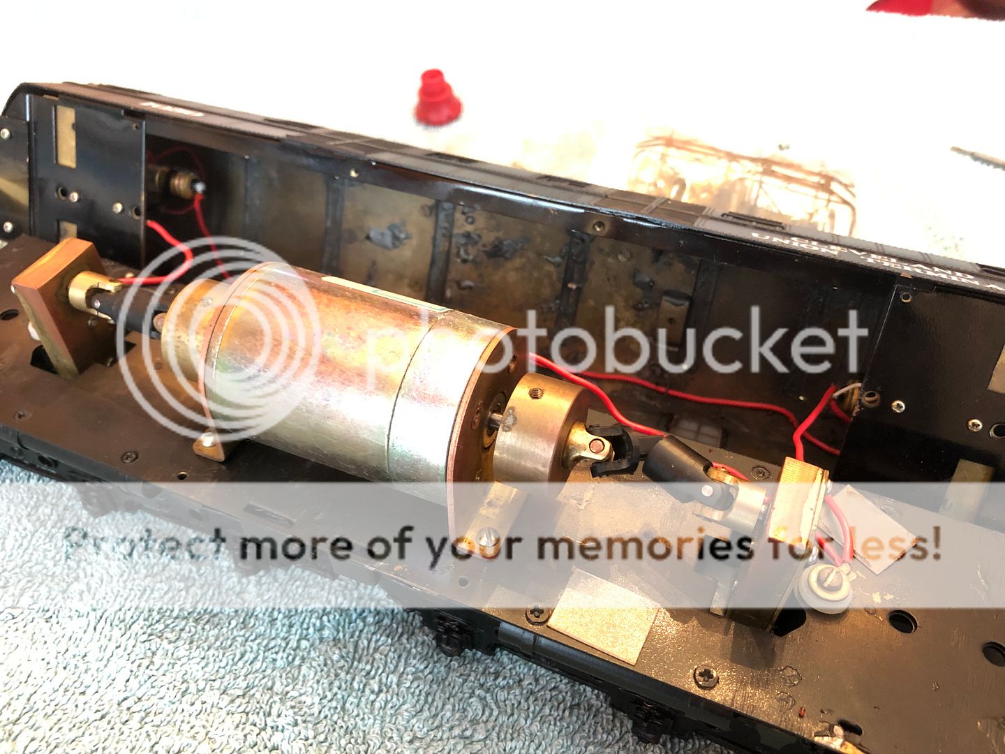

Hi Chris! I really appreciate you adding your expertise to this thread!!! I’m pretty good with a soldering iron (retired avionics tech) but I need to replace my burned out resistance soldering set.
Before I decide on which poles to go with I need to get this CUT P1 running to measure the pantograph height. So here seems a bit of an issue!

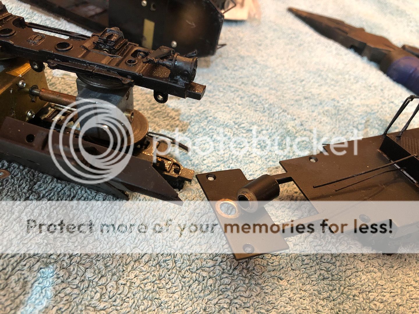

And the culprit appears!!
The solder joint on this plate bushing obviously failed.

2railjon wrote:The solder joint on this plate bushing obviously failed.![]()
The person who did the work failed. He failed to get the solder to flow into the joint.
I would clamp the plates to the rails and use a torch to get the plate hot enough to flow the solder.
Re: Help with Choosing A Catenary System
Hi Wayne! I’d have to go all the way to China to slap the guy that did that!
It’s repaired and I should have reassembled tomorrow!

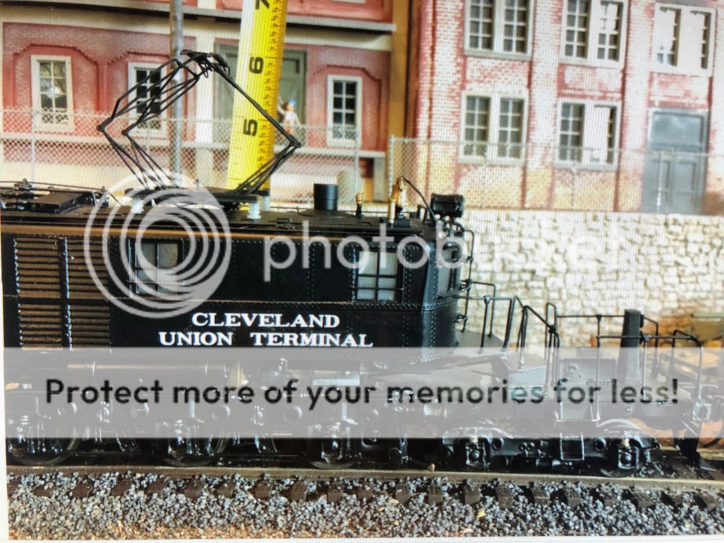

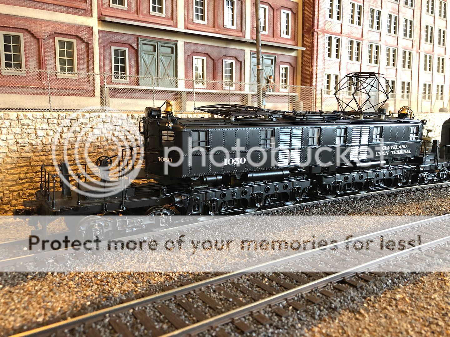

Ok, the P1 hit the tracks! The pantographs fully extended are 6”.
Close enough to the GG1’s

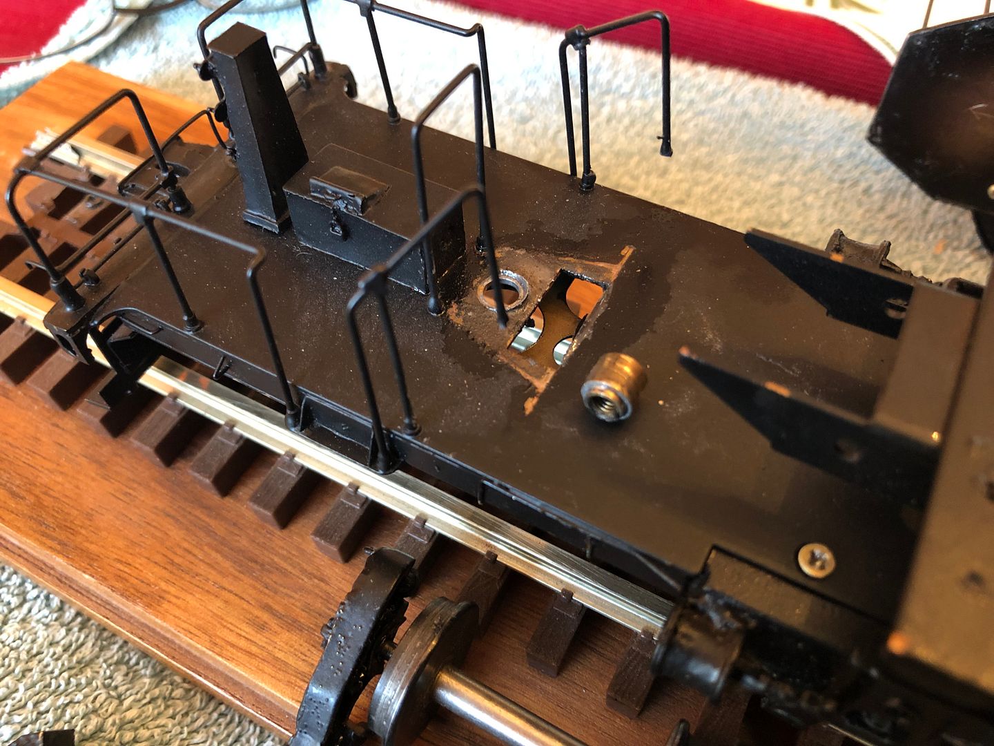

So.... back to the resurrection of the P1.
It ran intermittently on the loop shorting out in curves. So I picked the engine up reversed it’s direction and it ran fine.
My guess that a pilot truck was the problem proved to be correct.
The bushing that holds one of the pilot trucks was the case of another poor Asian soldering job.
