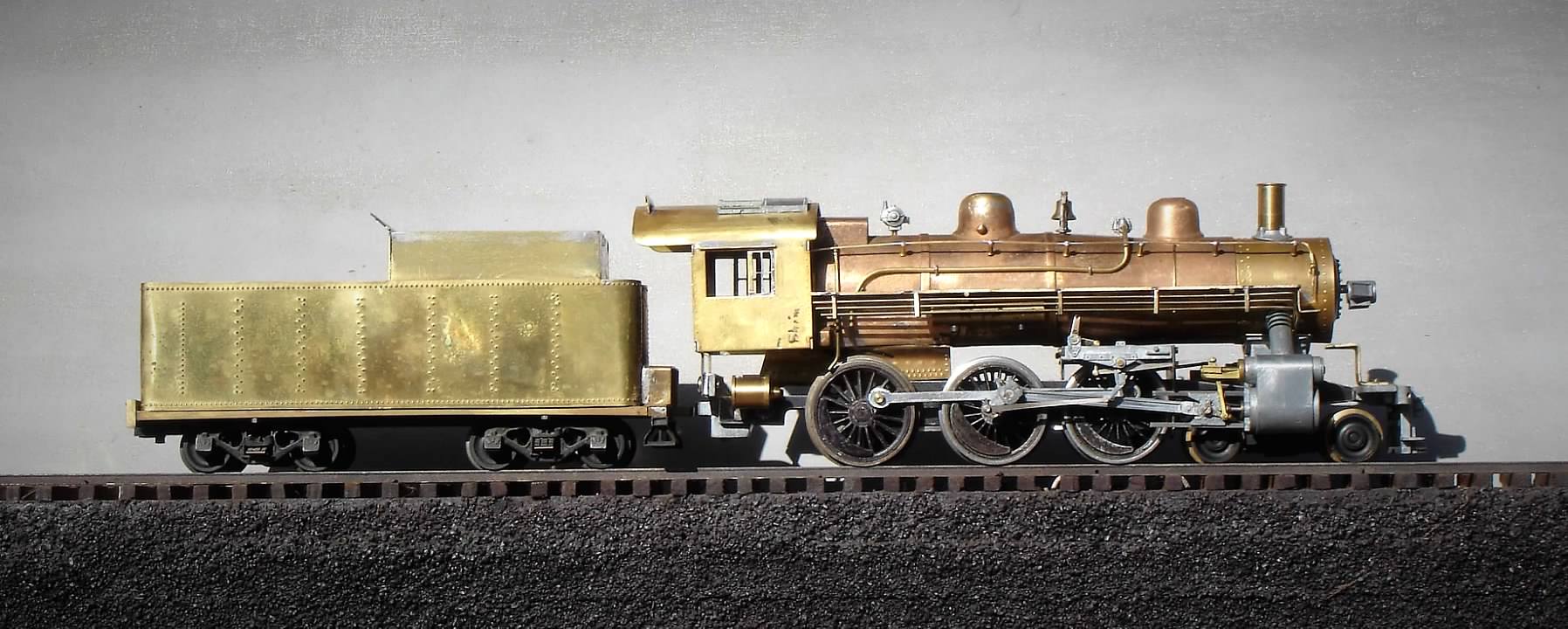

Here is one of my latest projects - an All-Nation Atlantic, slowly being converted to a ten-wheeler of dubious prototype.
Re: What’s on your Workbench?
Postby sarge » Fri Apr 08, 2022 6:55 am
Same one as you showed earlier? If so, nice progress. You changed tanks, too, I see.
If not the same one, there certainly is a "fleet" vibe going here.
