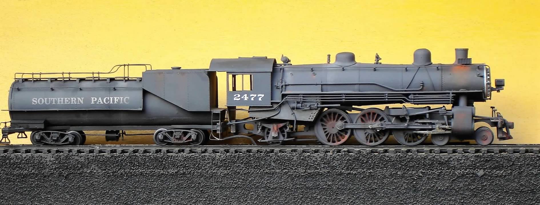

News! The Lobaugh Pacific, long known as not the most accurate model ever, really does ride high in front! I have maybe six of them in finished form, and every single one of them has a huge gap between the pilot wheels and the frame extension. Fortunately, I know how to fix that, and will do the first one this evening, after I remove SW's boiler for shipping.
I do know how to add arrows to illustrate the problem - but it is now so obvious. Just look above the front pilot wheel, right behind the pilot:

Re: ATSF Steam 2023 1/2
In this case, Floquil Grimy Black, plus a lot of grey, orange, and brown chalk, powdered and dusted on, and then Dullcote. The Dullkote takes the intensity out of the chalk in a hurry, so over-doing the chalk is difficult to do.

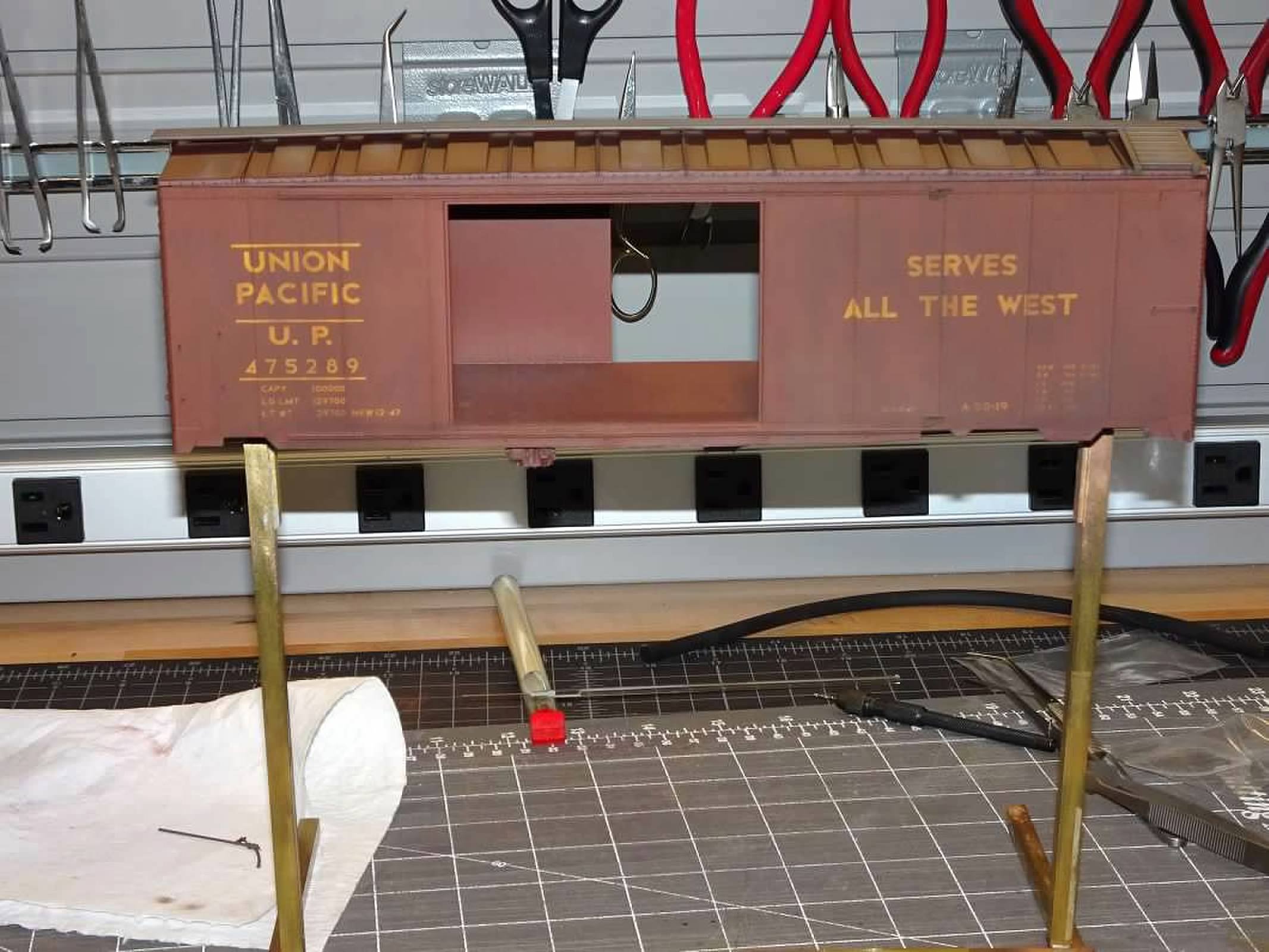

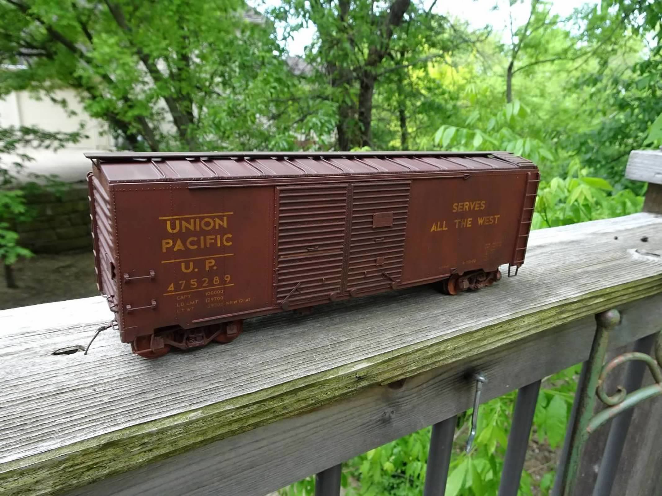

I think its your chalks that really brought it to life. I've used some PAN Pastels in the past which are as fine as women's cake make-up. They also have an adhesive added in that makes them stick better than just powdered chalks...........but they all need an overcoat or they will wear away with handling.
I tested it on this IM UP boxcar about 6 years ago and I was very happy with the results.....I just haven't done any other since.

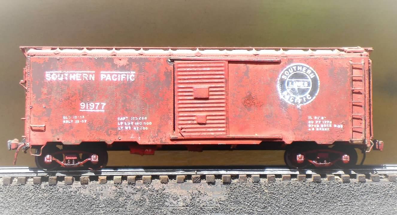

Here is my very first attempt at weathering. Bought the kit in 1955 - it was a silver and orange "Feather" car. It resides on 1 1/8" gauge track, and still runs weekly.
I surmise that SP car is S scale? Looks pretty good. I see no evidence of the feather.

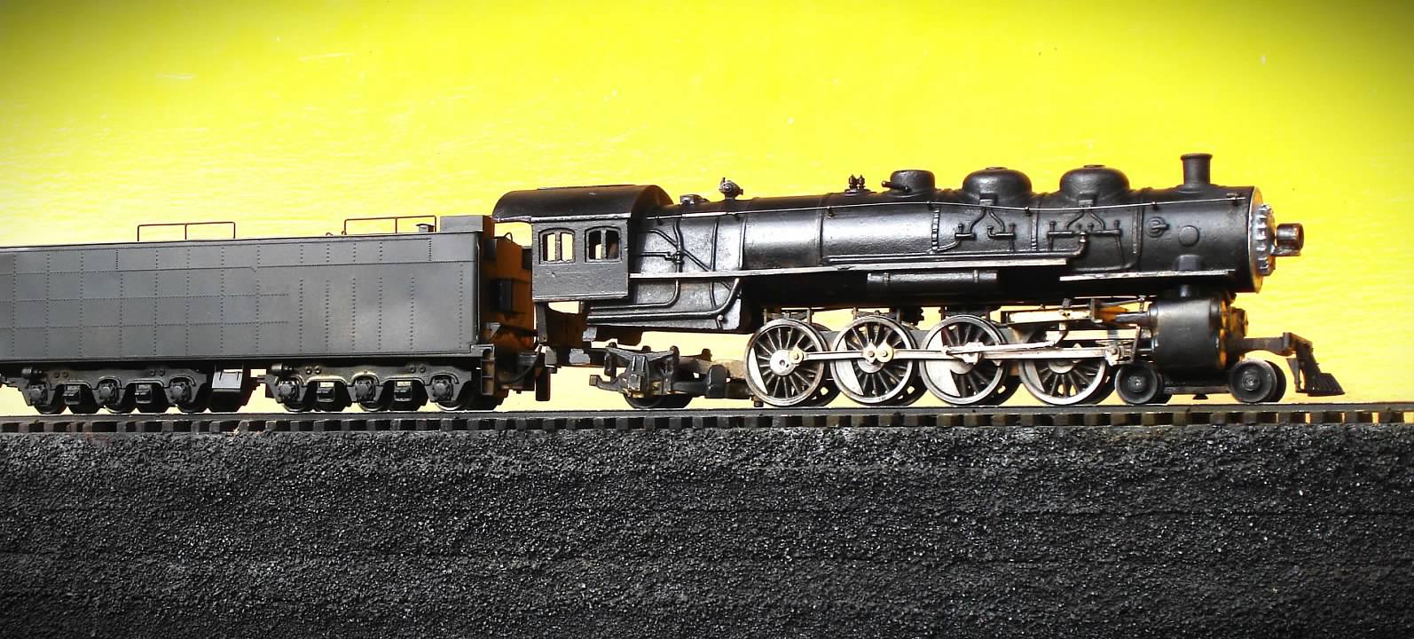

I never answered SW - the box car is Athearn O Scale - Trucks are Athearn die cast, but with machined steel bolsters. High School machining project - used a giant mill.
Back to the ATSF Steam - I brought the Mountain home a couple days ago, machined some brass to widen the running boards, and added some driver springs. It is not much changed from its preceding photo above, but still worth inserting. Shutterfly still loves me, since I bought an expanded copy of my SP Steam book.
Next steps for this heavy doorstop - an ashpan, some marker lights, some cooling coils and train lines under the running board, and better paint. But it serves its purpose of amusing me. I had to machine the brass for the running boards, because although I can purchase 3/32 square stock, it is really, really expensive, and the shipping doubled it.
