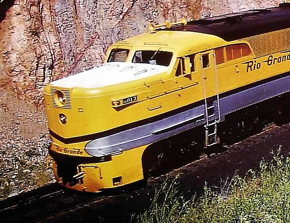

I was sort of hoping Jim would cut in my windshield, but I shall try here. The DRGW photo is for educational purposes, but it is a copyright photo found in Jim Boyd's book "The Alco PAs" - Morning Sun.
Let's try a comparison:

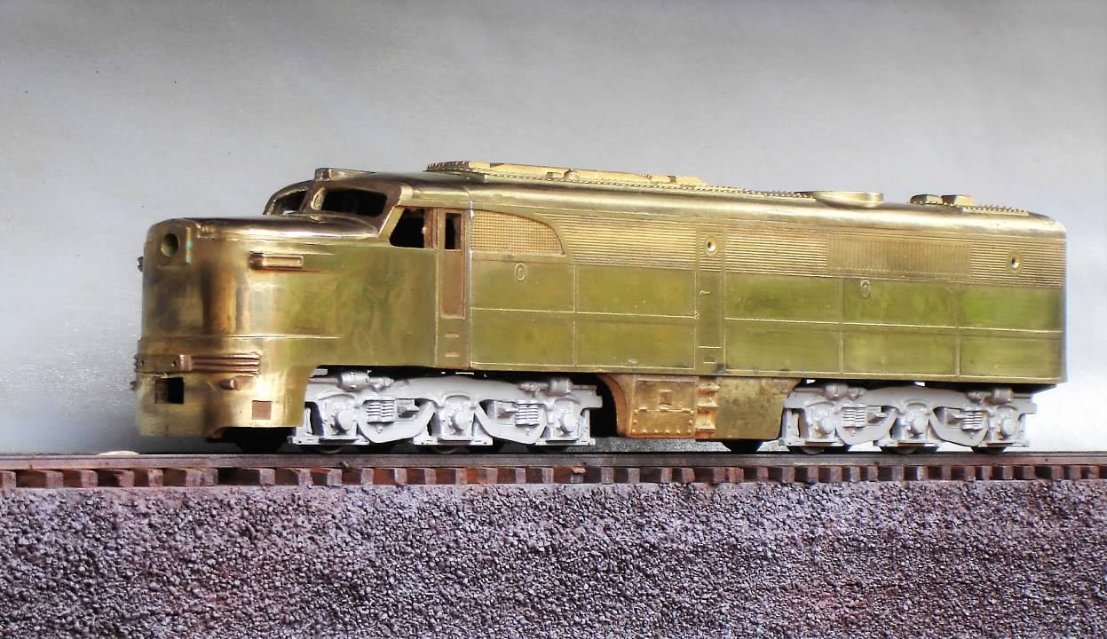

I shall repeat my "noses" just for kicks. Hey, not much else is going on! I note even OGR has two day old material.
Sure - you can see a slight "widow's peak" on the prototype, but even MTH exaggerated it. Lionel got it just about right. Amazingly, Lionel has been rolling out some really accurate stuff over the last quarter-century. All you have to do is change the wheels and couplers.

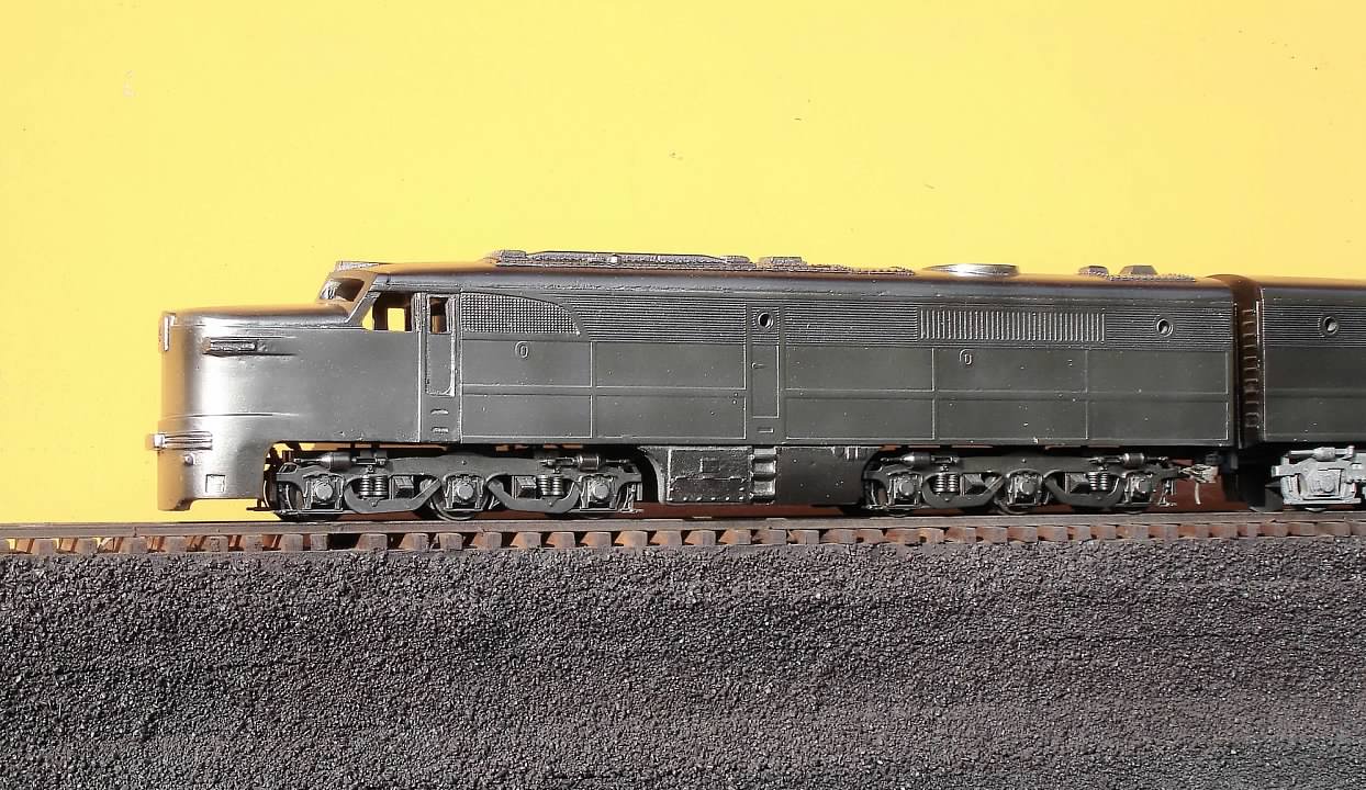

Here is this morning's contribution - sand cast CLW, but with an Alclad coating of "Stainless:"
Those are Lionel PA trucks, powered by Joe Foehrkolb for 2-rail.

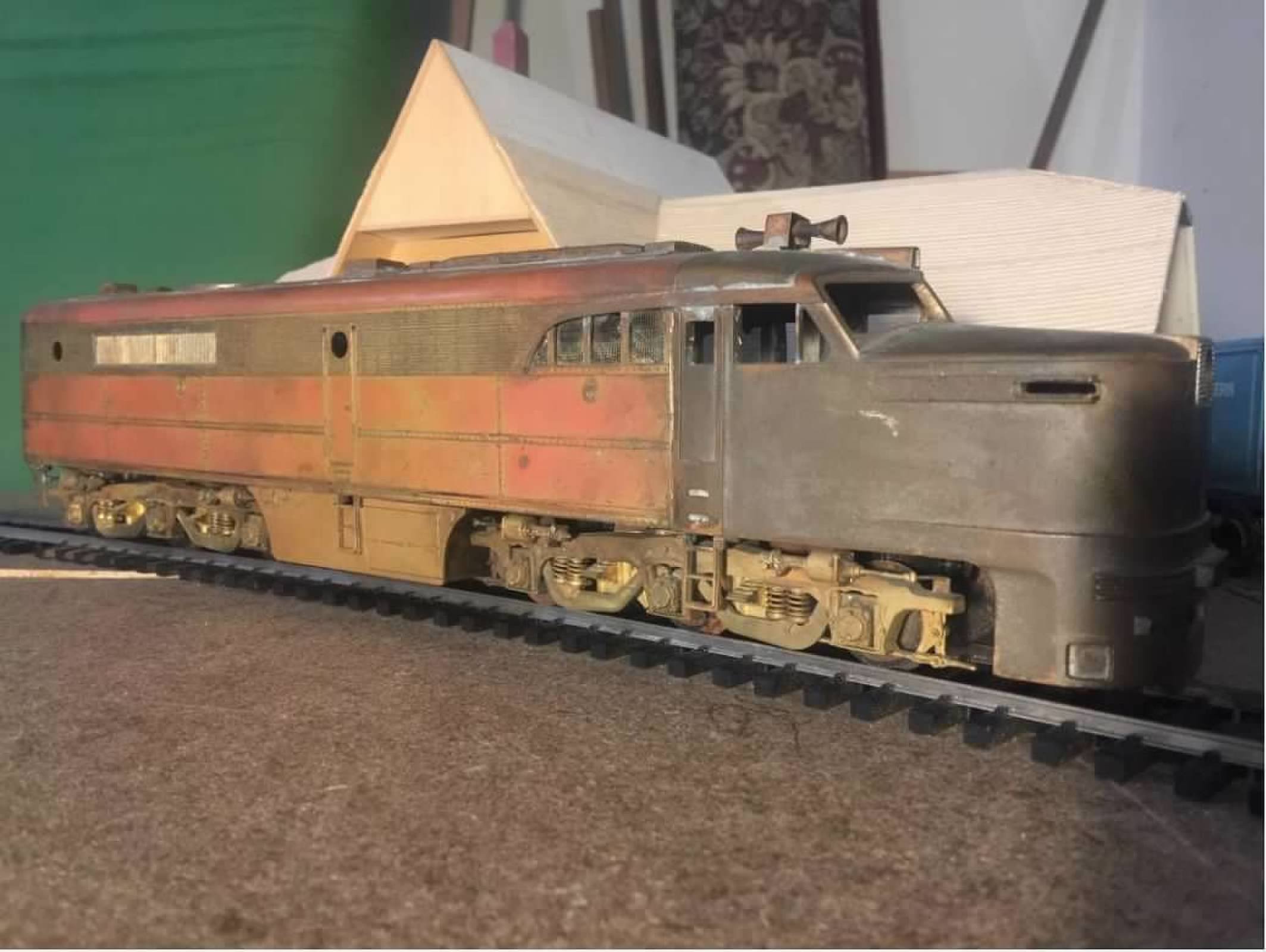

I modified the nose on this one, It has a story to tell as well.
My wife and I had to move, seven kids in a small three bedroom house thing. Sold the house to a single guy, who wonted to move in before the contract was finalised. I said no! but tolled him he could use the garage to store his stuff ( moving is trying for all ) The conversation took place outside the house, and I had a trailer full of my train stuff, out of my view. A few days latter I was at a swap meet, and spied a table with O scale on it ( unheard of almost in Aussi ) I chequed it out, I was thinking there is something familiar about this Central PA, and the work on the nose, and then It dawned on me, this model is mine!!! I told the man selling it, it was stolen , he was shocked, but co-opritive. It turned out a friend of a friend, asked him to sell it, It turned out to be the man buying our house. It was lifted with other train stuff during our conversation, whilst he was out of site behind his vehicle on that day, I had said no to him. The agent went go between, or I would have pressed charges. It was all returned So! Im grateful this one is still with me. It could have been months before I realised it was gone,( I don't usually go to swap meets, no O scale ) my gratitude lifted high.

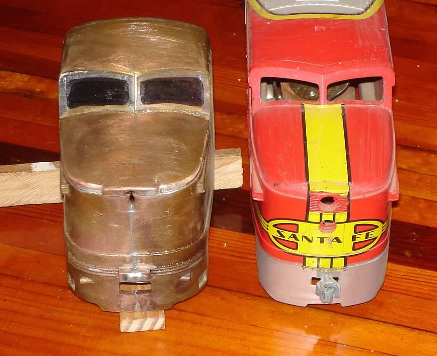

First, that nose: Here's what I think has to happen to make this ok:
Completely remove the hood. Then remove the nose about 1/4" in front of the windshield with vertical cuts. Re-attach it with a 1/4" spacer of brass (no, I haven't measured it yet - just a guess). Use solder, brass, and 2-56 brass F/H screws.
Then split the nose at the headlight to get the taper.
Then add .040 brass to the top of the nose before re-attaching the hood. Solder is enough here, assuming the sides and nose are pinned. Might need to make a new hood - I think I will just attach bar brass at the back.
This way the windshield area is reduced. Then a layer of brass with much more artful windshield openings, and back on the etched shell.
This first attempt shows you just how bad the original is. The unit on the right is MTH (in nickel silver). The MTH windshield is not perfect, but it is a lot closer. The Lionel windshield on the 83000 series models is about perfect, as is the Key.

I think this is the one I finished in Alclad "Stainless." I think you can see the windshield on this one is pretty darn good. You should know that the builder gets to cut the windshield, and I cannot imagine being able to do it with hand tools. I use an end mill before soldering, and a carbide burr after assembly, followed by jewelers files.

There was an article in 'O Scale Railroading' I think. I basically followed that article addressing the Central PA nose anomalies, and possible corrections. I filled the roof area above the windshields, lowering it, and also the window openings, then over lade them with sheet brass and created new openings. I created a new brow extending down around the side windows and vents. I have considered narrowing the nose with a big fill, but na! too many other projects, it still needs work. I dont think the nose will ever quite look long enough.
