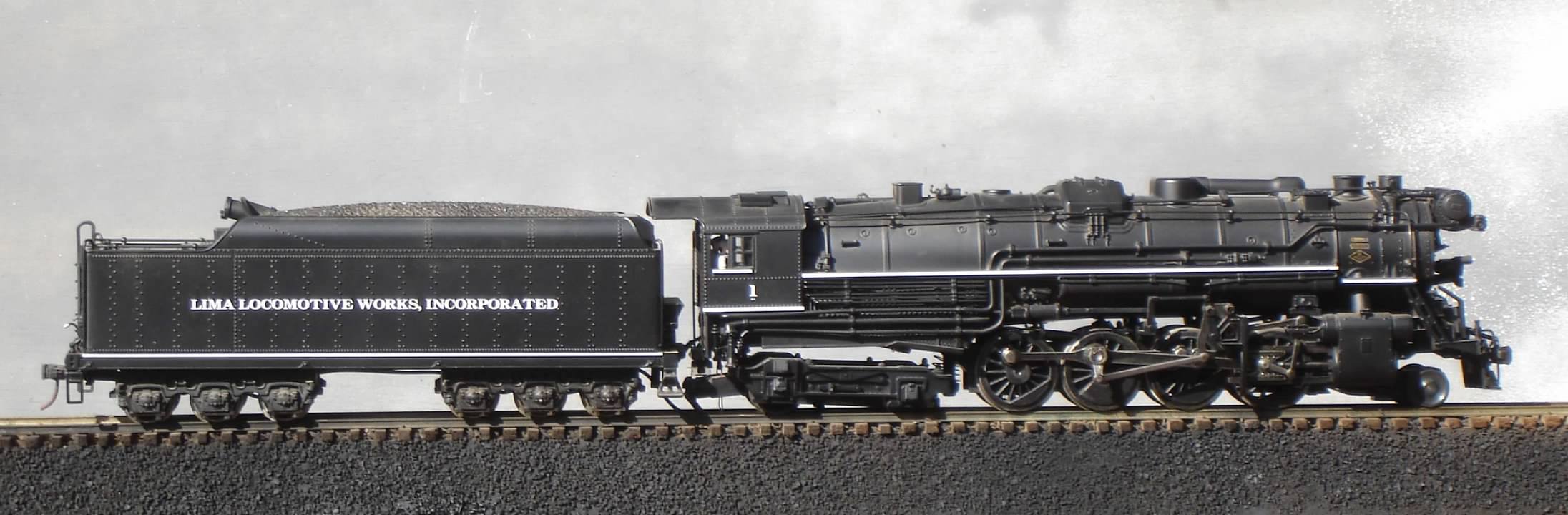

Here is another one that looks like it has trailing truck issues:
This is the K-Line die cast Lima berk with Lima lettering. It is not completely accurate for #1; the trailing truck was different and the tender sides were not curved at the top. Still, for a 3-rail model it was quite accurate, if a bit on the small size.
I 2-railed it, moved the motor into the firebox where God and most of the rest of us intended it to be, and cut the U shaped boiler off, replacing it with brass tubing and boiler bands. I have no idea what got into K-Line with motors and boiler bellies, but it could be a simple Chinese preference for easy die work. In any case, the K-Lines are well detailed above the running boards, and I can find little wrong with their drivers, cylinders, and rods. Truck side frames are as good as they get.
So far, not a hint of zinc pest on any of my die cast models. Too bad they decided Diesels had to be plastic. Well, maybe it is a good thing, because I have been entertained for two decades with efforts to make metal Diesel models. I should check my threads on those - photos might have died?

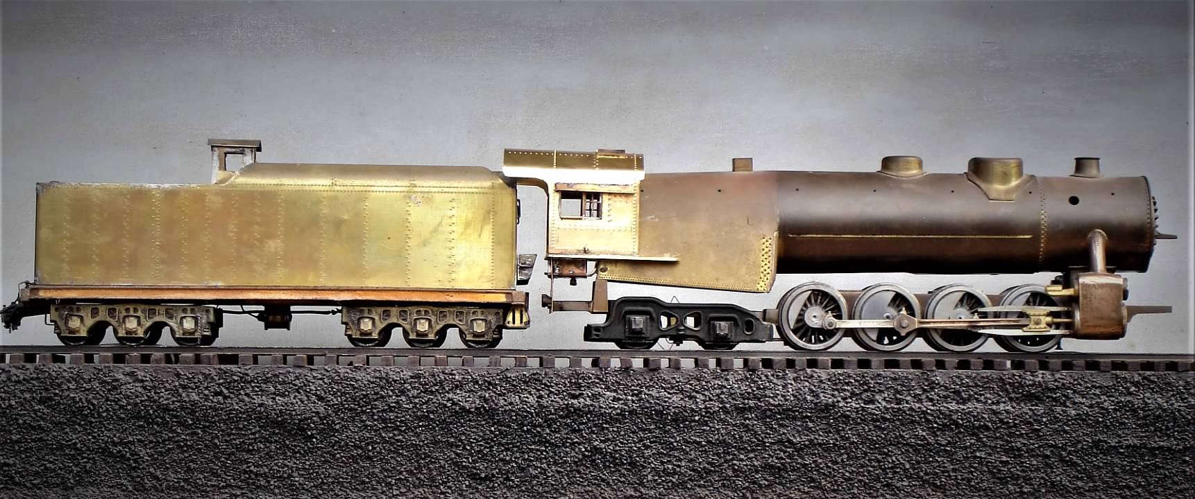

This is another non-Lobaugh. Its lineage is known to others, but the best I can figure it is an effort by Bob Smith with the help of Adams foundry. It is truly a doorstop; the boiler is one giant heavy chunk of brass. The cab takes some serious adjustment to fit correctly. Sure, I will paint the drivers someday, and decal the thing, right after I make a correct tender for it. It does run!
The current tender is a bronze version of the tender that came with the A-N Mountain. My understanding is that it was the tender supplied with this big Berk, but it is too short by almost an inch! Parked for now while I think of my next project.
