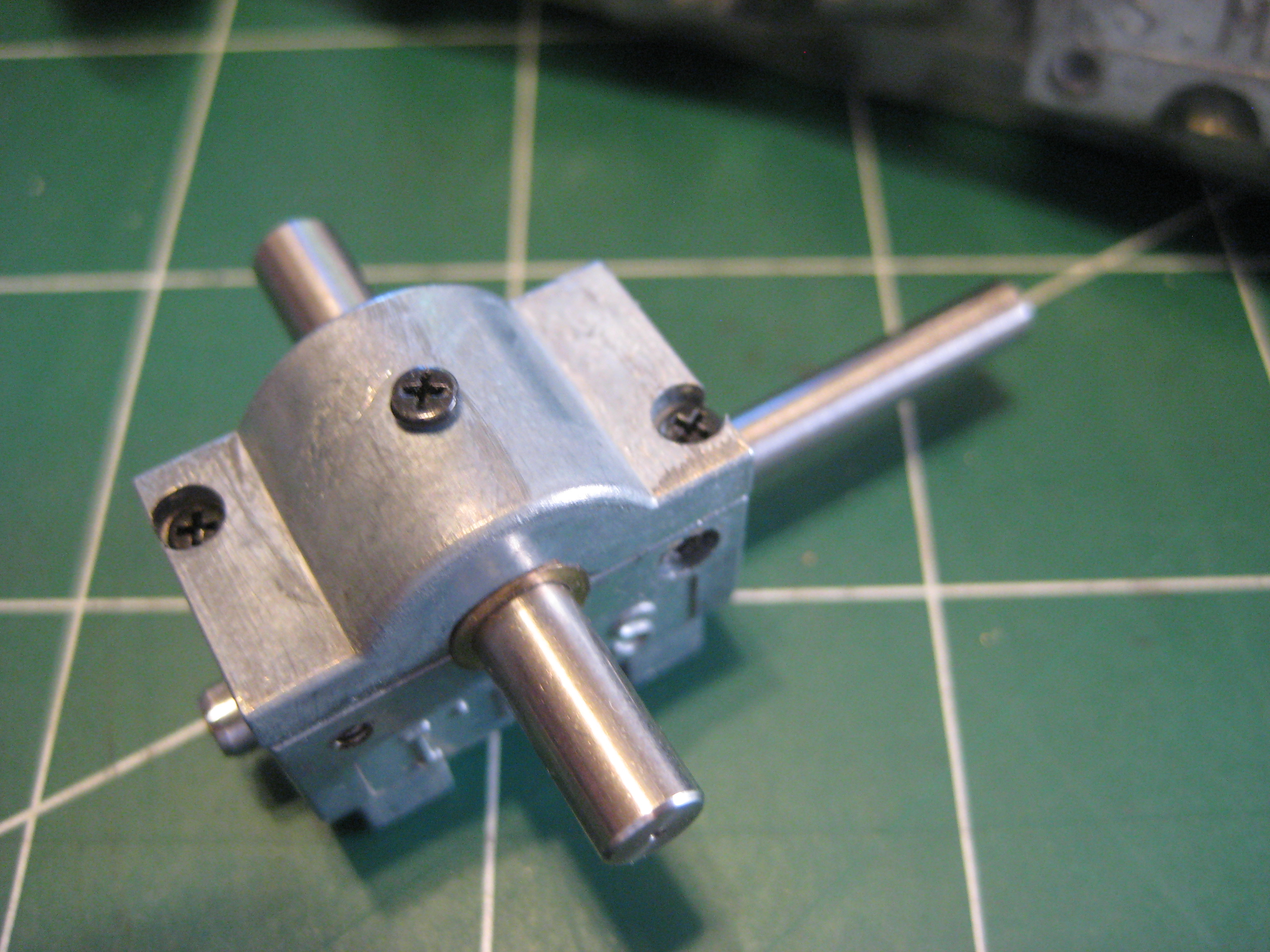

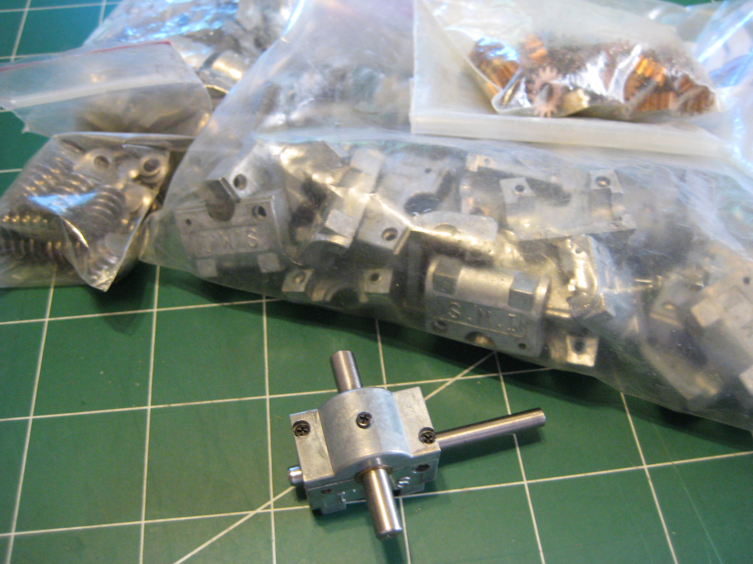

This is the Sunset 3rd Rail gearbox. Obviously unpainted. Note the 2mm screw in the center of the cover. I assume it's meant for adding lubricant. Look closely at the photo of the model in question. I can make out the same screw.

I had to save the photo, then crop, then lighten and midrange edit, then crop again, then zoom....and maybe I can see that lube port screw. Until I got to that point, it was a small fleck of white, maybe piece of styrofoam, maybe reflection.
So are those boxes any good?

Dave,
Actually, in my opinion, very good. Die cast metal case, steel worm, bronze worm gear, ball bearings on the input and brass, or maybe bronze, for the axle.
The ones I obtained had an issue with the cases being slightly undersized for the input bearings. A little time spent tweaking them and they work great. Obviously the factory couldn't spend the time so they modified the die to enlarge the area a few thou.
