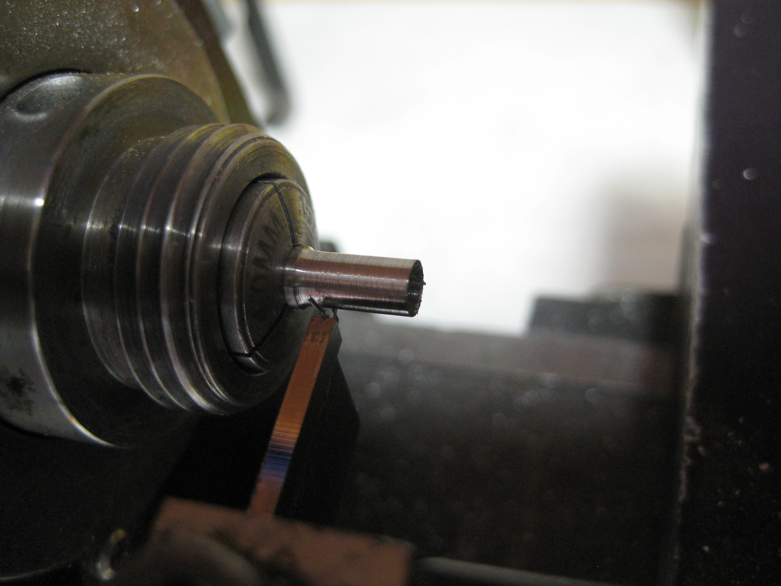

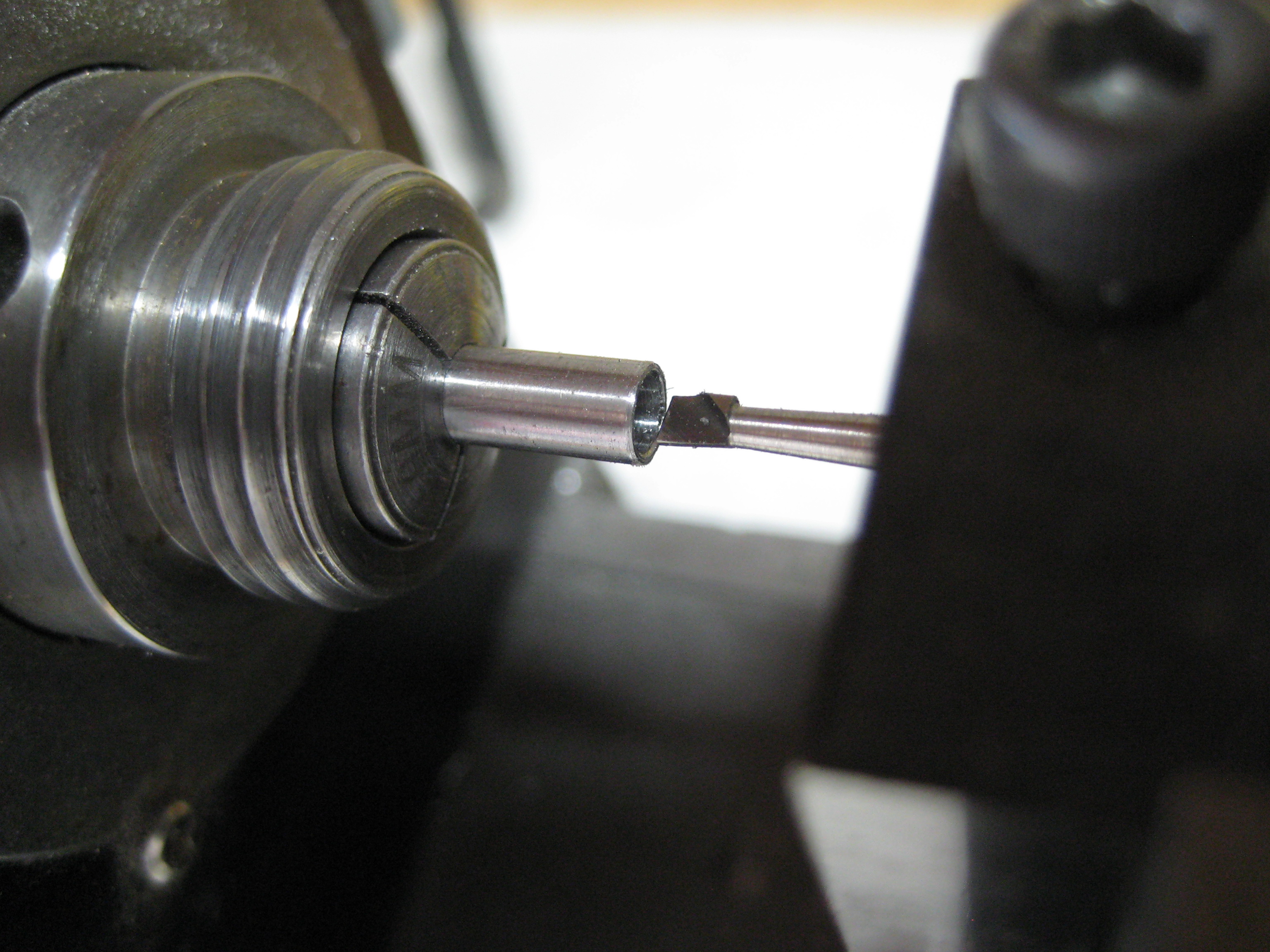

Post a photo of your tiny boring bar. I agree - drilling is not good. I have had some success with crankshaft drills and reams, but only in conjunction with shouldered axles.

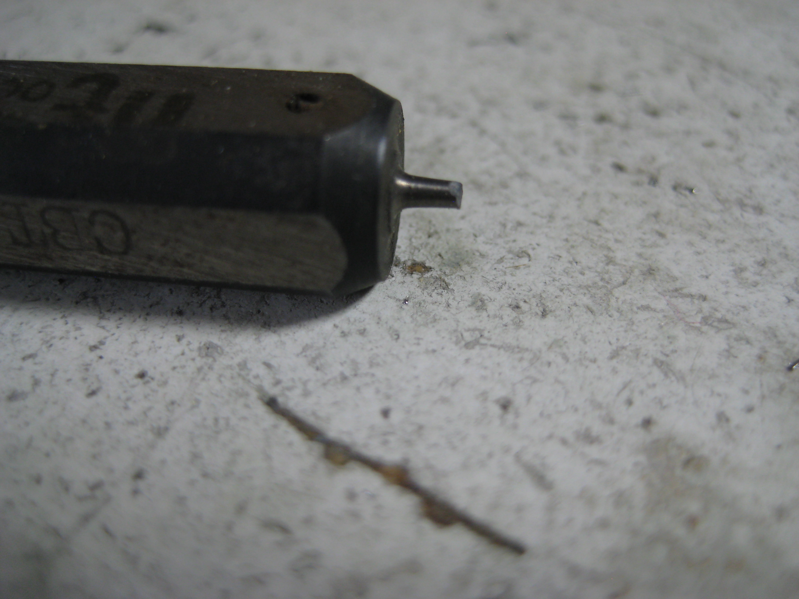

Turns out I had to make some fairly small bushings today (who the hell told Sunset to use 3.5mm axle stock on the lead truck?). I used the .093" (minimum starting ID) but I have some that go smaller. Reamers are fine but I can get more accuracy with a boring bar. Actually, I can screw up more too. Using pin gauges really help, especially when you're getting close.
The first photo shows what happens when you get careless or to aggressive.
