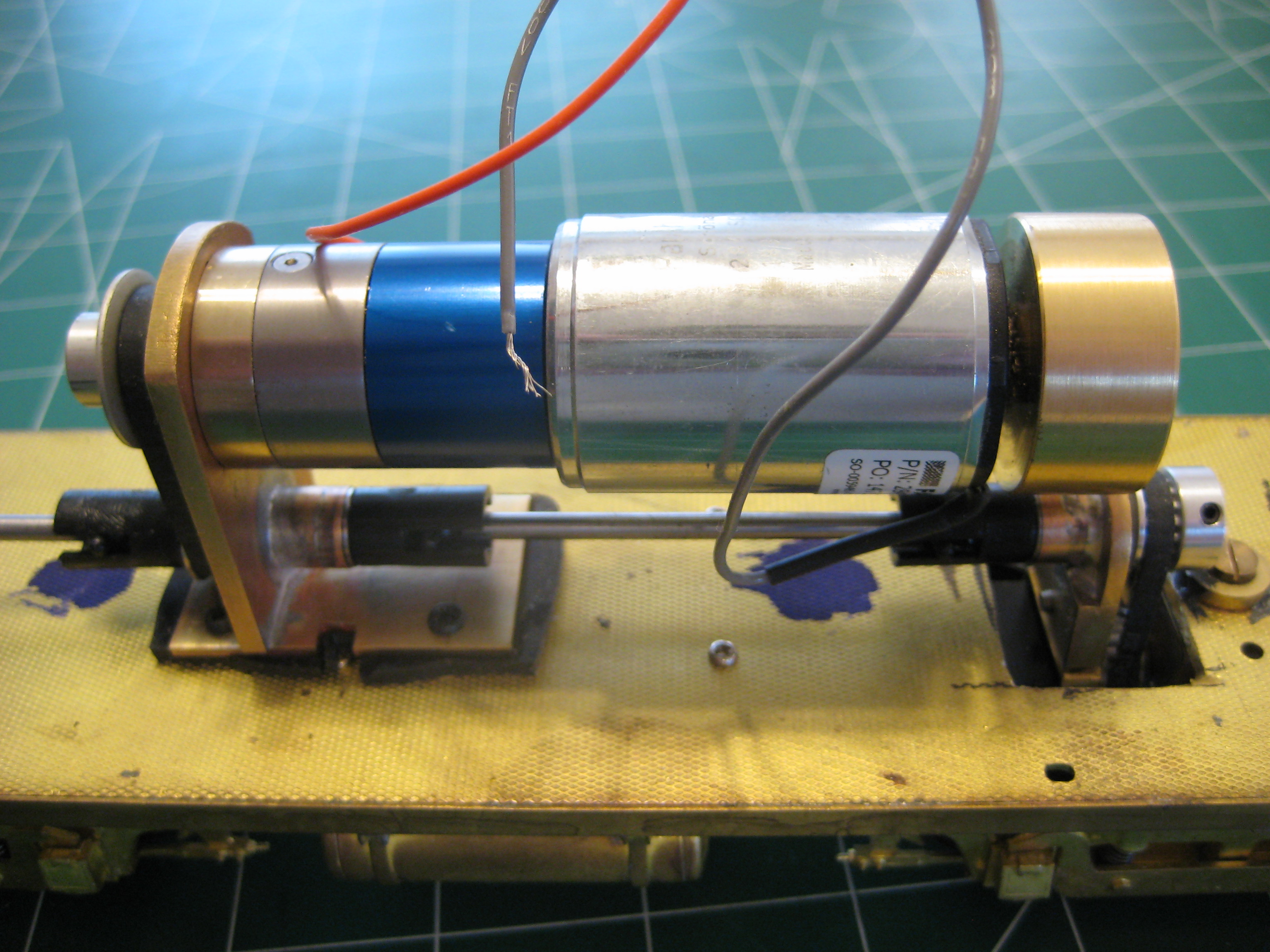

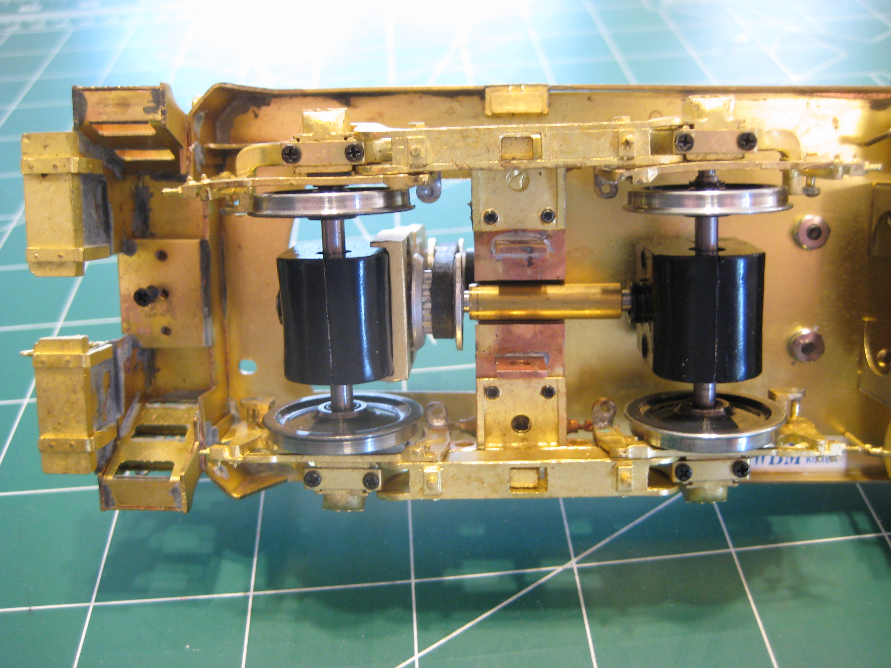

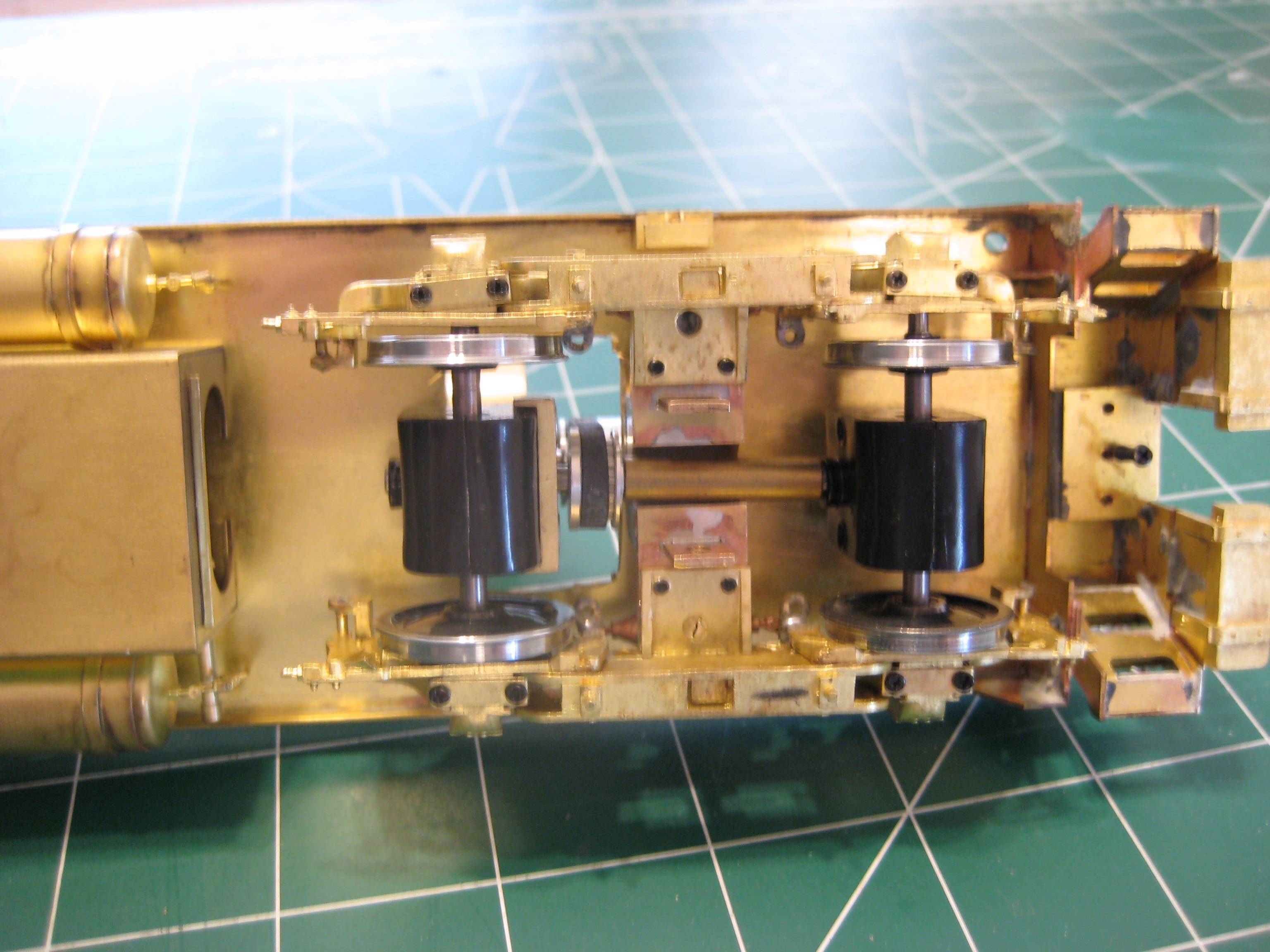

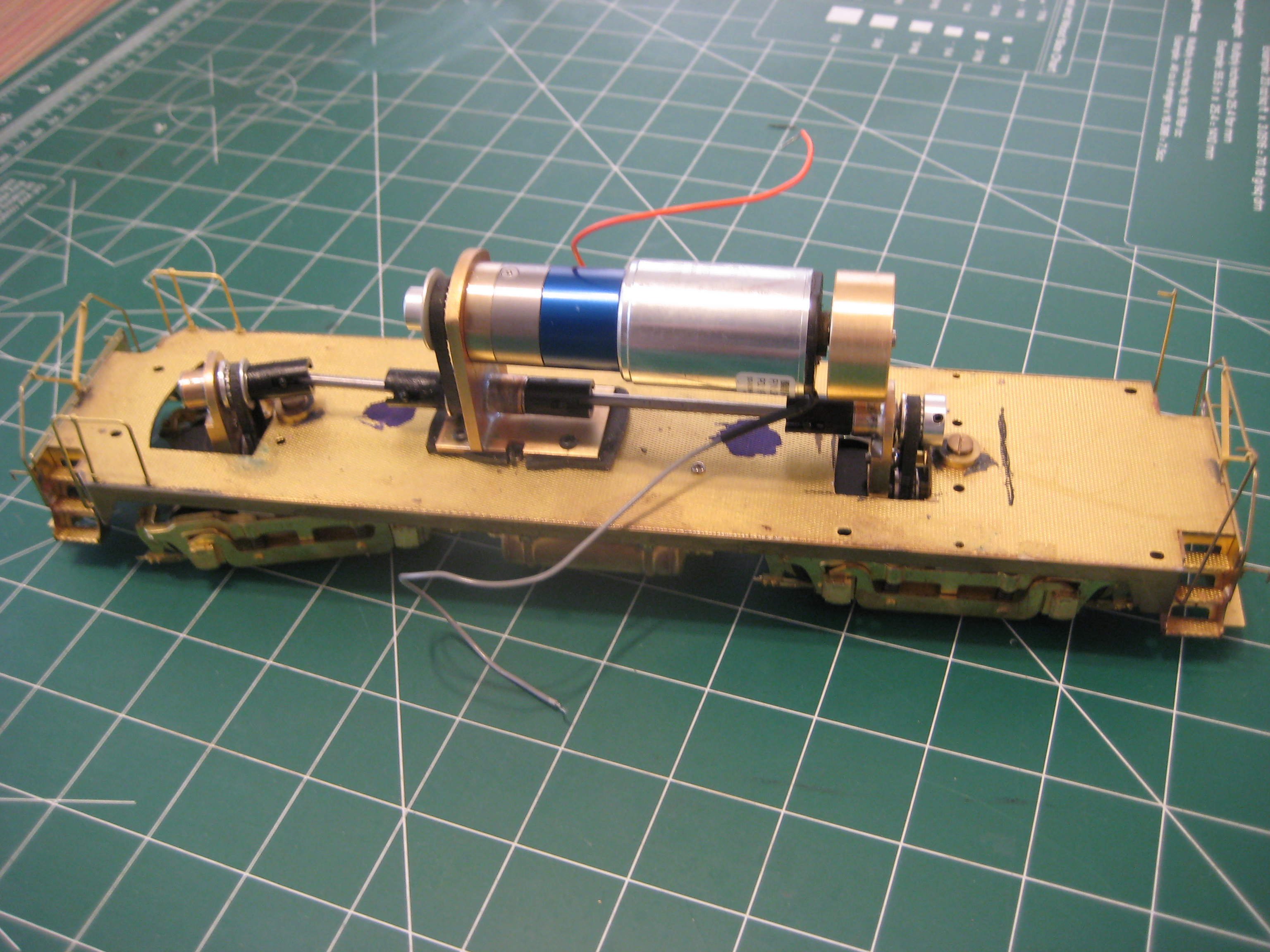

This one has direct lineage to Jerry's drive. Well call it the illegitimate cousin. Another lazy guy copy & paste. No mo' tank drive for this one. Except for some cleanup, this one is ready for wiring, electronics and fine tuning. Oh yeah, Car Works VO-1000. This one is P:48 but it didn't have to be.
