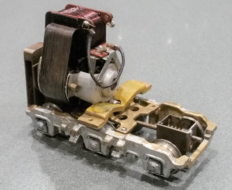

I found the second set of those riveted sheet metal drives:
I forgot that this second set of drives came with trucks. This is all a real mystery to me. Not only do I have two sets of the drives but I have three sets of the trucks, all three of which arrived at different times. The trucks are sprung. Here is a side view:
The style of the motor (heavy wire on the field), the small diameter shafts on the motor and worm shaft, the bakelite (or other plastic) gears in the tower, the minimal detail in the sideframe, and the wire retainer under the journals all say "early Japanese import" to me, but I have no proof of anything. Back view:
The truck bolster reminds me a bit of the LWS truck, but the metal is brass or bronze, not that soft Britannia metal that LWS used.
Anybody out there have a clue? I can't be the only person to have these trucks and drives cross their paths.
