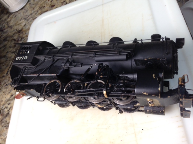

That little Consol looks like a Great Western product. I reworked one of them for a fellow in the Waynesburg PA Model Railroad Club a few years ago and fitted a small Sagami motor in the boiler/cab eliminating the original tender drive. Bill Davis sold me one of these in kit form at the Chicago meet about two years ago. It is on the shelf of future projects. Bill also sold me a Great Western American kit that I passed along to Marty. The Great Western kits are basic steam locos that are well made and with some detailing and care they can be made into nice little locos like the one in the above photo. They are somewhat hard to find though.
