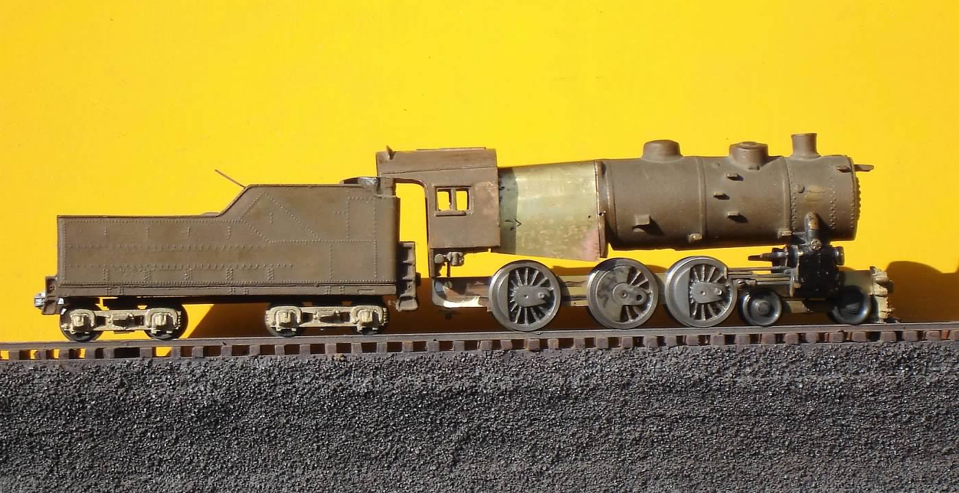

Let me get the Saginaws loaded up - first will be my slowly emerging G5:
Since this photo was taken I have acquired a genuine Saginaw main frame, and got that bolted to the boiler, but for some reason I have made no other progress. One thing I learned from Stu was that crankpin throw is critical - they all have to be the same! I do plug and redrill when I need to.
This one is also in my collection - it has "flaws" which I may leave alone. I promise the one above will be straighter, with better lettering, and valve gear!

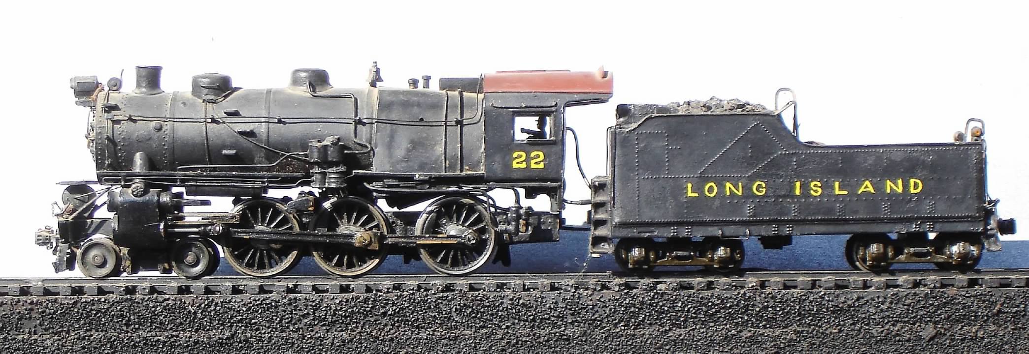

I was going to post a Frank Thomson locomotive, but forgot how I did the jfif to jpeg conversion. It was easy, but you know why they don't give certain ethnic groups more than 30 minutes for lunch. I'll figure it out again next week. Here are the Atlantics:
This is an extended H10 boiler over a modified Saginaw frame, with Lobaugh drivers and scratch tender. Pretty happy with it.
Next we have the genuine article, from the collection of Max Schwanda:
Untouched. Runs great!
