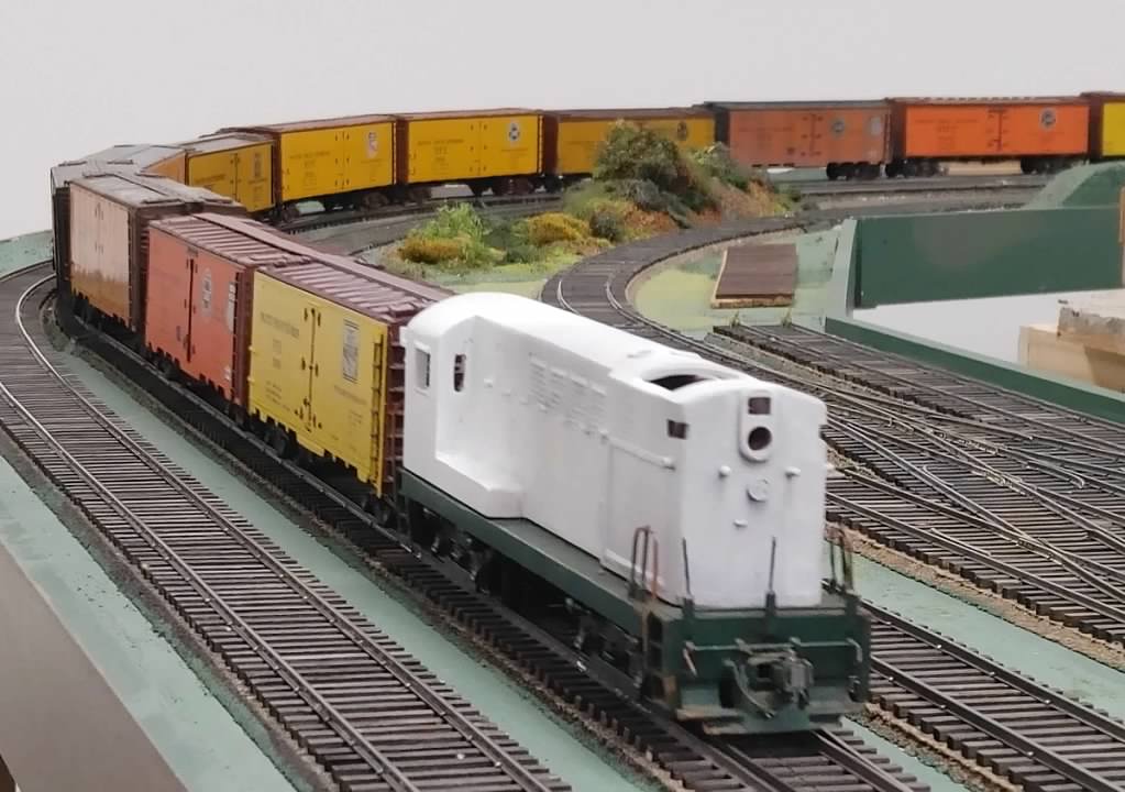

The Baldwin FM H20-44 that Bob modified did not come with trucks or a drive, and I don't have any spares of that particular setup, which features a vertical motor driving one axle through a worm and a metal chain to the second axle:
https://dl.dropbox.com/scl/fi/zkmc9dyuw0gjg1dd45ity/Baldwin-PRR-FM-H20-44-06.JPG?rlkey=kqlok4itu248rp34o81fvt928
https://dl.dropbox.com/scl/fi/b60visdhv3a4no7cs8kqm/Baldwin-PRR-FM-H20-44-04.JPG?rlkey=ynhicozjoap3zc3q2ozu0qon4
I had a set of mystery sideframes (with bolsters) that would work with an All Nation drive setup. Here is the underside before the truck-to-truck driveshaft was installed:
https://dl.dropbox.com/scl/fi/rivy4d9afjeqgdze19ki7/Baldwin-FM-H20-44-Chassis-04.jpg?rlkey=r3xnfozq3f1956giwt2i6wcpf
Notice the unit has a Delrin chain drive tower. I found out later that both sprockets were split. I have the parts and arbor-press setup to change them but, in the interest of time, I simply substituted a geared tower. I added an NOS CLW open-frame motor and driveshafts and gave it a test run:
https://dl.dropbox.com/scl/fi/l1gliyw6fe0x4n3la8xm4/Chassis-Test-Run.jpg?rlkey=h9f0hk04q3b2fqpfx1v481p6a
The motor is all the way to the front, as the hood is bumped out there and the motor didn't fit under the hood otherwise. I wasn't sure the Toyota vacuum hose connection would work, but it seems OK so far. Video later.

Here is a brief video of the customized Baldwin Models FM H20-44 test runs:
https://dl.dropbox.com/scl/fi/zkeoky26krnv73oxthzg4/Modified-Baldwin-FM-H20-44-Test-Runs.mp4?rlkey=cjmstzmru2fvfut2aowy04wjy
If that doesn't work, try this one:
https://www.dropbox.com/scl/fi/zkeoky26krnv73oxthzg4/Modified-Baldwin-FM-H20-44-Test-Runs.mp4?rlkey=cjmstzmru2fvfut2aowy04wjy&dl=0
The model is running without its fuel tank, as the channel through the tank is not wide enough for the driveshaft between the trucks. The tank, which is a solid casting, is on the mill right now. It takes a while to hog-out a bronze casting with a benchtop mill.
