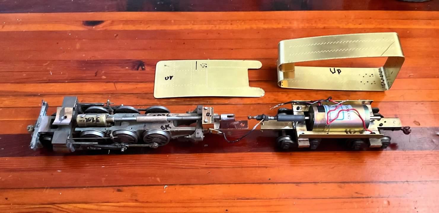

The Lobaugh postwar 0-6-0 was powered by a very short permag open frame motor. It only fits if you know the trick, and if you don't, you will destroy the motor brushes on assembly/disassembly. My solution is "tender drive."
Accordingly, I now have it running smoothly on my test loop - you may actually see a video of it in the near future. But I will provide some still photos as I progress.

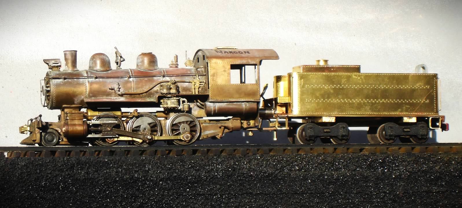

First, here is a re-run of the locomotive as it has existed for the last quarter century:
It will lose the Vanderbilt tender - the new tender will be rectangular to better fit the motor, with Fox trucks. It will get a very few refinements to the boiler, and a quick bead blast with a following coat of rattle can black. I am thinking wood burner, but of course that can easily be changed to coal, or slightly less easily, to oil. And I will need a name for Maroon's lumber company.

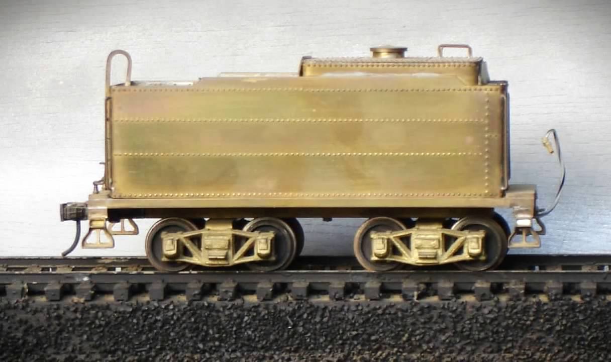

The photo is the last I will do before beginning to marry the boiler and tender superstructure. I think I have flawless operation right now.
I note that this "horny ball" setup is actually better than my usual NWSL setup. Also, and you c@nnot tell from the photo, hooking this thing up is almost as simple as hooking up a standard tender - you just come in at an angle with the tender post, then rotate the ball into the cup.

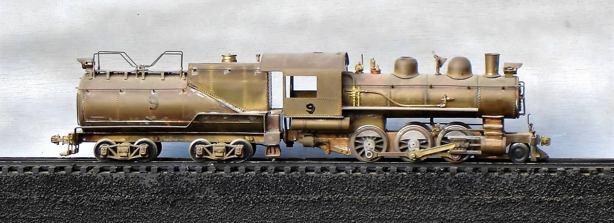

You can see the tender coming along - this is more or less a Lobaugh tender, which would be appropriate I suppose - but the new Mongrel Mogul deserves slightly better:
I might add - those are not Lobaugh arch bars, and the underframe and oil tank are scratch - but the sides came with the original 4-4-0, and are not scarce at all. The 4-4-0 was tender drive, but its cast underframe (the tender) is really not usable with today's can motors.

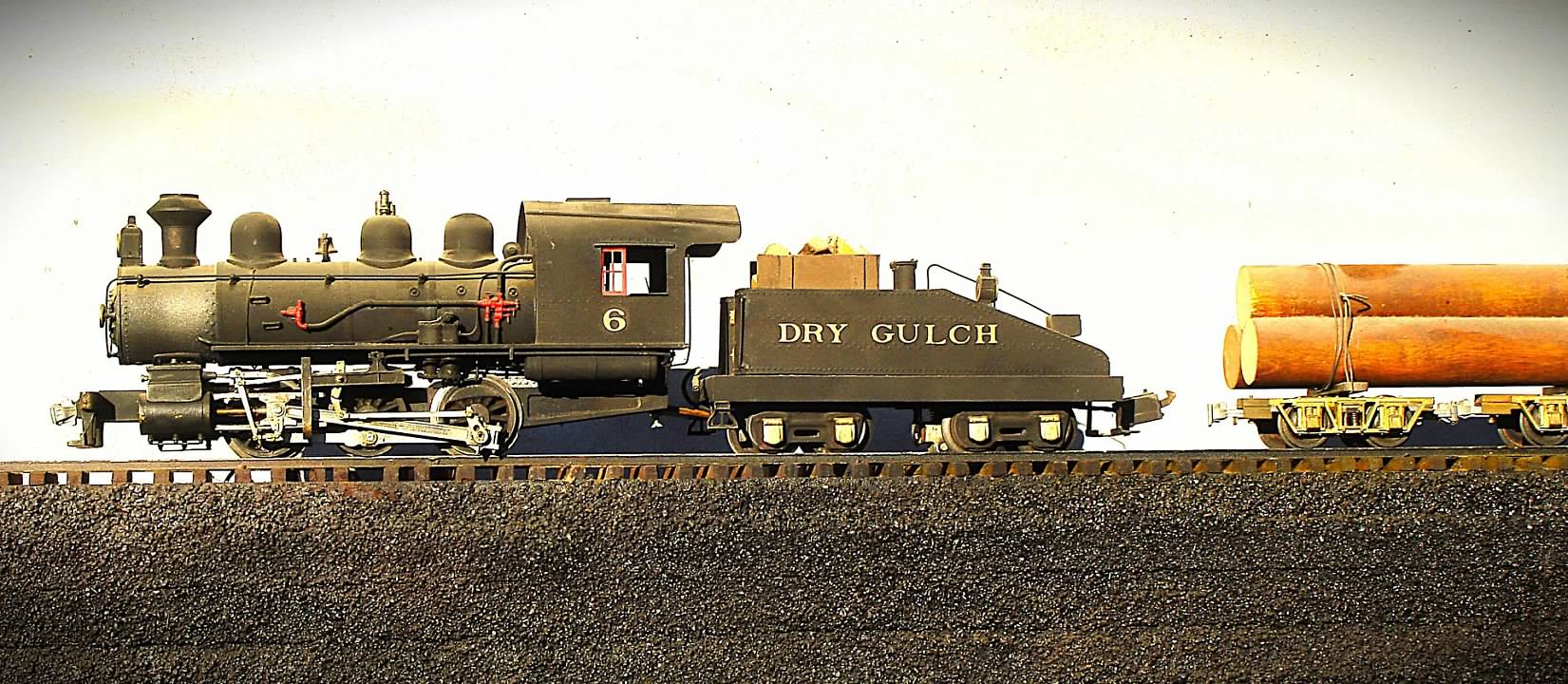

I was going to dazzle you with a photo of my only 3-rail scratchbuilt - Dry Gulch #6 - patterned after an HO version that ran on the Gorre & Daphetid railroad of mid-century fame. The HO version had Fox tender trucks; mine has tinplate Lionel. Alas, I have no digital photos of that. I will rectify that in the distant future. Off to the airport . . .
Posts: 13435
Re: Mongrel Mogul
Postby bob turner » Wed Mar 18, 2026 9:05 pm
Got a couple decent photos of Dry Gulch - here's one:
3-rail, giant flanges, tender trucks from a Lionel train I destroyed during nursery school. I did it for OSR, soon to be re-named OGR, and sent it to Myron Biggar for evaluation. Myron was an ok guy, but he really didn't care for this one - no smoke, no sound, and it did not like his switches (only one roller for center pickup).
I have been tempted to 2-rail it before I croak, but I think I am up to maybe four scratchbuilt 2-rail 0-6-0s, and it is almost as easy to just build another one. The 2-rail version would have Fox tender trucks, of course.

The photo of the tender drive is worth a 1000 words! It is extremely helpful.

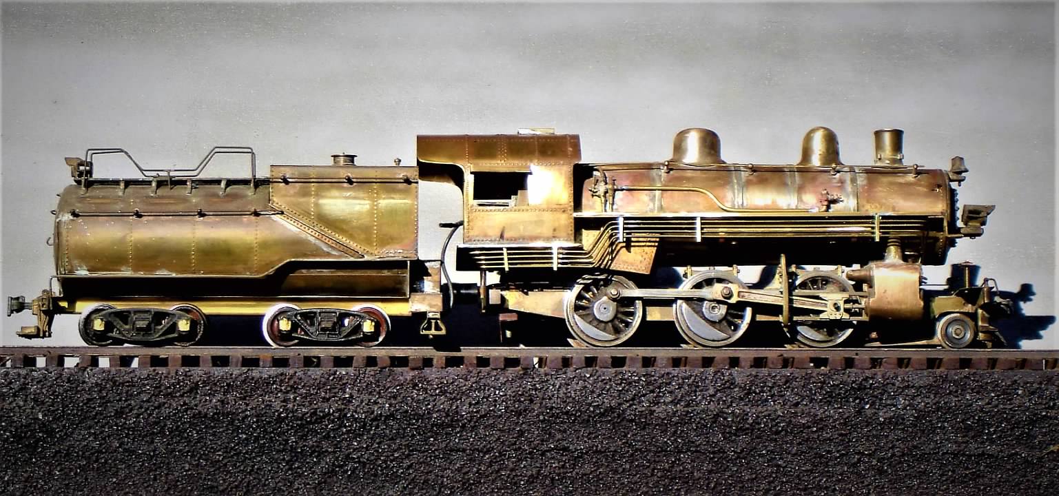

C'est bientot finis
Pardon my spelling - it has been a very long time. Yep - finished - but I now see that I could use some skirts below the car body.
I note that better stirrup steps are available, both from Stevenson and CLW, but I sort of ran out.
I have added to my Fox truck post, but it bears repeating - I found numerous photos of Union Pacific Ten-wheelers, Consolidations, and 4-8-0s with the Fox trucks. Still, we are converting to elliptical spring arch bars.
Here we go - it will get painted and sort of decaled before it leaves here, and I will post a final photo. I note that I had a short circuit on one of the drivers yesterday - not entirely sure it is cured, but as of right now it runs like a little Swiss watch. The pilot and lead truck gave me additional grief, finally resolved by bending the pilot up slightly.

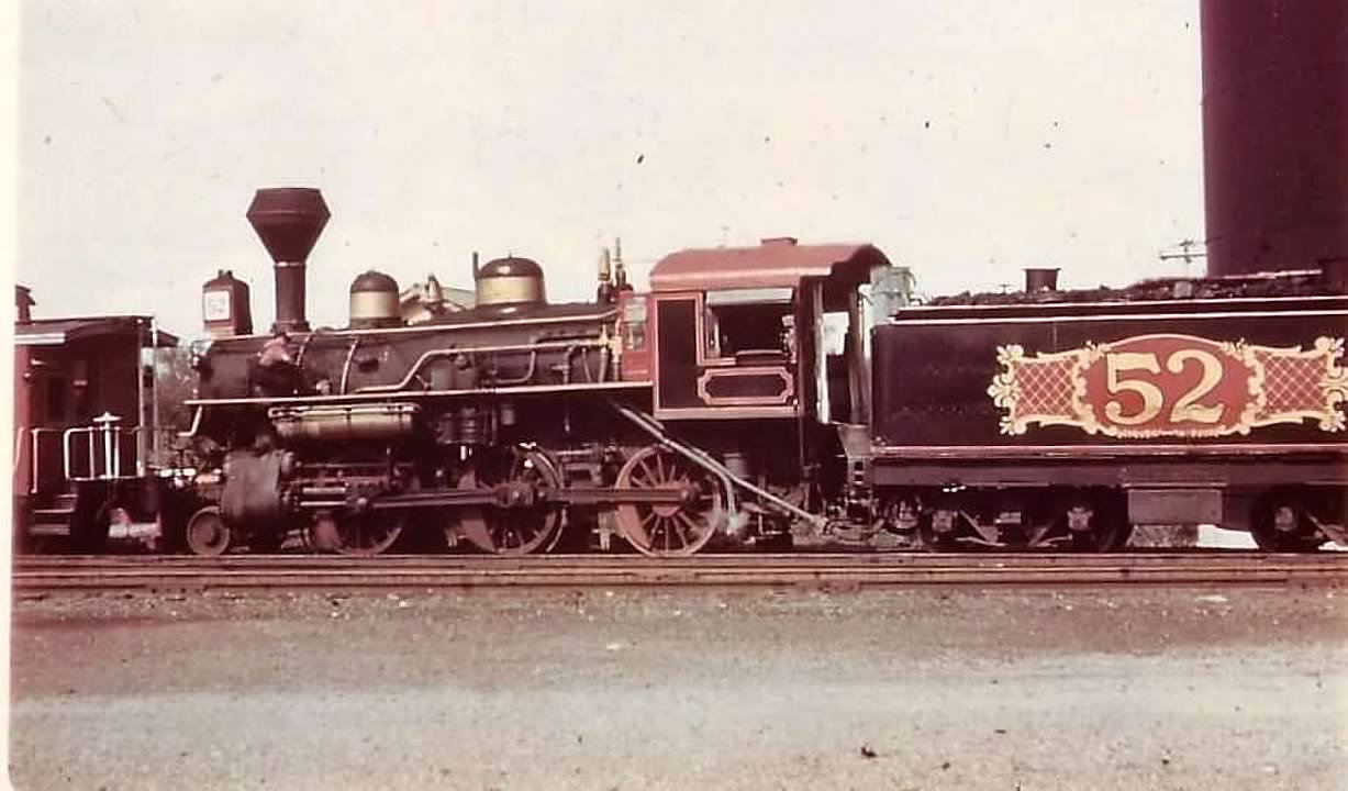

Is this a Mongrel Mogul? I saw this at George Kanary’s layout on the Chicago meet layout tours.
I thought this was a good looking mogul at the Illinois Railway Museum.

No - the above model in your post is a good scratchbuilt, I think. The Lobaugh Mongrel Mogul was merely an SP switcher with a different pilot, cylinders, and one fewer domes.
I don't think it was a good seller - I have only seen one.
