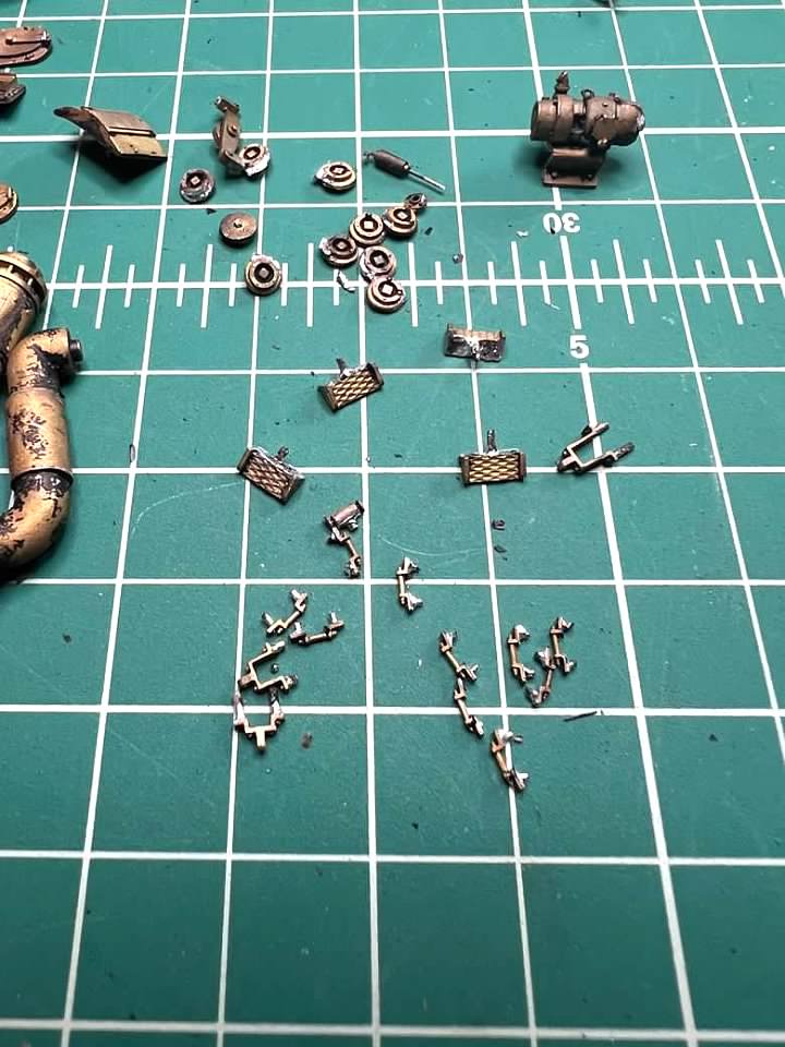

I was just wondering if there is a chemical (safe hopefully) I can soak smaller fragile brass details in for removing solder? Cleaning each piece with a file or iron or ?? will be extremely tedious and time I would prefer to use elsewhere. The photo only shows a small percentage of what needs to be cleaned up before resoldering to another model. Just wondering.

up148 wrote:I was just wondering if there is a chemical (safe hopefully) I can soak smaller fragile brass details in for removing solder? Cleaning each piece with a file or iron or ?? will be extremely tedious and time I would prefer to use elsewhere.
Not that I am aware of that will not also attack the brass.
If not easily done by one of 3 files that I keep handy, I'm using my battery powered Dremel with a small sanding drum or wire cup wheel while holding the part clamped into a hemostat.

First off you have remove as much as possible with a solder sucker, desoldering wick and a Dremel with a steel wire brush.
Then you can use ferric chloride with a brush. You want the ferric chloride used to etch copper PCB boards which is slightly diluted. Ferric chloride also etches copper and brass but at a slower rate so as soon as the solder is gone throw the piece in water. The wire brush will clean off the remaining discoloration.

Pete's suggestion is good, but for a quickie, just use solder wick (looks like a small brass woven ground strap). Then use the residual solder as tin, which will greatly aid in re-soldering. You really want a coating of solder to remain - promotes healthy strong joints.

I would agree if you are going to paint the model, leave the residual solder film. Skip the ferric chloride unless you just want a brass model for display.

Solder Wick. You won't get it ALL, but will be good enough.

I have solder wick and will try it. On the boiler clamps and other really tiny parts I'm not sure the wick would work. But I will give all a try and appreciate the suggestions guys.

One thing to note about solder wick. It comes with and without flux. The type with flux is much easier to use. If you have a type without flux its best to add a few drops of your own to the area in contact with the part.

Thanks Pete, I wondered why I've had such poor results with my solder wick.........actually its almost totally useless, so I just stopped using it. Years ago I bought several rolls in different widths and all gave poor results........I'll try wetting with flux. Thks!

Butch, another technique is to hold the part with a haemostat/forcep/surgical clamp, heat the part with a small torch with the flame kept rather round and yellow rather than the full-bore pointed blue. One the solder melts, rap the haemostat of the edge of the workbench and the excess solder will simply fly off. I do this all the time with brass repairs. What remains is equal to a proper tinning of the part.
Another overlooked tool to add to the arsenal is a solder-sucker.
Good idea. I've seen them advertised in the past but didn't know how well they worked. The "flicking" idea sounds interesting too.
