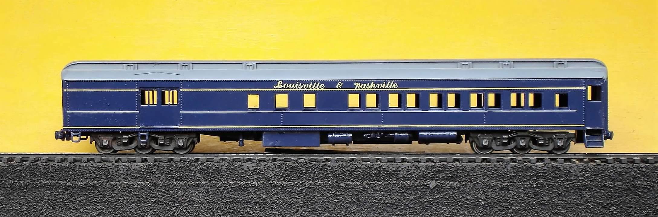

My best stripes were done with those fine line pens you get at the stationery store. I seem to gravitate to cars with Dulux, gold, or silver stripes. I always stripe with white first.
My only experience with good paint has been Scale Coat. Let it dry for a week prior to striping.
Use a straightedge with several layers of masking tape underneath to avoid capilla ry action between stripe paint, body, and straightedge.
Examples are in my passenger car thread.

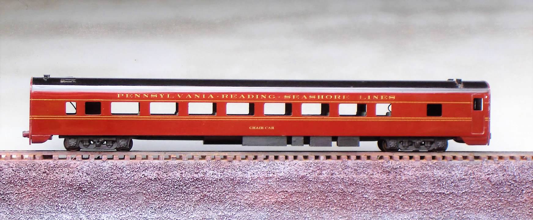

Of that selection I only have PRR to offer. I have striped GN and L&N cars the same way, and a number of doorstop Diesels as well.
Technique (again) is to use those fine line pens and a good straightedge, with a joggle created with masking tape to avoid capillary action under the straightedge. Wait a week after painting, so the pens do not scrape at the finish and get clogged. Then white, followed by your finish color.
PRR - not the complicated two-tone Tuscan scheme, but the same technique would apply. Curves can be done with old credit cards cut to shape.
L&N - Walthers car, Scalecoat:
