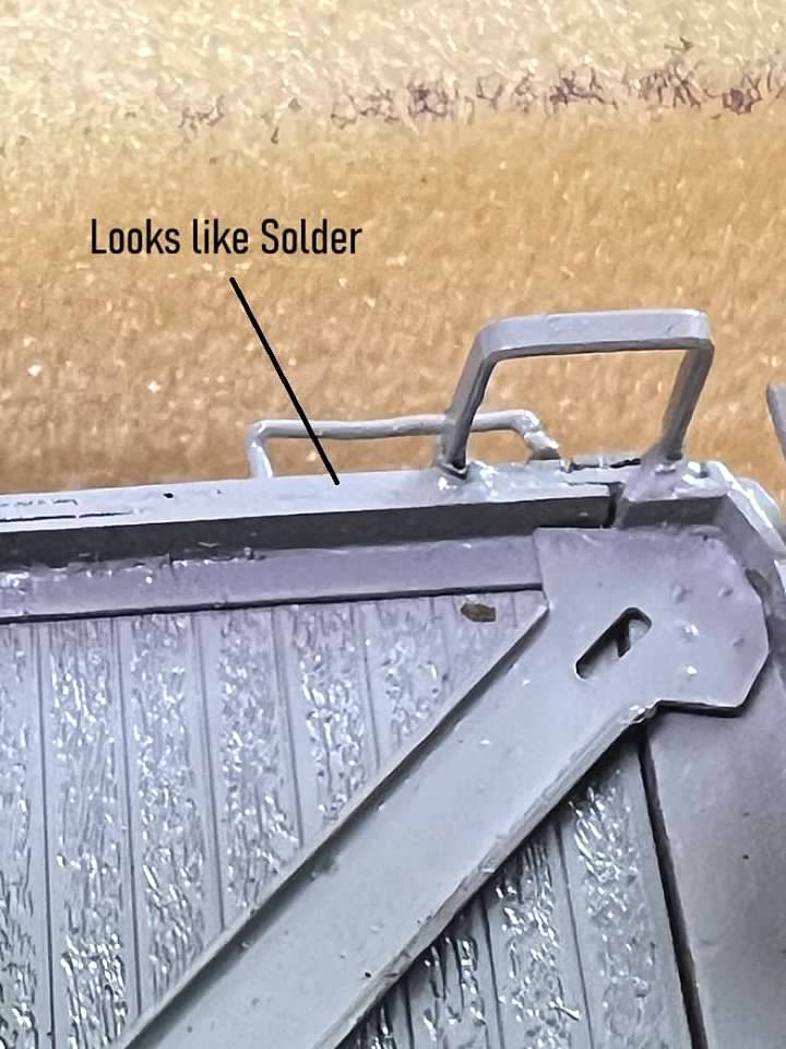

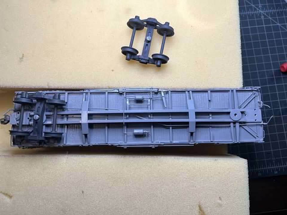

But, what amazes me, is I can find no visible way to take it apart. Every brass model I've owned has had screws allowing you to remove the chassis from the body, but not that I can find with this car. Anyone familiar with PL or seen other brass models that didn't come apart or any thoughts on this?

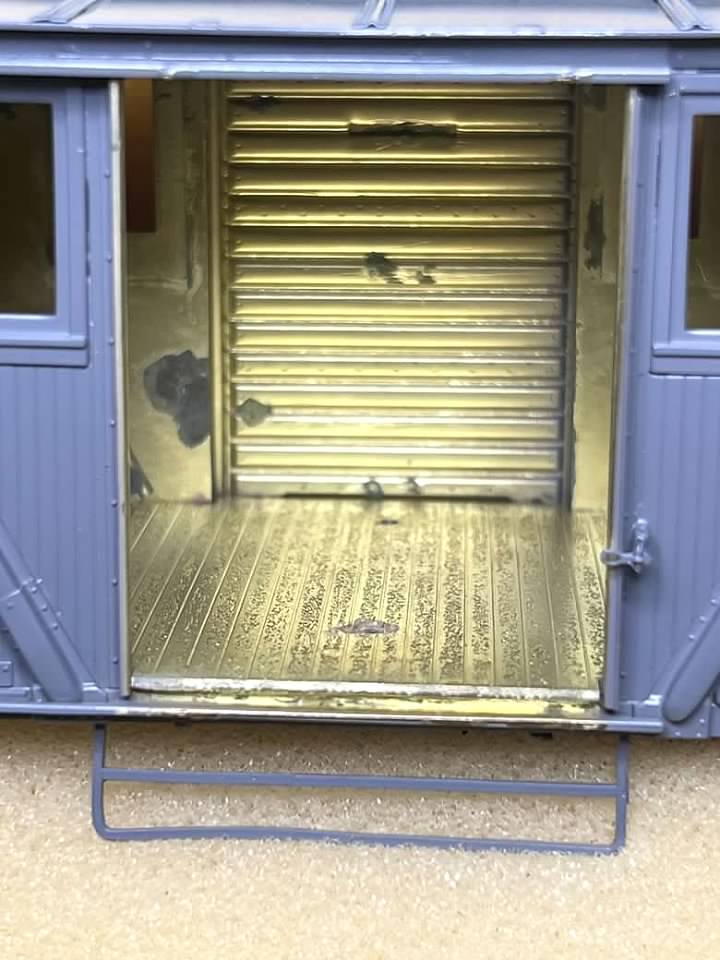

I've never owned many pieces of brass rolling stock......I saved my money for locomotives and cabooses and other items that would not be made in plastic, resin, wood, etc. But a Pacific Limited MOW car became available to me for what I considered a good price and I bought it. I've always liked MOW items and I wanted to resprayed this car UP silver. This car is built by FM Models and I think it might be one of PL's early imports, but actually have no idea where it falls into their import timeline.
Re: Pacific Limited MOW car question
I wish I had it in my hands to be sure, but a couple things. A few of Pat's cars were held by bolster and/or coupler screws. Pull them all, then open the doors and try working the floor loose. I suspect whoever threw that coat of grey on there did so assembled, so the paint has leeched in between the floor and sides, serving as an unwelcome adhesive.
That was sorta what I thought. I tried gently to slide the doors open but they didn't budge, so I'll have to be a little more forceful without doing damage. Since I saw no body/chassis screws I didn't know if the doors were soldered shut. Been converting pantry open shelves to cabinets, but I'll have time to play with it today.

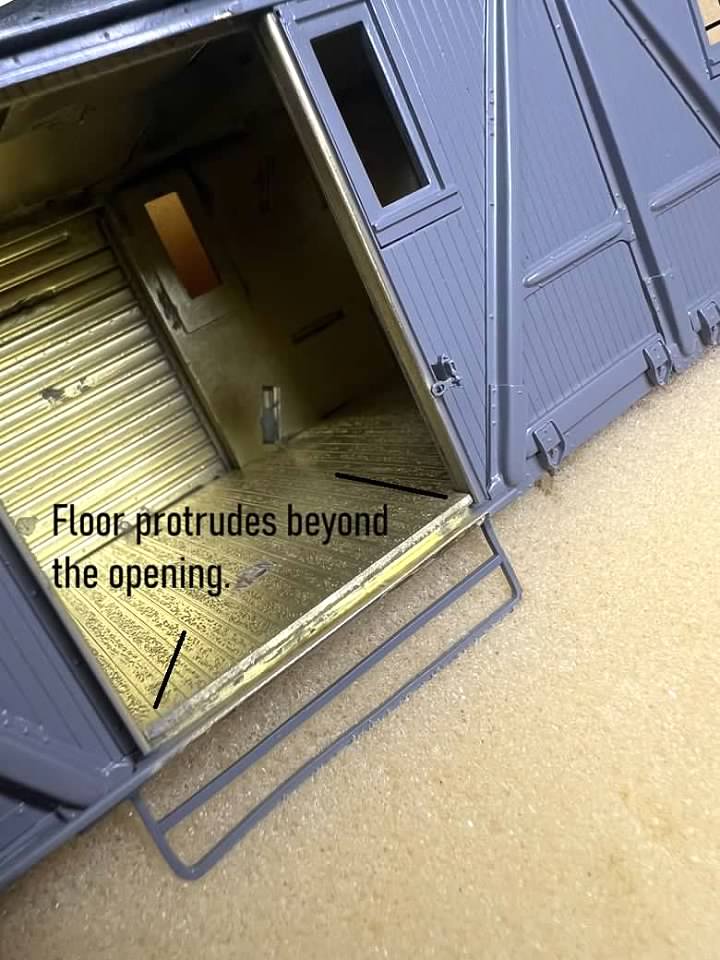

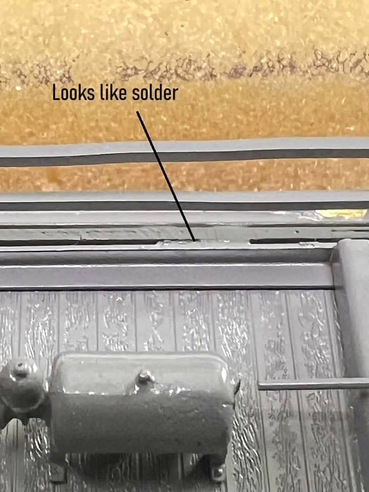

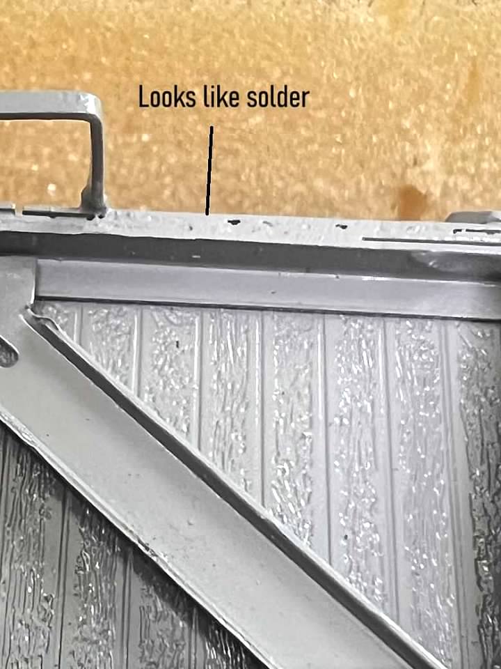

I've pretty much come to the conclusion that this car was not built to be disassembled. I see what looks like solder between sheets of side brass and the floor of the car, which is the same as the underside, sticks out beyond the door openings 1/8". Sure it could be removed, but at what cost.
The doors might also slide, but due to the scale size of brackets and rollers that hold it in place, the door would have to be put in position (open, closed, partial) and secured for handling and operation, as the top just falls away..............but these are some of the most accurate scale size details I've ever seen.
The car might be factory painted and was obviously done with the door in place and hasn't been off since. Window glazing would have to be attached from the outside (doable) but adding an interior would require major disassembly and the project might become an exploded box of parts.
All soldered is a foolish thing to have done but so be it.
I'd remove the other door, too. Paint it and the doors, then glaze through the door openings, interior stuff too if you want it.
I assume the roof is soldered, too?
Yeah, it looks like totally soldered together. I may reach out to a fellow I communicated with years ago who seems to be somewhat of a PL guru.

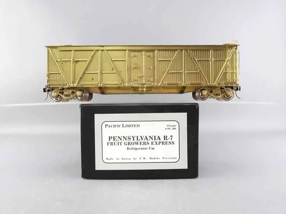

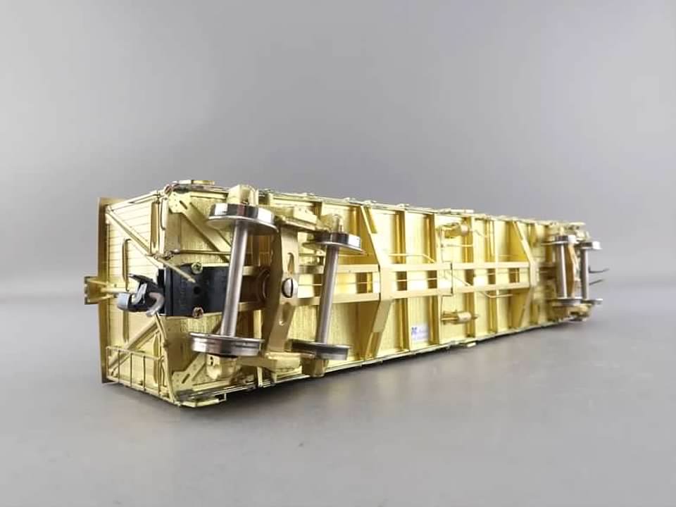

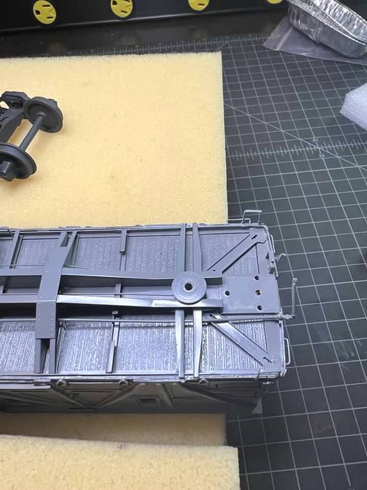

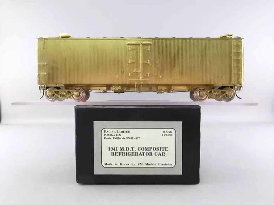

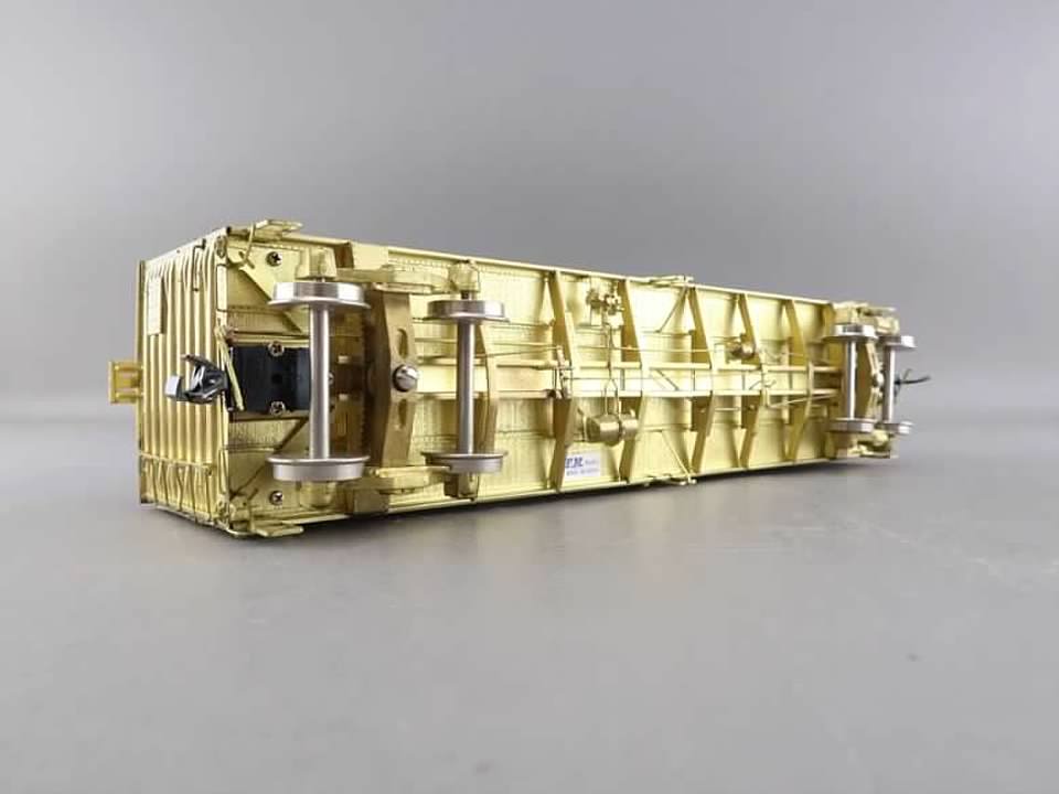

Don't mean to go OCD, but this has bugged me so I had to know. Apparently PL has used several builders over the years, but it seems the project dictated whether the model was screwed together or soldered. I say that because these photo show two different models on BT website represented to be imported in 1990, both by the same builder and one soldered and one screwed. So, I'm done. I'll leave this be.
Same builder, Butch.
That PRR series came first (X23, R7, &c). The MDT car came afterwards. I suspect the lesson was learnt after the PRR series; make the floor removeable.
Your photos are out of order in that the MDT car is #1 and #4, while the R7 is #2 and #3, making it look like the MDT car has no screws whilst the R7 does at casual glance.
I'd not really believe BT regarding timeline on this one.

sarge wrote:Your photos are out of order in that the MDT car is #1 and #4, while the R7 is #2 and #3, making it look like the MDT car has no screws whilst the R7 does at casual glance.
That explains things....
Solitude is only a good idea if you have the right people along to share it.
