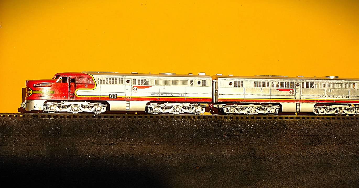

I just realized that I have no shots of the metal MTH ATSF PA set, since I gave up on the nickel silver polishing and painted it with rattle can silver. Here it is - it looks better in real life than this shot might indicate. It took a lot of editing just to get the detail of the silver parts to pop.
I should again mention that the trucks under the PA are from my master - and the ones under the PB are those really good CLW trucks. Not bad for an amateur, huh? They too are nickel silver, but now painted with rattle can. Yes, the PA is powered on all six axles.

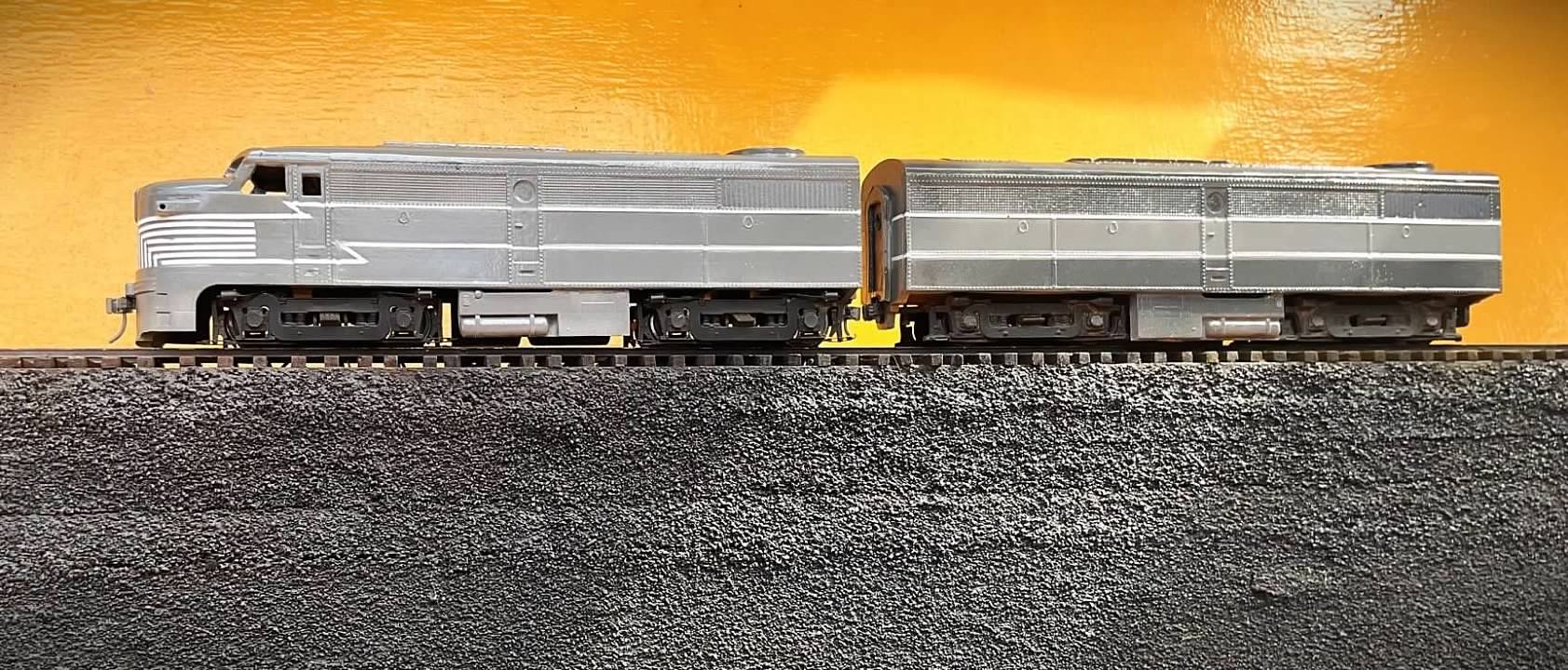

Carey's You tube of the NYC FA/B set got me on fire. I took one of my B&O FAs and an unpainted FB, and tried to duplicate the paint on Carey's models.
So far so good - I used the five whiskers of Carey's models, instead of the standard three in all NYC Lightning Stripe paint jobs - nothing around here is totally prototypical. I need some more dark grey before a photo shoot, but rest assured, at least iPad quality photos are coming.
The big Dell computer just suddenly stopped accepting the digital camera, so quality may suffer while I explore other options.
I did take the two remaining B&O units and sharpened up the stripes a bit - and converted most of the white to light grey. Those will take some more work, but photos will be forthcoming from them as well.
Posts: 13437
Re: Alco PA and FA 2023
Postby bob turner » Tue Oct 21, 2025 3:03 pm
iPad photo - still learning. I sort of copied Maroon's tripod mount, so I got the shakes to a minimum.
Again, this is copying Carey's FAs, and not the prototype. I can always re-do it if I want. I need the darker gray on the A unit, and some touchup on both, and then maybe, if I remain happy with it, some decals. Not powered, will probably never get glazing or handrails until it goes elsewhere.
Darker grey is difficult to get for some reason. The darker areas on the B are Tempo Lycoming Engine Enamel, currently $23/can, but out of stock.
Yes, the Paasche Model H still works. Getting really lazy, though.
