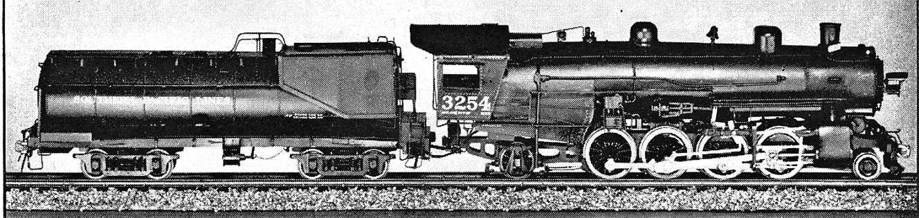

bob turner wrote:1937 - probably done by Gerry White:
With apologies if anyone still owns the copyright - original holder has departed the earth more than 70 years ago.
Nicest Loco in this thread by a long stretch!
Here's a photo taken from the 1941 catalog:
Lobaugh Mike.jpg (1.52 MiB) Viewed 10998 times
Price has gone up: from $138.00 (1939) to $151.50... :)

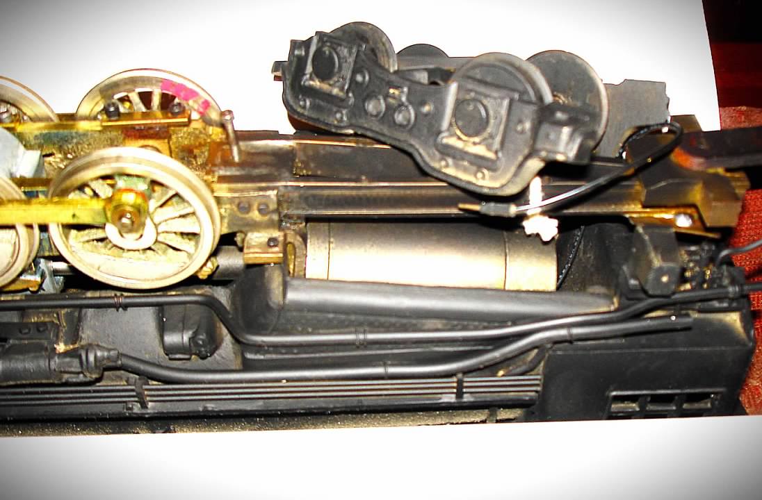

bob turner wrote:This is another non-Lobaugh. Its lineage is known to others, but the best I can figure it is an effort by Bob Smith with the help of Adams foundry. It is truly a doorstop; the boiler is one giant heavy chunk of brass. The cab takes some serious adjustment to fit correctly. Sure, I will paint the drivers someday, and decal the thing, right after I make a correct tender for it. It does run!
The current tender is a bronze version of the tender that came with the A-N Mountain. My understanding is that it was the tender supplied with this big Berk, but it is too short by almost an inch! Parked for now while I think of my next project.
Ahh So that's what this thing is!
I've been wondering is the chassis I have under it is the correct one, and I sure think it is based on your model Bob!
Thanks for the id!

Yes. Good cast-on spring rigging and no tail beam. The trailing truck was the tail beam. Did not work well in reverse; the entire train was trying to buckle the lightweight (comparatively) trailing truck. I am not sure the real C&O Berk did not have a tail beam; it seemed restricted to those Berks with the rather long trailing truck - the Lima B&M locomotives that got scattered among the SP and ATSF.

My advice on that C&O? Add a tail beam, find the correct C&O trailing truck (I think Stevenson has it) and the boiler front. Make a new tender (the CLW one was too short) and hit it with satin black rattle can. Oh, and skinny up the side rods and invert them. Not that many of these out there.

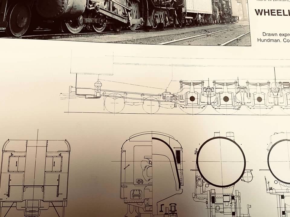

A bit more research - I have a good library including some drawings etc. I still need to check Hundman's excellent and usually accurate drawings.
The Van Swearingen Berkshires did not have a separate framed trailing truck with drawbar. Instead they had a conventional tail beam. For some reason Adams and/or Smith thought these were like the Lima Berks, with tender drawbar attached to the trailing truck, and no tailbeam. I guess the cab depended on boiler structure for its support, although there were rollers of some sort transferring weight to the trailing truck.
The cure, of course, is a tailbeam. You really don't need a Bridgeport to do that, although I have been machining "I" beam sides - mostly because I can, and not because the real thing had an "I" beam shape.
Do capture the correct trailing truck. Lead truck can be Lobaugh - or almost anything with outside bearings. I think these are roller bearing outside journals, but not sure.
So: I will get you a photo of my frame soon - maybe this evening. Your cab is in the right spot, unlike many of these casting sets, so you are ahead of the game.

Well, it turns out that the Swearingen Berk has an "I" beam tailbeam. I am going to reproduce a very small part of one of the Hundman Cyclopediae drawings, under the "educational purposes" exception. I am sure Bob would authorize the repro, because he has done so for me in the past.
But no need - this is strictly for educational purposes:
The CLW frame extends far enough back to allow bolting and soldering the extension without interfering with the rear drivers.
So here is a one-time offer - send me your stripped frame and a call tag to ship it back, and I will machine and solder the tailbeam for you.

Here is my frame extension. Note the trailing truck - that is the exact one you are looking for. Also it is the exact one that should be on the Lobaugh Greenbrier - not the strange one in the kit.

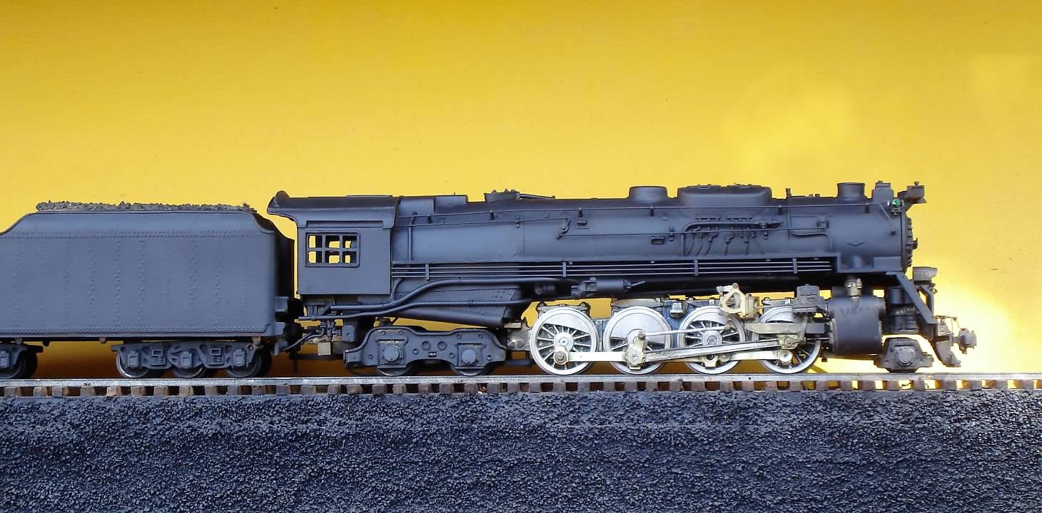

There are days when I consider an Erie Berk. Those things were huge! The one I like has giant holes in its disc drivers, a Lima trailing truck, and a huge straight-sided tender, for which I will probably have to make truck sideframes. I do have the mechanism partially complete with USH drivers.
Posts: 13573
Re: Lobaugh Berk 2023
Postby bob turner » Thu Jul 23, 2026 2:08 pm
Here it is a year and a half later, and my Erie Berk is extremely close to finished. My Lobaugh Berk collection includes at least two that are in almost kit shape. Here is one I would leap on if I didn't already have more than my share:
