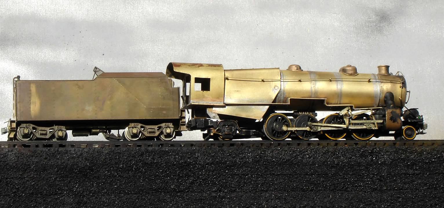

Here is the PRR L1. Carey can fill you in on its lineage, but I got the job of sticking the boiler back together. It was thin wall brass, held together by boiler bands (as was the CNW that follows).
I first made a new conical section - less faithful to the original builder who, like USH, followed the multiple course boiler drawing in the MMR Cyclopedia, and more faithful to PRR, who used a single conical section on L1, K4, and I1 boilers.
Carey did not ask for mechanism work, but I could not let it leave here without making it operable. It was originally 2-rail, with hub-insulated drivers and plastic bushed rods on the insulated side. I assume that meant a plastic Walshaerts link, but it was long gone. I converted it to outside third, by adding a metal bushing and valve gear to the insulated side. It can easily be converted back, since the metal bushing is just resting there.

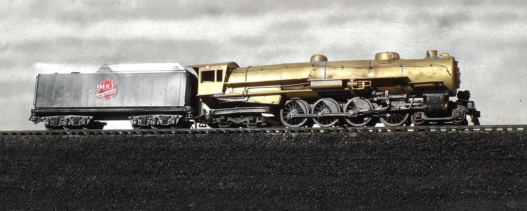

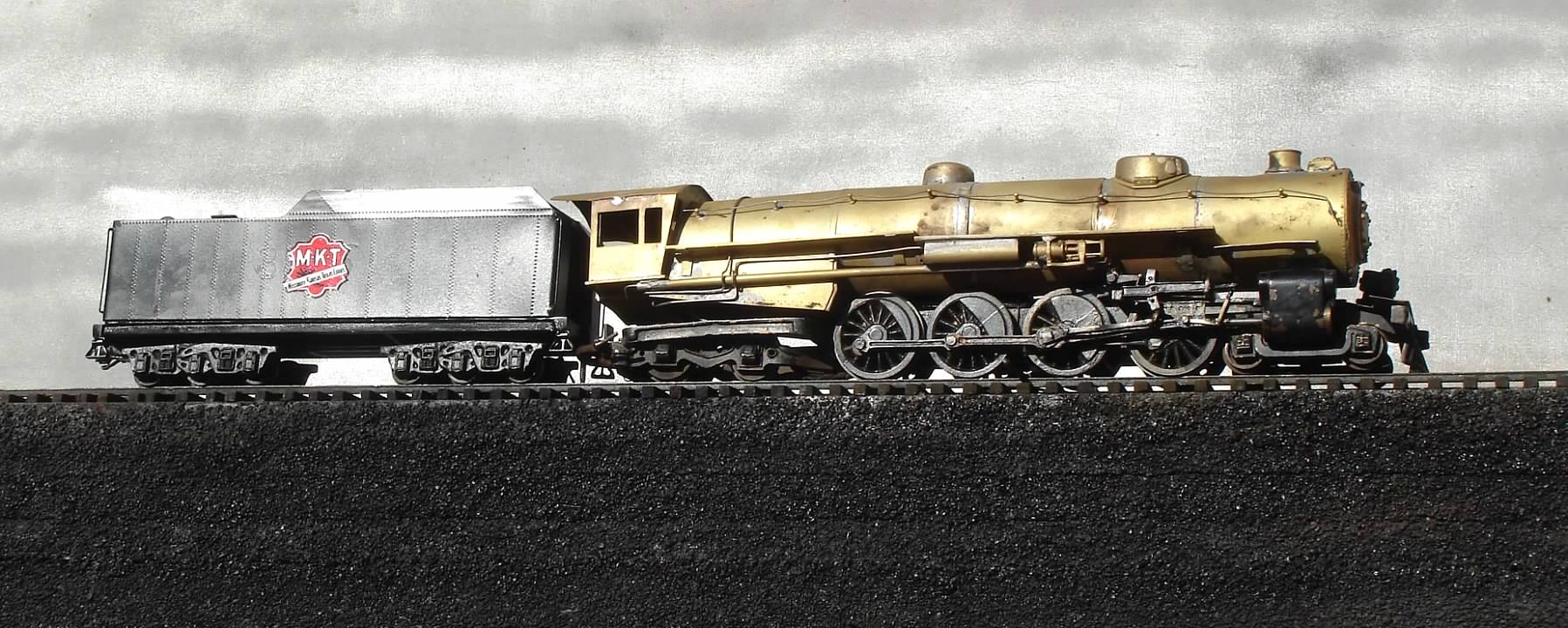

Postby bob turner » Sun Sep 28, 2025 1:55 pm
This one got a couple boiler bands re-soldered, a pushed-in area returned to almost round, and not much else - it was (and is) really flimsy. But the mechanism is a work of art - outside third from the get-go, but castings you will find nowhere else in O Scale. Check out the trailing truck and firebox support.
In the photo the firebox support is bent down around the trailing truck. I fixed that later, to discover that it had been purposely bent so the motor would be angled up, eliminating the contact between spring loaded coupling and the frame. Solved that with the Toyota hose fix.
Some of the details are exquisite - the Walschaerts links are fabricated, and the radius rods move up and down with the reversing switch. Nicely done.
I don't think the CNW H Northern has ever been done in O Scale, except for this one. If it were mine, I would jack up the entire boiler and re-do it with brass tube of .032 or better wall thickness. It won't be mine, though, ever - because my project list does not include more CNW. I may do an Erie Berk with those giant hole drivers, and maybe - maybe - a C&O F-17, but no more CNW.
Oh- that tender is in fact CNW, but Callie made me some Katy shields. It goes behind my A-N Pacific, which you can see in another thread here somewhere.

Those look great to me! Need some paint now! :mrgreen: :mrgreen: :mrgreen: :mrgreen:
The cylinders on the L1 look sort of Scale Craft-ish from a distance...
