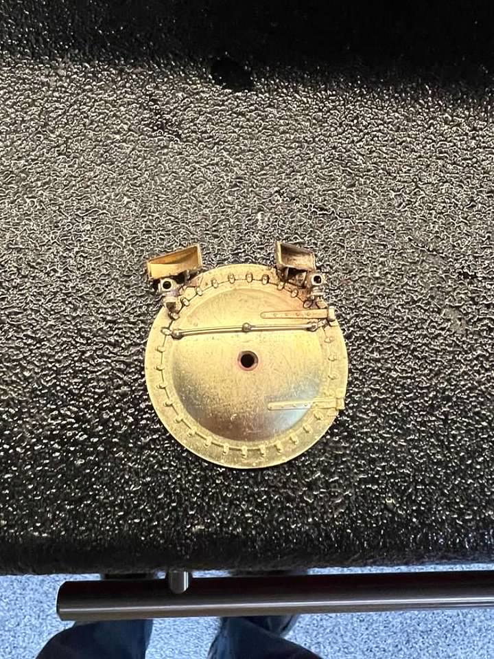

Cleaning up old solder burn

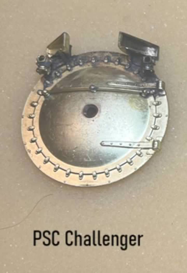

Sorry for the poor clarity of the photo, but I increase the pixels and should have just taken a new photo......you can see the area I'm asking about. Came to me this way, but looks to be burned or ?????. Since the black coloration is in a very tight area is there a product I can apply with a paint brush to remove this and return it to natural brass?

If indeed that's bare brass, the best way I know abrasively is a thumb-full of 000 wire wool and a matchstick or Simichrome on a cotton bud. Simichrome and a toothbrush is worth a go. Wash it well before painting.
If you happen to have an ultrasonic cleaner, then some of the commercial cleaning solutions might do it best. My go-to is a 50/50 cut of white vinegar and water for 20 minutes or so at something like 120 degrees F, rinse, repeat as needed, then water and one pinch of baking soda per litre for 10-15 minutes to neutralise the vinegar, rinse again.

Got the same vinegar tip from Bob and Sarge. Today I had a chance to try it. Worked like a charm.
Wife had some 45% vinegar for cleaning that was too strong and gave it to me for the garage some time back. I decided to use it straight and it only took a few minutes. Instead of soaking (due to strength) I just used and old toothbrush and scrubbed it with the vinegar.
This needs to be done in a well ventilated area and take precautions as it will burn your skin. And you have to wash and neutralize the vinegar.
This is only 90% done as I need to find a smaller brush to get in the minute corners...........but well worth the effort.
