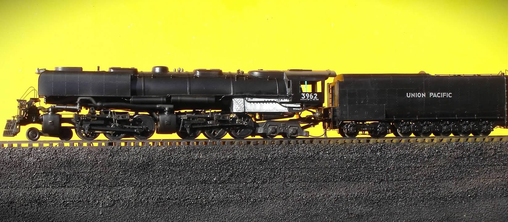

Gersh Thompson's new Challenger - features an import tender, and an attempt at boiler bands. The Elephant Ears were cut down from some FEF ears, and they look pretty good! Runs like a watch.
Long-time O Scalers out west know Gersh, and his buddy Howard, from the long string of OSW shows, where the two of them were a fixture. Always a bargain to be had at their table, and Gersh always had a hospitality suite with wine and hors d'oeuvres (sp?).

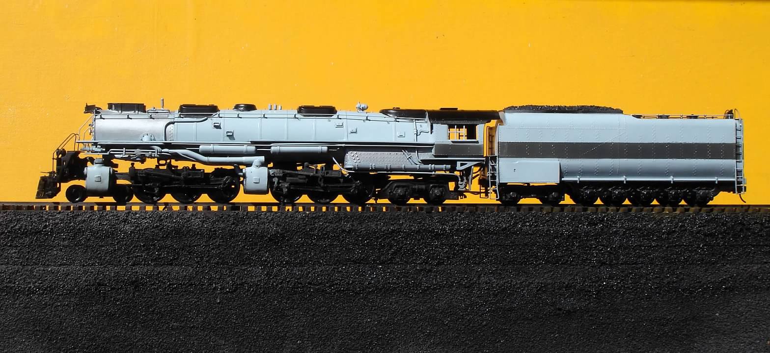

Here is one of them - getting ready for decals.
Surprise - Microscale only prints one set of 0-9 for each side of the cab - so it cannot be 3977. Unless somebody has donor sevens in their leftover pile of black outline Microscale. This one, then, will be 3974.
While I am at it, ScaleCraft Dave is interested in Wes' question re: Acme. For me, it is just like Billy Davis, who uses NO RESERVE to delineate his eBay offerings - or those guys who use VTG (I had a difficult time deciphering that one - "very tasty & good?") - it is just another way of labeling stuff.
Wish me luck on the decals - that happens this weekend.

Nope - only one Greyhound will grace my rails. This is an easy "complicated: scheme - you should see what I do for Daylight steamers - very thin black outlines on all the silver stripes, done with a ruling pen and water-based paint.
I think the most difficult was the ACL GP7. Most satisfying was the C of GA E7 - thank you for the decals for both.
What is going on around here is refurbishment -pulling dusty models out of the hangars, bead-blasting, painting, decaling, and lubricating. They get test-run if they are powered.
This one is strange - the parts appear to be genuine Lobaugh, but the driver tread is non-standard, a lot of the detail parts on the mechanisms and pilot deck are "different," and the boiler itself is scratchbuilt here in my shop. Just returned to the airport today, after this photo was taken:
Oh - and some pipes need touch-up, and the trailing truck needs replacing. Next time.

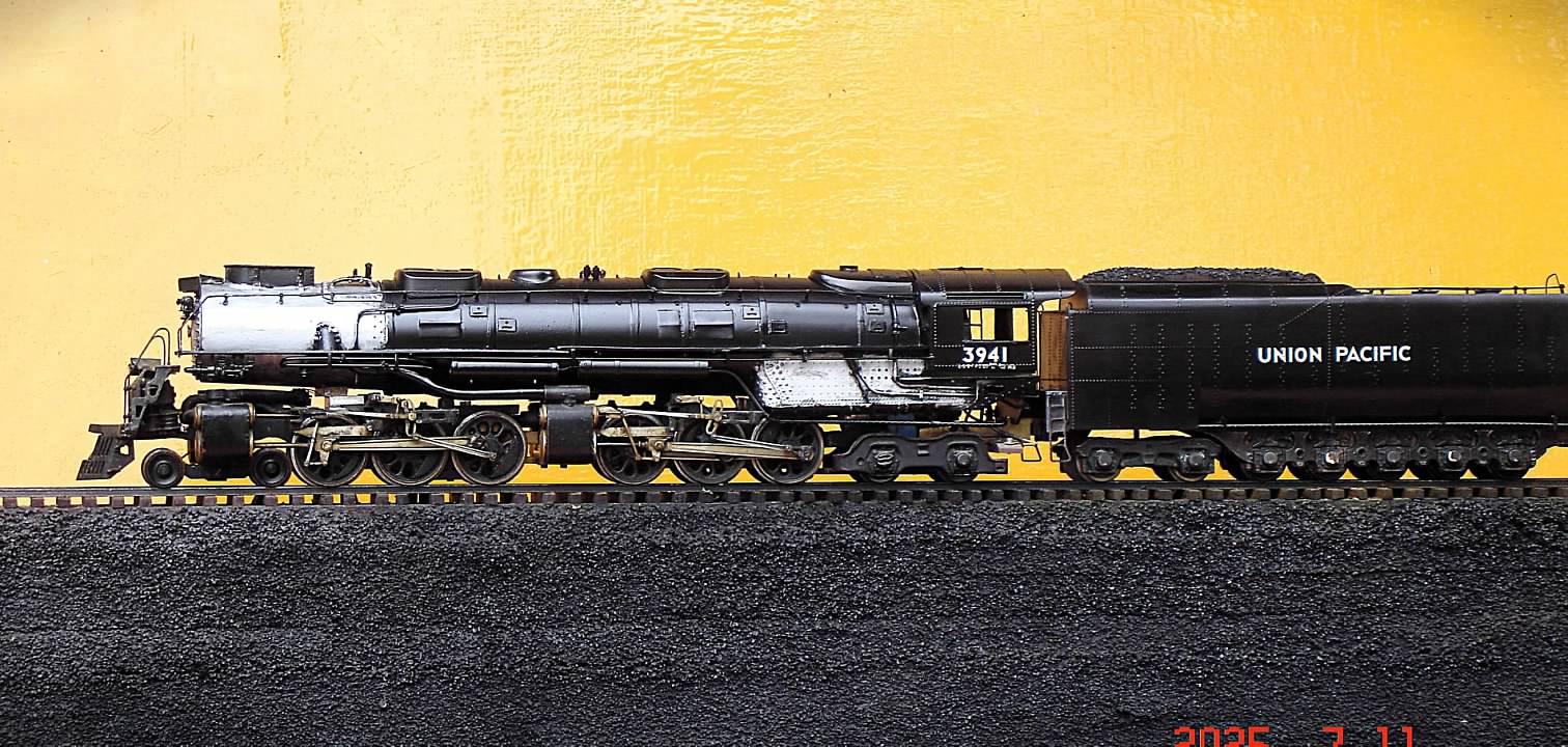

You kinda have to add your own rivet detail in a lot of places. Firebox and Cab on this one were pressed here while watching the News Hour, and the tender on the Greyhound above was likewise pressed here. No Lobaugh models except the lost wax switcher and Mike had cab rivets, and firebox rivets were limited to a few impressions along the mud ring and throat sheet.
On the yellow numbers - turns out that the Microscale black outline letters and numbers are meaningless on the dark stripe. I am now actually happier with 3974, since every other Greyhound Challenger model in the world is of 3977.
One side of the tender is done - thinking of doing the other side before I head to the airport. Party tonight, so no train work in the evening. Photo soon!
Update - noon - all major decals are on! Need only Microsolve and Future Floor Wax. Looks ok.
Note to Dave - I really like square counterweight drivers, but if I ever do a furrin locomotive it will be a Chinese QJ.

Here we go - I think it turned out quite well! It has no prototype, since the Greyhounds were 3975 and above, and all, apparently, had elephant ears.
I am now happy with this thing, even though it still needs silver on the rods and cylinder/valve covers, and maybe some black on the handrails.
It will also get brass color on the pops and bell, and a new trailing truck as soon as I spot my huge supply of castings.
Oh - I forgot to re-solder the tender ladder. That gets done this evening. Things do break when you move them around.
It goes back to the airport tomorrow, on display again. Next project is a doorstop for Maroon, which we will cover here.
All rivets are from my shop. Cab is all new brass. Tender is brass overlay over a wood block. Still, mostly Lobaugh.
