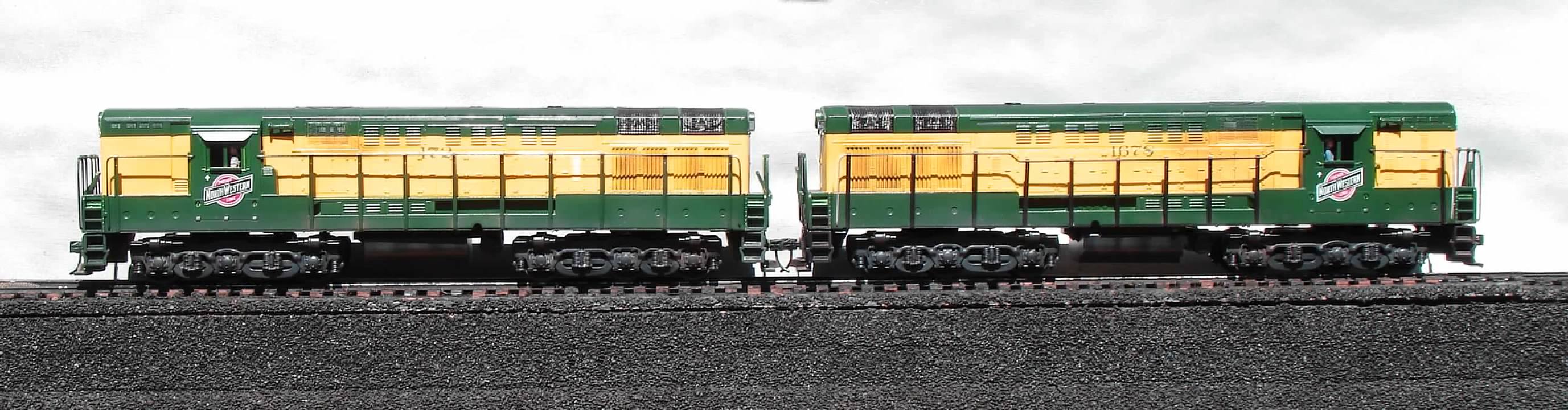

These are plastic - done for Jim Seacrest a while back. Nowhere near as nice as C&LS, and original K-Line six wheel drive (NWSL conversions), but at a distance they capture the "feel." At a hundred bucks a pop, they were difficult to pass up.
