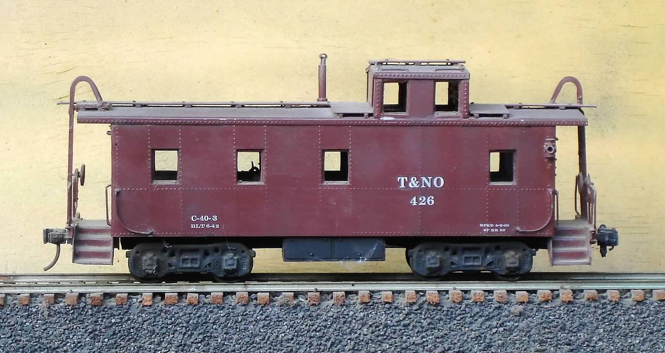

My brother-in-law used to make models for the Smithsonian. He recommended the Paasche Model H. I bought one and have never been sorry!
It is single-acting, simple to clean, and doesn't need sophisticated air - almost any air source will do.
I had my very best success with Scale Coat - bead blast at low pressure, prime, shoot the paint, thinned with Scale Coat thinner, so that the coat was glossy but no runs, bake at 180 degrees F for 45 minutes. Decals would go directly on, without further prep, after two weeks of drying time (the paint was dry to the touch after baking).
Same brother-in-law suggested Future Floor Wax, applied by hand in one direction, using Q-Tips. I get good results with cotton swabs of larger cross-section. Seals the decals. Preserves the gloss, and the finish.
Alas, no Scale Coat! Back to rattle cans.

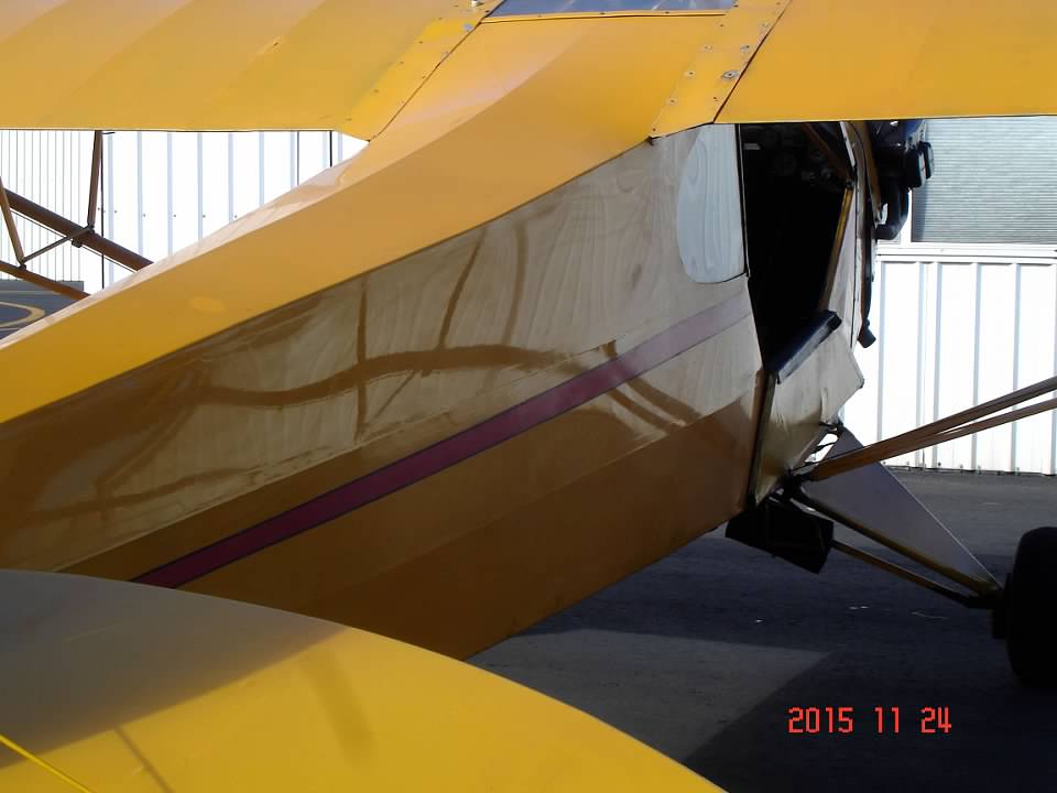

And an example of my Binks model 37 expertise. Paint is 1981 acrylic enamel, sprayed in my driveway (loved the stuff, but now difficult to buy); photo is 2015. It still shines like that when I wipe the oil off with a little Pledge.
