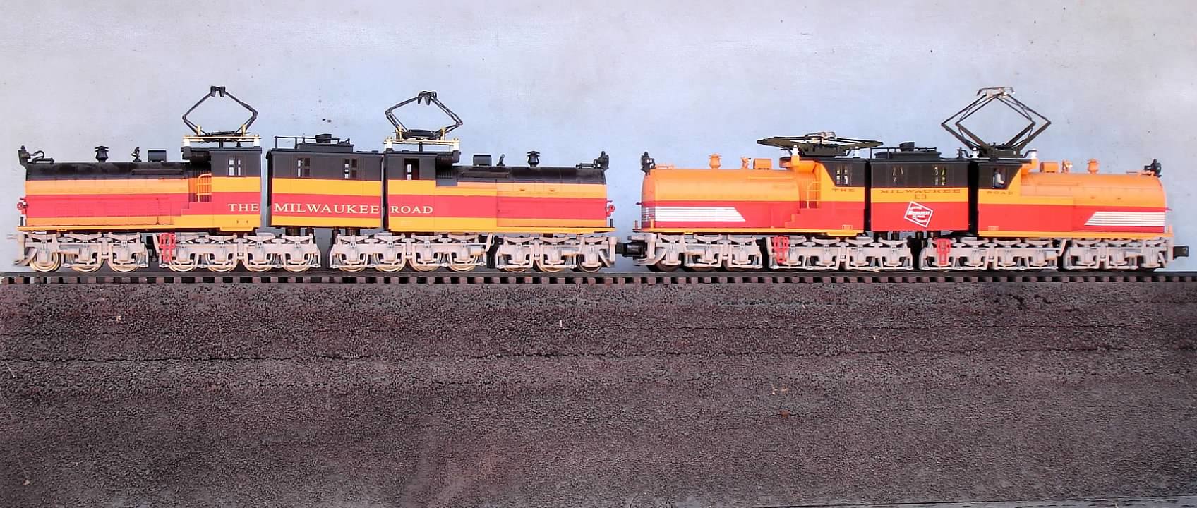

Here they are - the one on the left is 2-rail, but not yet operational. I think I have maybe $170 invested, having lucked out with Perry's Hobbies on a set of cab castings about two years ago and a mechanism last month. Patience is a virtue.
I note that both are sitting a little unevenly - ever try to get 28 wheels on the track all at the same time, while the wheels you have been successful with are quite jealous that maybe some other wheels will make the grade?
And those small pantographs! They just won't do. But I am patient.

It looks great. Patience has always been a valuable trait, especially in O scale.When will you start the other.

Bob, those do look good. I thought I was following along, but somehow I missed the fact that you had two of these. If you get a chance, would you take individual shots, post them, and identify the manufacturer? As far as I know, NJ Custom Brass did the only bipolar in brass, while the Lionel and MTH versions are both cast (but maybe I am wrong?). Further, the Custom Brass and MTH models are the "pre-rebuild" version, while the Lionel model is the "after rebuild" version, which is notable for its rounded nose.

Both of mine are the MTH versions. The reason I have two is because I got pieces from Perry at a favorable price, and in between an entire unit from retroniac for a very favorable price.
I will 2-rail the one on the right in the future, but I think I shall subcontract for steel driver tires and machine a new mandrel for better concentricity - the current 2-rail wheels have ever so slight eccentricity, and while they will track ok, there may be some extra wobble (probably not unlike the real thing).
