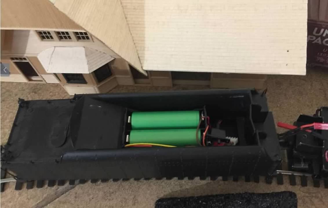

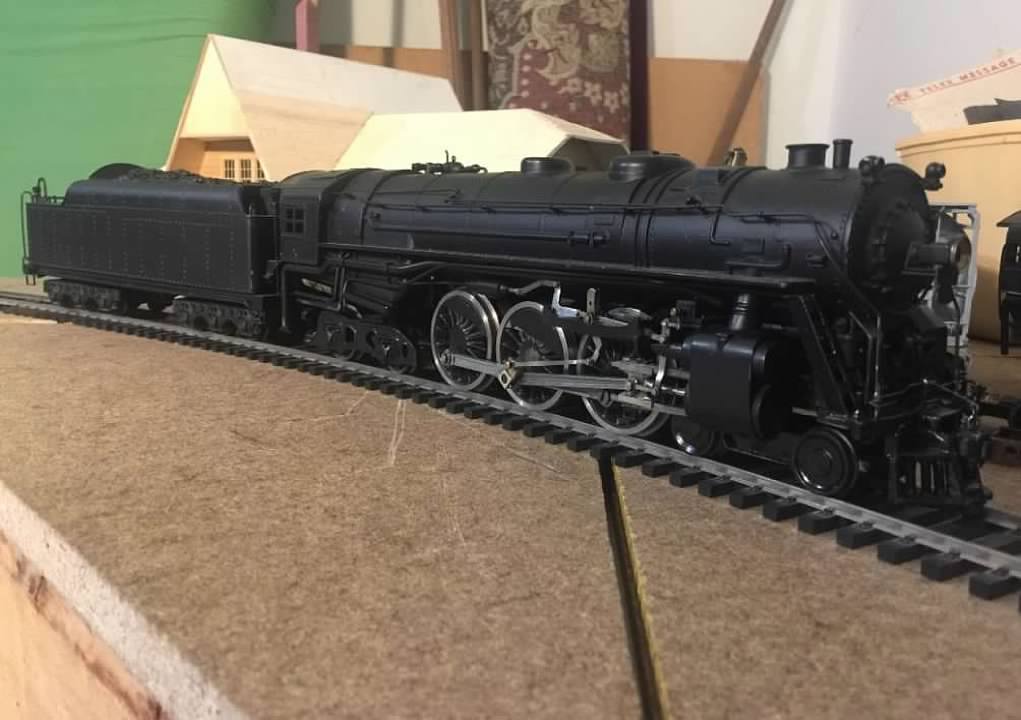

Postby steamaheadstephen59 » Sat Oct 28, 2023 11:28 pm
I didn't wont to two rail this Hudson so in with some batteries.Im tempted to lay some outside three rail track but for now this will do. Image Image Image

Postby steamaheadstephen59 » Fri Nov 03, 2023 9:52 pm
Hi Bob Its frustrating to me, every thing model trains and especially O scale and control systems, has big bucks attached. Theres really only a few miner differences between controlling a model train and an R/C car. The first is the controller or transmiter , Lionel ( Lionchief ), and Menards really only re -packaged an R/C car/plane controller into something more user friendly to model trains, in fact the train application is simpler. Its all 2.4ghz radio control. If you had some one in China, catch the vision, and do something for model trains, it probably would cost $35.00. Ive used ,in the Hudson a Bluerail board still 2.4ghz but Bluetooth and my old apple phone and an APP. Its now all under Blunami by Sound Trax. I think you will find that the fellow who did the Bluerail boards new what he was doing in the industry, and pattended the application some how ( an educated guess on my part ) Ive seen bluetooth for model cars and trains come, and go quickly, they just disappear. The Bachman EZ bluetooth , and SoundTrax Blunami ( about $220.00 with a great selection of sounds ) are licensed somehow and use the same APP. It works great but there's no real competition, and the price stays UP! Bob you would knew more about this Patent situation than me. The batteries are Lithum-Ion 18650 cells, I just took them from old laptop battery packs ( you have to be carful when cracking them open you dont wont to short anything) Theres maybe two to three hours running. I have an old Atlas F9 with a $7.00 electronic speed controller, and $7.00 receiver, add a bridge rectifier and buck converter to step down my 20 volts ( to 8 volts ) say another $5.00 and, it runs track power. It starts at a crawl and runs at a nice speed, at about 8 volts the maximum for the ESC. I use a Deltang transmitter I built from a kit, But you could as easily use a $16.00 R/C car transmitter from China thats where they all come from, like it or not. It would be great if Menards made there's available, say forty bucks, for transmitter and control board, Lionel unlikely I think, the price would be steep, but that said they have good sound fills.

Postby steamaheadstephen59 » Sun Nov 05, 2023 7:10 pm
I need to add that Im not a die hard battery operater it just solves the need to convert to two rail, at least for now, and it doesn't need to be expensive.
