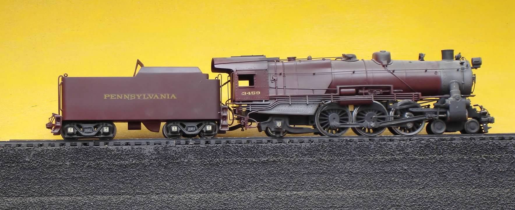

That one is a Scale Craft K4. They are nice runners - the best are the ones with gear on the center axle and removable drivers. I have four. Yes, I think 17/64, but I have not measured.
- Posts: 13671
Re: PRR K5
deadsville, huh? Just for that you get to again endure my K4 collection.
This one is my favorite - Tuscan (Scalecoat - sigh).
First thing I do when they come through the door is add flanges to the center driver. Then smokebox and firebox - and cab. I never bother with the tender - I of course have the skill, but I am sort of happy without the rivets.
Sorry for the repetition.

I love your videos. Slow them down so we can appreciate the models - and when do we get "stills" of all those interesting models in the background?
Another K4, since I am sticking my name at the end of another thread -
This one is bone yard stock, except for the coined drivers. I have a set of Scale Craft drivers, but they need machining.
Even the paint is ancient. I may have done the flat black on the smokebox, and surely painted the drivers, but the finish and decals probably go back to the 1930s. You can see an "alligator" cracking in some of the finish - I preserved it with a coat of Future Floor Wax.
Almost all my K4s suffer modification of a serious nature - this one is a counter point.
