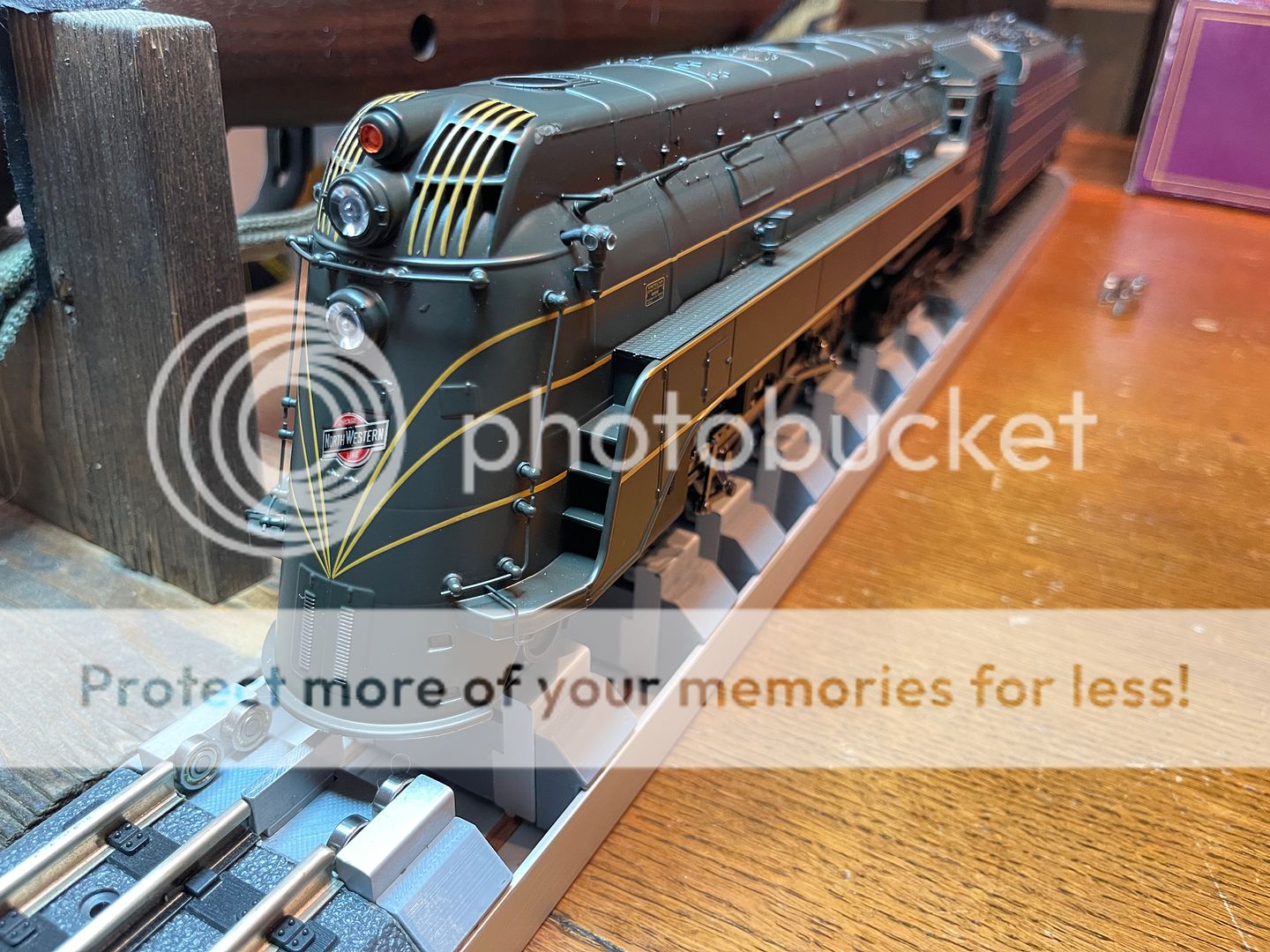

Hi All!! After taking a brief absence from model railroading I’m slowly getting back into it. I recently bought an MTH PS2 with Scale wheels that says it 2 Rail / 3Rail conversion capable but no where in the instruction manual does it say how to convert it. Any ideas?? Please see pic’s and thanks for any help!
I have another MTH engine where it says remove the roller pick-ups then flip the switch from 3 to 2 rail. I removed the pick ups but don’t see any 2/3 rail switch. Just an unmarked switch under the engine cab.
https://hosting.photobucket.com/images/ ... 269E9.jpeg
https://hosting.photobucket.com/images/ ... 768EF.jpeg

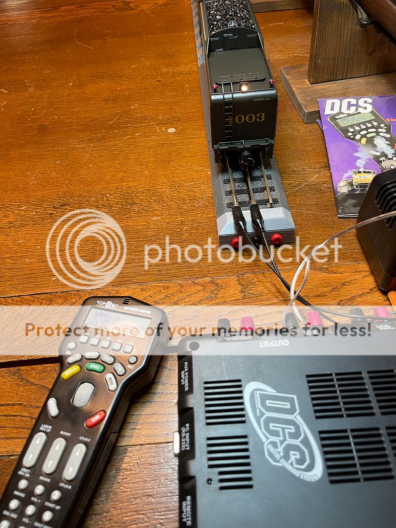

Great to hear from you, Rich!!! The box says it has scale wheels so I shouldn’t have to replace them. I pulled the pick ups and flipped the unmarked switch after putting power to the outside rails. I got nothing. Put the pick ups back on and hooked power to the inner rail and one outer rail on the roller test base and it fired right up. Something’s screwy.
https://hosting.photobucket.com/images/ ... E5080.jpeg

MTH steamers have drivers insulated at the axle, with necessary insulation on rods, etc. Shame, since the Koreans could have easily rim-iinsulated them for the same cost. They are also not standard-wired - insulation is on the right side of the locomotive.
My cure was to replace the frame, cylinders, and drivers. Made a much better model. Keep your eyes peeled for good Sunset and USH models - usually ready to go 2-rail.
Delighted you are back.

LOL!! There is nothing 2 Rail conversion compatible about this engine
I’m thinking Trainz got suckered into buying a 3 Rail PS2 engine in the wrong box with me getting suckered into buying it. I do have the option to return it for a refund but then again I don’t have an engine to run under this year’s Christmas tree.
And I’m not running any of my high dollar brass ones with 3 puppies and 3 kittens in the house.
