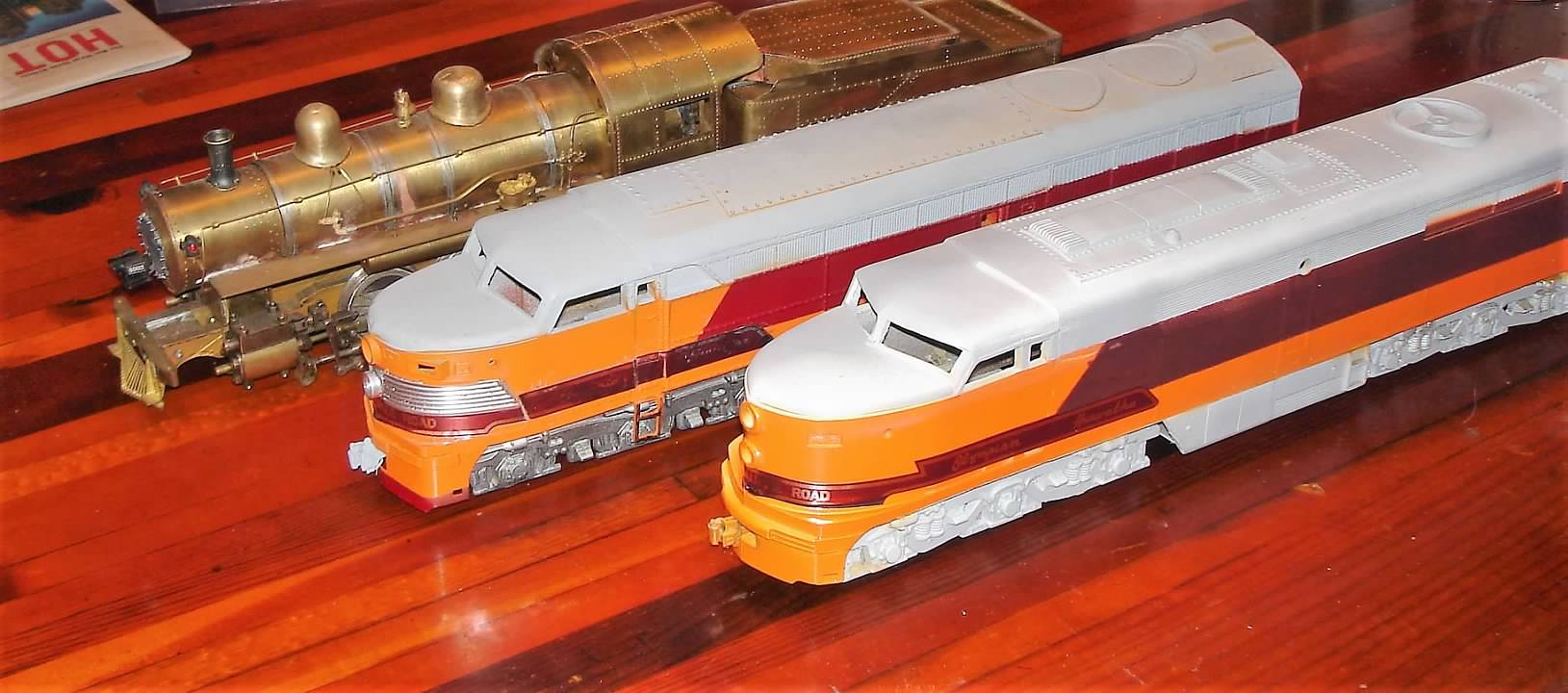

Well, there is no prototype for this one. Nobody in the real world ever grafted an F-M nose on a PA body.
There is definitely a point on the nose of the F-M. It is only a question of the contour leading up to that point. Drawings do not match photos.

I just added some contour to the Alco roof. It is with a small chunk of brass and some JB Weld. Next will be the corrugations for the nose, and paint. Next photo will be more colorful - if I can find that really good maroon paint.

Getting ready to shoot orange. Too cold right now, but probably this weekend. Really happy with how this looks!

Here we go - the sticker looks better on this one than on the more detailed Atlas nose. I will make the corrugated deals, then I am going to repaint the thing entirely and put a better sticker on it. May even move the fabricated trucks under it, although Milwaukee used only the cast trucks, similar to the PA trucks now under it.

Great job Bob! Looking at it one would never suspect the switcheroo unless they were familiar with the Erie Built car body.
Ironically the Milwaukee Road actually did something similar albeit grafting an EMD cab onto a DL109 car body.

Well, surprise, F-M fans. Note the difference in nose lengths in that photo.
Jim Scribbins did a nice book on the Hiawatha - and on page 254 he notes that there was indeed a longer, more pointy snout on the earlier units. I had sort of suspected that some were more pointy than others, but was unaware of the snout length disparity.
Learn something every darn day - too bad it isn’t useful stuff.
So my modified Atlas nose may be less correct for the B-17 windows than the sand cast variant.

De Bruin wrote:Looking at it one would never suspect the switcheroo unless they were familiar with the Erie Built car body.
I agree with Pete on this one but might go one further. I'd bet you could pair the two AA and run them for the public and many, many viewers would not know heads from tails. People tend to see what they think they are seeing.
Bob, I will also add that your "vision" that an Erie-Built nose match well to a PA body was closer to spot-on than I would have imagined. I would not have guessed that they fit together so well. This is not a comment about the aesthetics of the match-up, just the practical matter of getting them to fit. In my experience, one often finds that matched pieces often don't line up. To think that unmatched castings will is either a leap of faith or visionary.

No - just faith that the original pattern makers followed prototype dimensions.
Width is rarely a problem - measure all your Diesels; I bet all are 2 1/2" +1/16, -0.
Height, too, is predictable. Try it.
And yeah, putting an F3 nose on a DL-109 saved that unit from terminal ugliness!
I gave some consideration to putting very thin radiators on the hind quarter, but I agree - the thing turned out well as-is, and if we ever find a good bronze foundry we can have more sides cast and convert this back to a PA.
