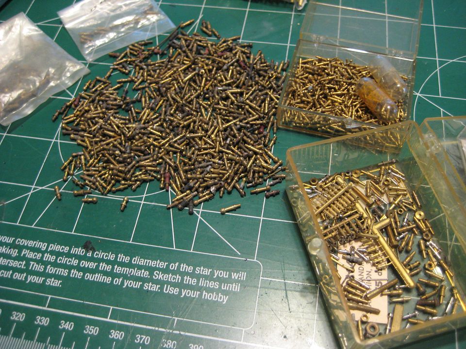

I looked through my stanchions with an eye out for the threaded versions. If .200" is what you require, I will measuring. Is diameter important? I think I can spare a few.
I'll look for the washouts. I had a bunch but, like so many things, they're spread out over way to many projects, in boxes.

I picked out a few that should provide what you need for this project but I had one of my infamous epiphanies. Since I don't use the threaded stanchions and you do, why don't I just send you all of them? Should keep you supplied for a while. Think of it as going from my Future Estate Sale to yours.

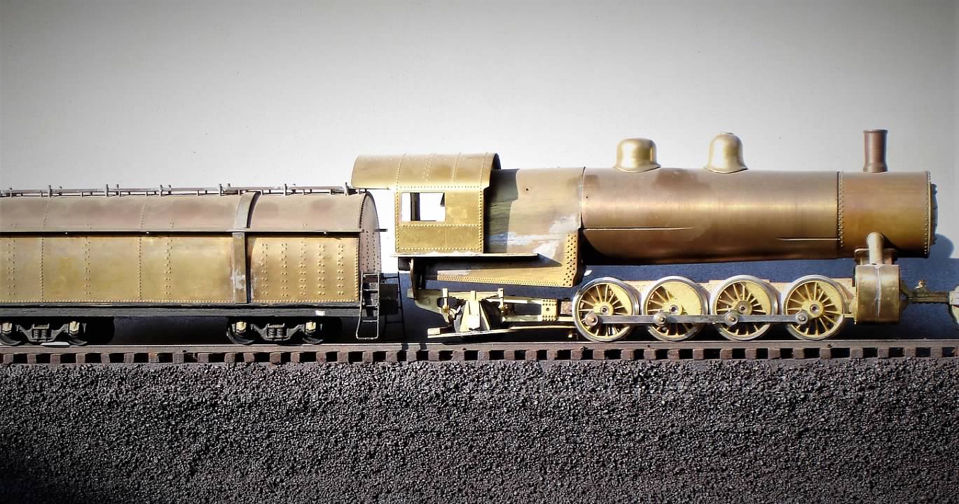

So, success! Sun is getting too low, but photos are in the can. One of the Mikado photos has a wheel off the track to get Dave all excited.
- Posts: 13275
Re: The "Woody" D&H Challenger
First the almost-finished D&H. Note the hole in the air tank. Gets filled. I was going to bolt the boiler to the mechanism, but the Sun was not cooperating.
Handrails, tank bands, half the throttle rod - all to go, and I need to "fit" the steam lines for easy assembly when it gets to Dallas.

Now for Jay, and shared here just to entertain the rest of you - this is what I mean by "blocked out:"
Boiler barrel is genuine Lost Wax Lobaugh. I think its sister is at your place. Frame is Berkshire, which turns out to be the same wheelbase as the prewar Lobaugh Mike. I cut the rear off and make brass tailbeams to fit the Hodges truck. This truck is a Pearce/Stevenson, but CLW has a beautiful version that is not quite so picky about where the leaf spring is supported. Cylinder block is Lost Wax Mike.
Drivers are coined Loco Works, but I always use cast-iron Berk drivers, or the Henry Pearce equivalents. Henry's had better counterweights for SP models.
The Lost Wax frame was a machined affair - wheelbase was just enough different that new rods had to be made. I think Stevenson has both sizes of rods, and I just heard from him this week - he is pouring hot metal!
The Mike had almost any kind of tender you can think of, including that neat switcher tender that jumped the track. Lobaugh supplied the world's ugliest Vanderbilt with the kit - that tender existed only on 2-`10-2s in the beginning, and one is preserved behind Joe Dale's Mogul. I prefer either the 120C tenders, or a haystack. Haystacks are easy to "Block out," at least the body part.
So, here it is - awaiting nice things like rods, running boards, handrails, boiler bands, etc etc
- Posts: 3056
The D&H is looking really great, Bob. Do I understand that you removed all the paint with the bead blaster? For some reason I can never get it to all come off when I do that. Maybe it's simply that you're working with a mostly smooth brass model and I am usually dealing with some rough sand cast item. But still, I am surprised that the paint comes out of the seams as well as it does.
