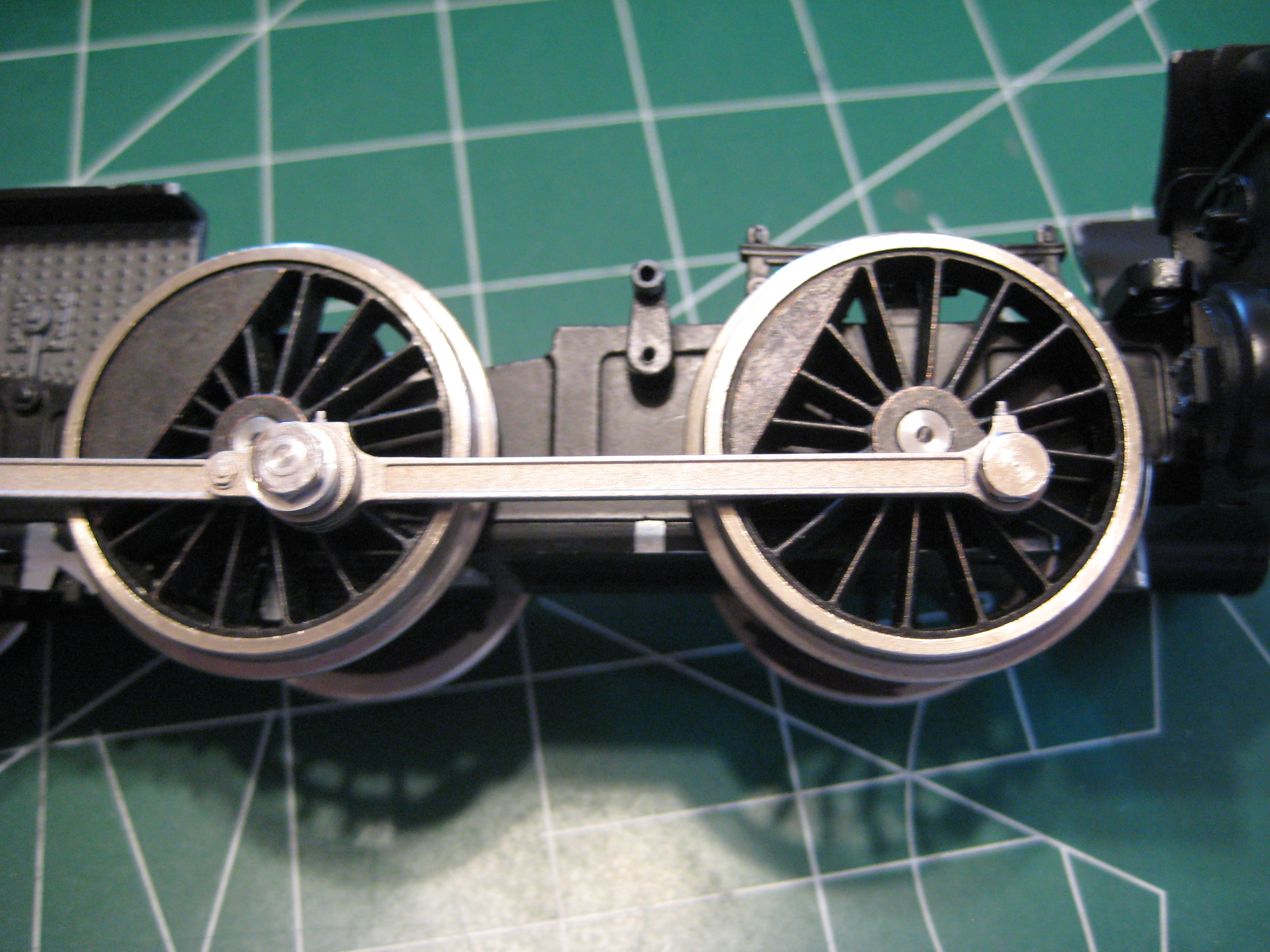

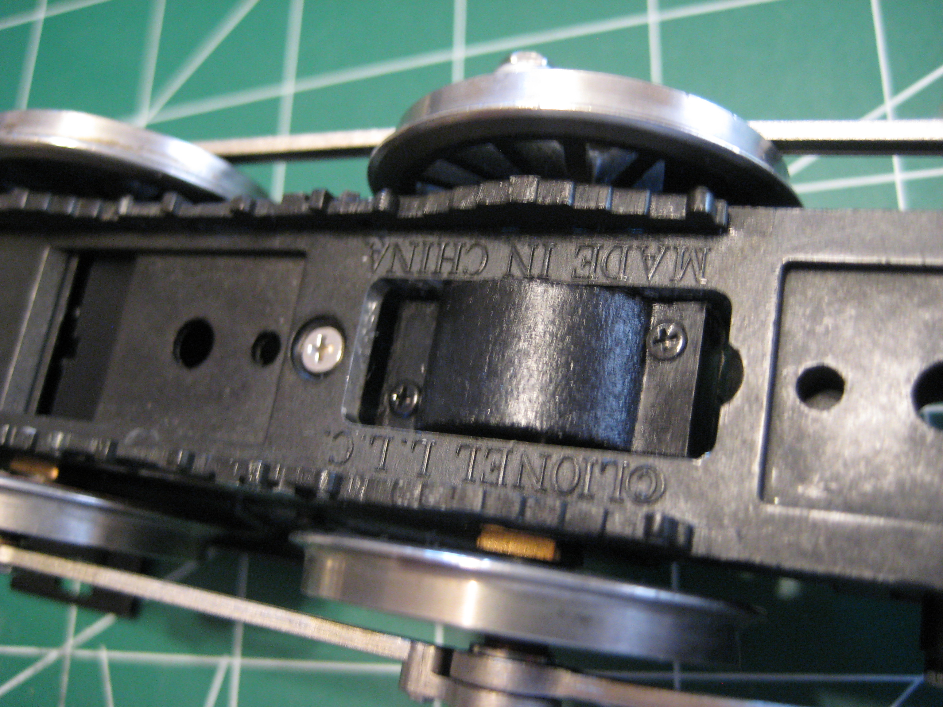

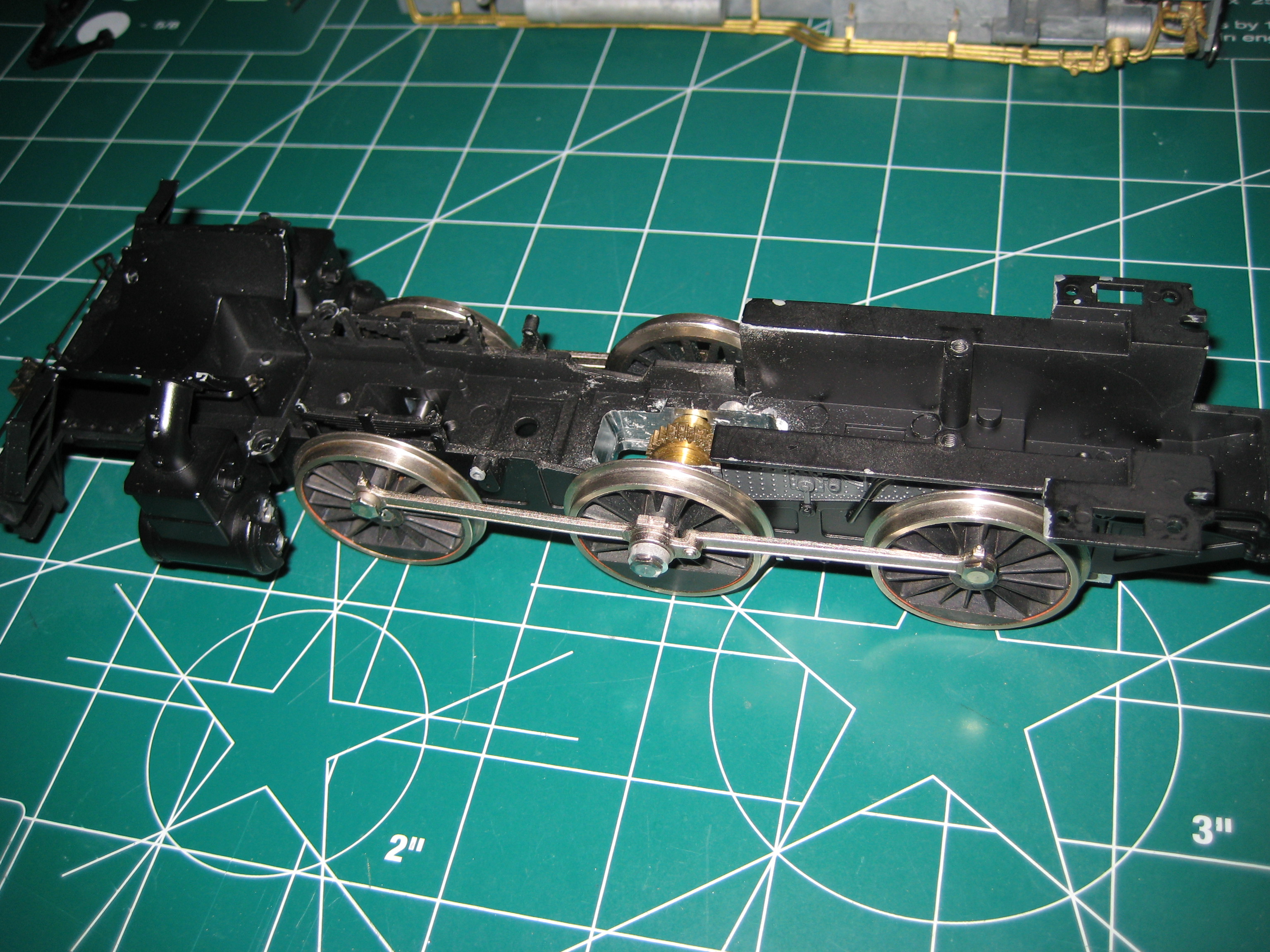

I don't do a lot of 3R to 2R because of the way so many were designed. Some of the newer Lionel have a more conventional drive and I will do them. Still not my favorite thing to do but sometimes, if the stars are aligned incorrectly, I 'll begrudgingly do them. This is a little mogul I agreed to do. Lots of little issues encountered along the way but it's done and ready to go home. I don't know where the owner got the drivers and I don't care for the tires and flanges but, sometimes you work with what you're given. NWSL .5 mod ball bearing gearbox (yeah, it had issues too). The owner will supply, and install, the motor.

Jay, those Moguls Lionel did have a fun history to them. They are B&M prototype and very nice models of them (though Lionel generi-cised them a bit in later runs). It would appear they got an HO brass one and had it copied, scaled up by twice to (you guessed it) 1/43.5, which is UK O scale and very near 1/45 (17/64), the same error Atlas made with their Trainman RS3 and RSD5 (oh, how Jim Weaver denied that!).

So, what you're saying is, SP's M-21 is no longer the largest Mogul ever...at least not in the world of O Scale!

I love it! 17/64 scale, by accident!
The gearboxes produced after Raoul sold can be easily fixed by wrapping a #J drill with 400 sandpaper and sliding the partially assembled gearbox along it until it mates the axle bearing. Not sure you want a brass axle gear - if bronze, it will work for a very long time - if brass, one hour.
