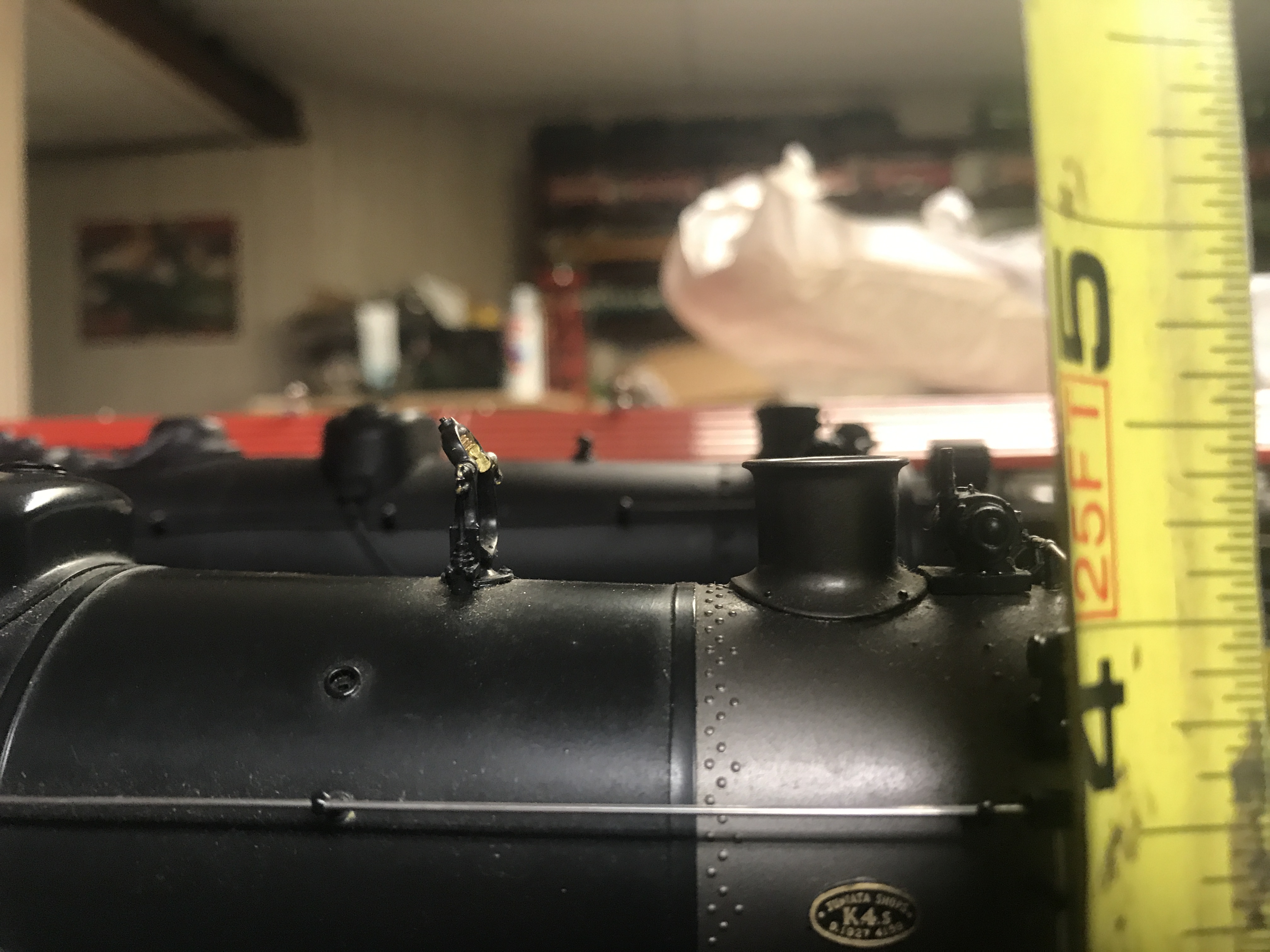

Bob, do you have any close ups of your scalecraft frames? Anyone else please post as well. I've been looking at the old thread for the K4 that Allan had Joe work on the wheels as reference.

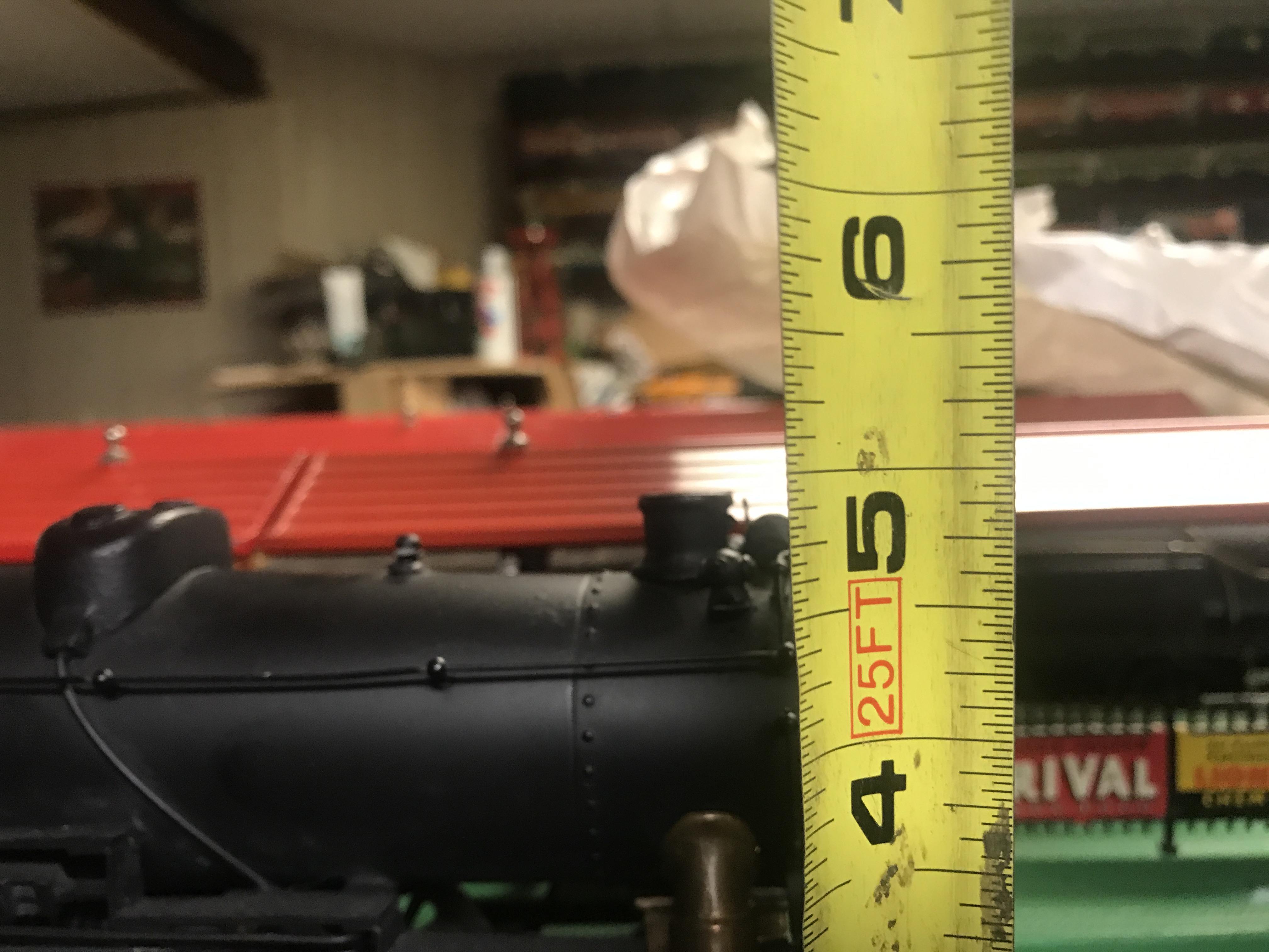

Also, for my own reference are all these SX K4's considered to be somewhat 17/64th's? These tower above my Williams K4 although there are barely longer or wider.

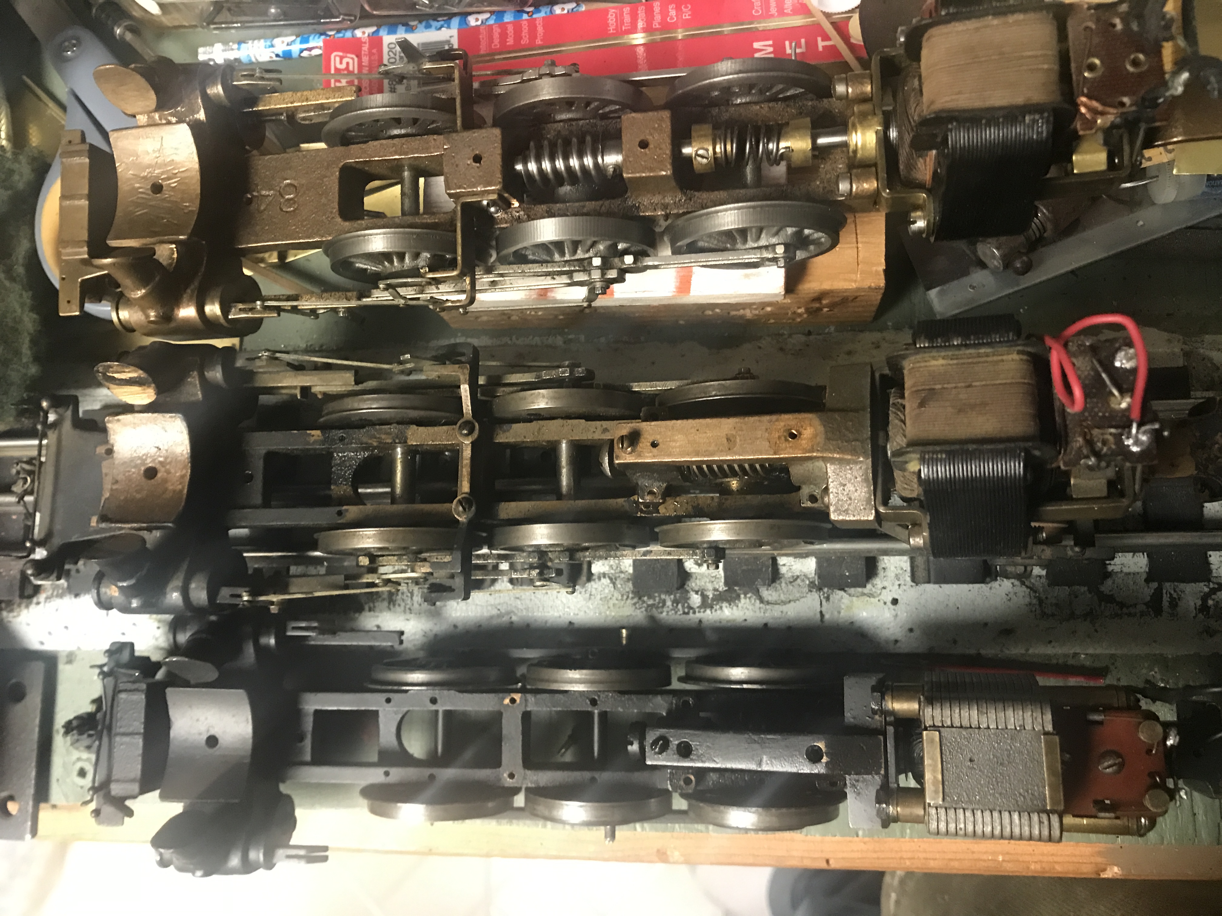

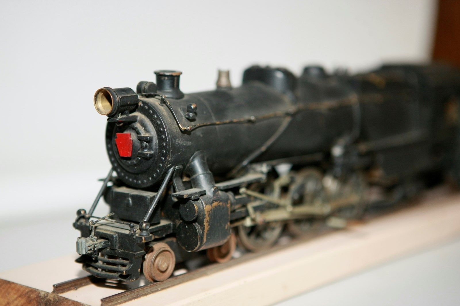

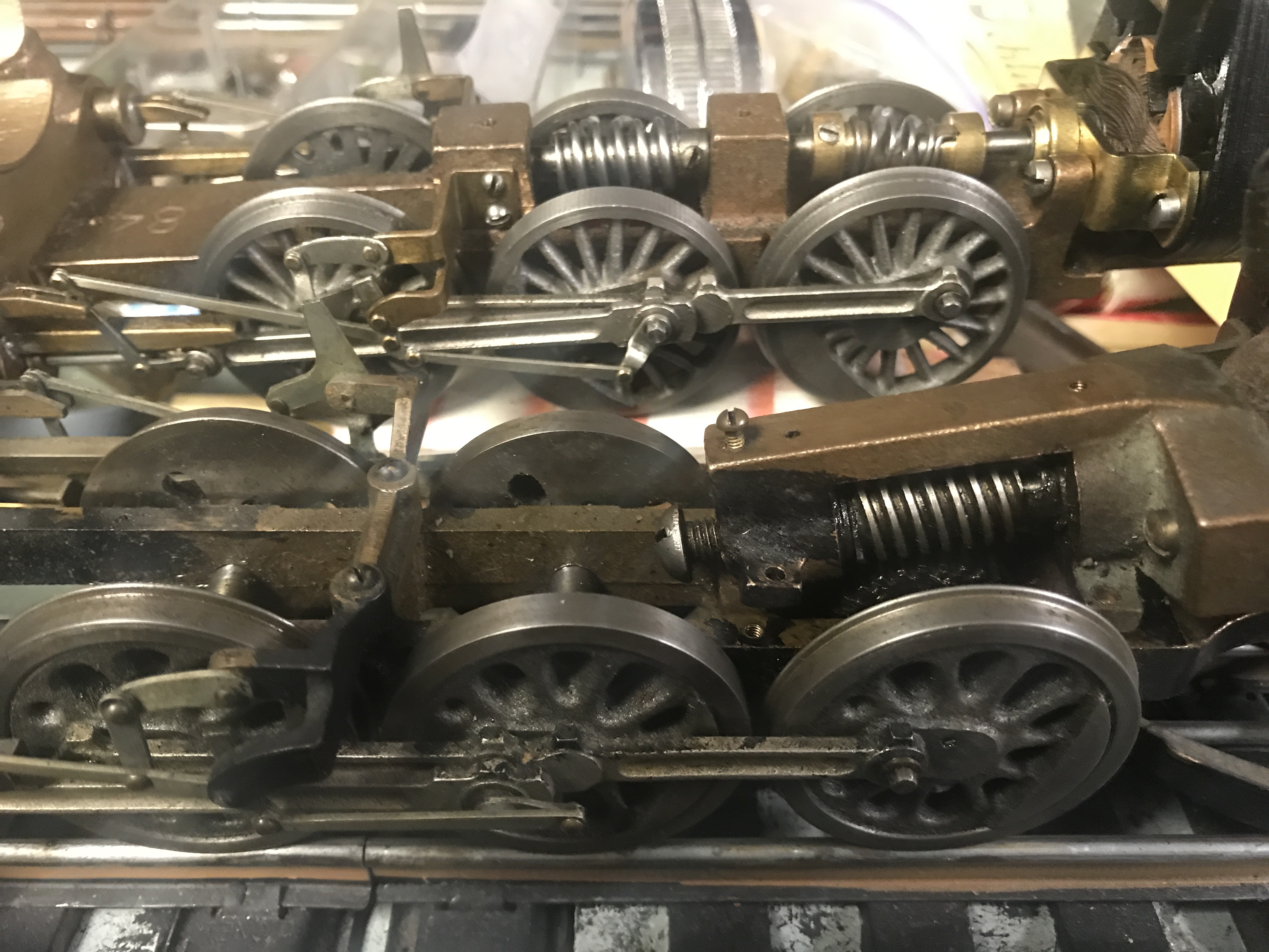

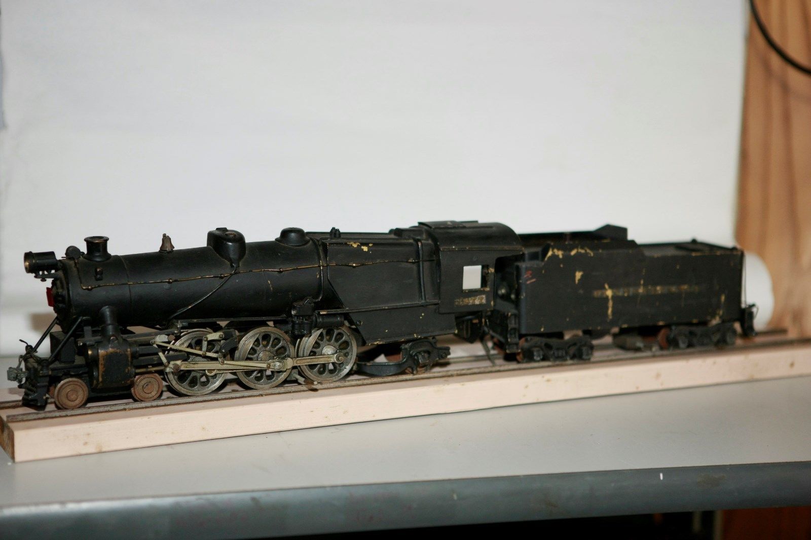

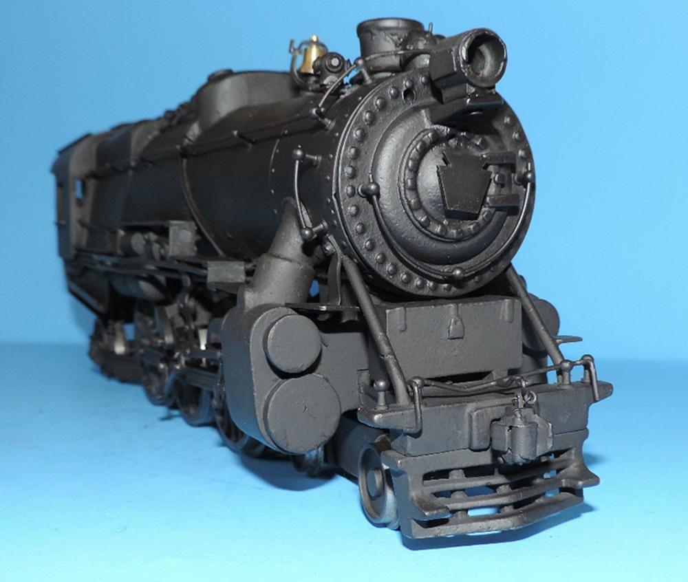

While I'm at it, here are the starting points for these. The first one I got was in pieces with the frame built up. I'm not sure if it was a factory built up frame or not. One thing I notice is that the motor mounting holes place the motor shaft considerably lower than the worm gear shaft centerline which puts the spring drive under a bit of a bind. The Toyota hose would probably help that but raising the motor up would as well. I'll get some hose and check that out though. It has the stock SC Cresent drivers like most of them and not 2 railed as far as I can tell.

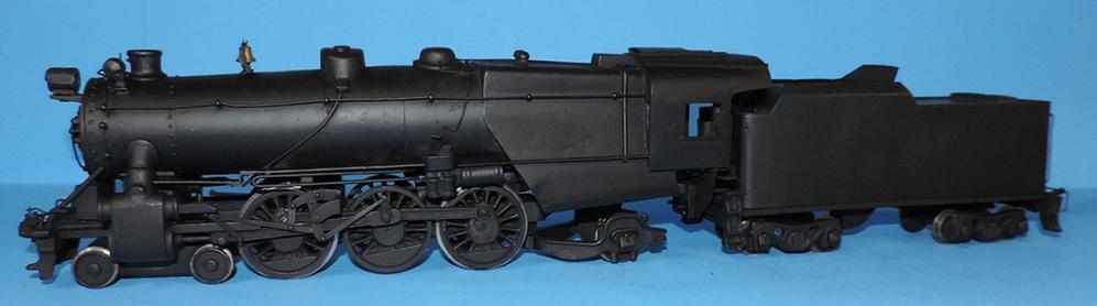

The next was this all black one with rear axle drive. It was two railed and came with a Permag motor. It did run but was rough with some binding. The wheels were machined all over the place, with some being .020" wider than others the gauge was all jacked up. It has straight counterweight drivers, but only 15 spoke and they were machined to 1.603" or so which is a good bit short of a scale 80". The tires and flanges are all out of whack to each other as well. I think can save them but they might just be an experiment. The boiler to firebox joint isn't too bad but not too good either. I'll probably just leave it as is for now... It needs some paint though.
Last is this new one with the Lobaugh drivers. It was complete but had a bit of binding in the valve gear. Work in progress I guess.
I suppose I have visions of grandure, but for now they are all just piles of junk waiting for me.

Elongate the motor mount holes and straighten the drive shaft. Original motor and coupling will give you excellent service - a Pittman/ Toyota hose will make it slightly quieter and snoother. The can motor can be mounted in a tray using old rubber sheets and aircraft safety wire. My trays are just leftover segments of old boiler material.
Scalecraft made both types of drivers - the SP and NYC got the crescent counterweights. A Dremel tool and a very steady hand will convert the counterweights.
Yes - closer to 17/64. The SP was seriously oversize. Tender was closer to 1/4" scale.

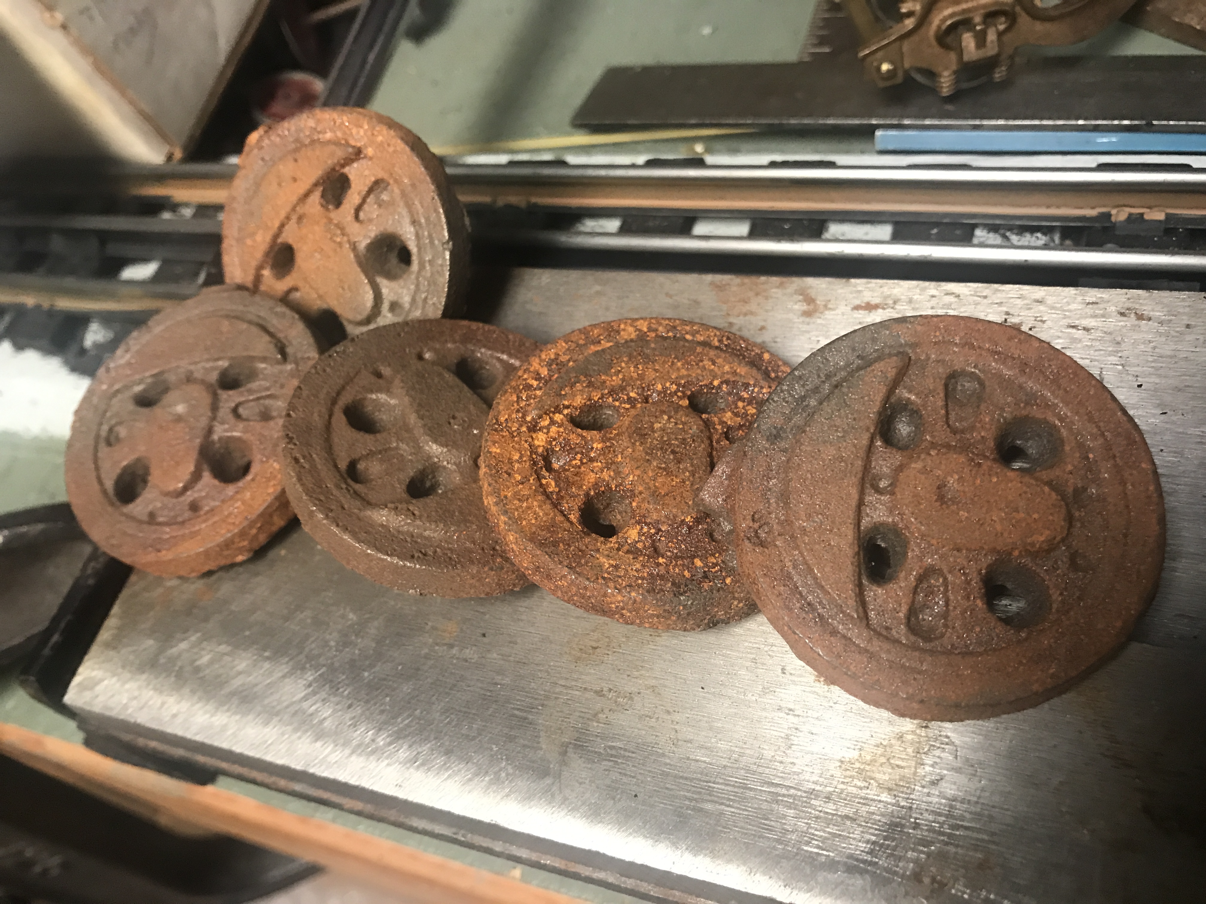

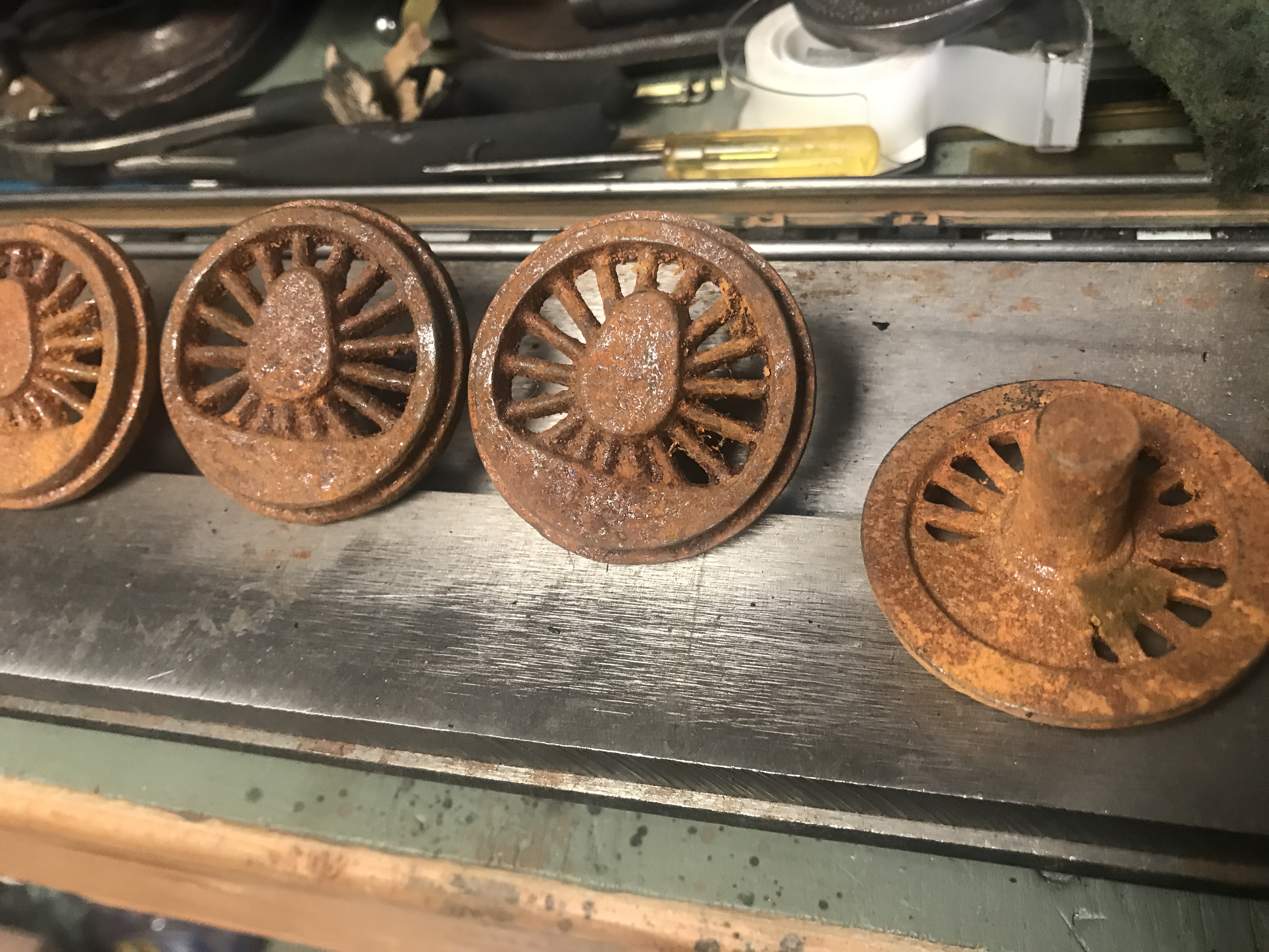

So do you think these are Scalecraft castings?
I know the next (partial) set is not... too bad I only have the five and not six...
Don't know where the second set came from....
Btw, since the first post, I worked on the drive some more and I think I'll leave it be for now. (Talking about the Boxpoc rear axle drive chassis now).

You are ready. Machine six tires. Use the Lobaugh for sizes.
Then machine the "button" to fit whatever collet you have. When you turn the driver around, make sure the rim is concentric. It usually is, because most castings are dimensionally pretty good. If they do not cut like hot butter, they need to be annealed.
First cut is the face cut. Just remove the scale and get a smooth surface on CWT and crankpin boss.
Second cut is the rim. It goes deeper than the first cut. How much is a matter of taste, but use Lobaugh as a guide.
Third cut is a very small square groove, separating rim from CWT. Again, use Lobaugh as your guide.
Three of your castings can be machined to match your tires. I recommend that - the cast iron is a lot like traction tires. It "grabs!"
The other three get trimmed to accept paper insulation and tires.
Bore the axle holes with a center drill, then a good solid crankshaft drill (short). Bore the crankpin holes with a jig!
Facing the back is the last step. You can do that in the 3-jaw. It isn't critical, but use care to keep it parallel to the face cuts.
Good luck!
Good luck!

When I machine a set of new drivers from iron or bronze castings, I ream the driver axle hole with a precision straight flute HSS reamer that is 0.001" under the axle diameter making a nice press fit. Once center drilled, re-drill the axle hole with a good drill bit 1/64" smaller in diameter than the axle and then ream to size. I also use Loctite 609 Retaining Compound on the connection as Bob mentions above. As far as center drilling the driver castings I often use the No 0 center drills but you can use a larger one that has a body smaller than you axle. I don't think it will matter.
Getting the crank pins accurately drilled into the crank pin bosses is also very important. I made a jig years ago that is fixed to my milling table with clamps. It is a flat piece of 1'2" tool steel with a piece of drill rod the size of the axle mounted to it. The drill rod extends upward to be held in a Jacobs chuck in the spindle of the milling machine. Once the chucked piece of drill rod is released from the drill chuck, the milling machine table with the clamped down jig is dialed out to the crank pin throw desired and a No. 0 center drill is used to start the crank pin holes in the driver casting's crankpin bosses. This results in all of the crank pins being accurately located at the exact same crank pin throw. You can remove the center drill bit after starting each hole and final drill the crank pin hole using the correct size drill bit and reamer to match your crank pin diameter, I Loctite my crankpins into the driver castings. I do not machine as many drivers from rough castings as I do reworking 3 rail drivers that have accurately located crank pins but when I do machine rough castings this method has worked well for me.
Regarding driver tire insulation, I use 0.010" "fish paper" to insulate my driver tires. McMaster Carr is a good in line source of this material. Loctite 609 adheres to it.
Have fun and take your time with this.
Joe
