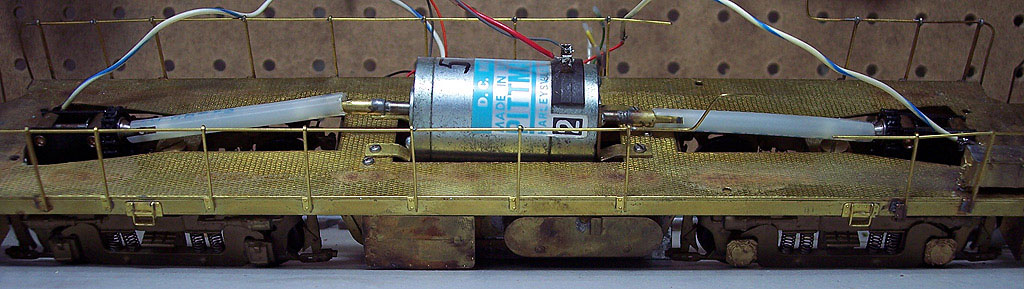

Re: NJCB RS-3 Drive Train Improvements.
the wipers contact the inside surface of the wheels. notice that I also replaced the nylon tubes with northwest short line parts.
- allnationunits.jpg (204.73 KiB) Viewed 6162 times
Good picture worth a thousand words Dave...excellent! I have those same wipers. Some of the discussion here also concerned the exposed gears and their lubrication being somewhat subject to ballast intrusion etc. Have you had any issues?

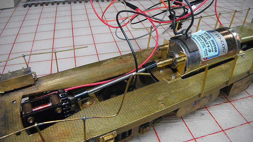

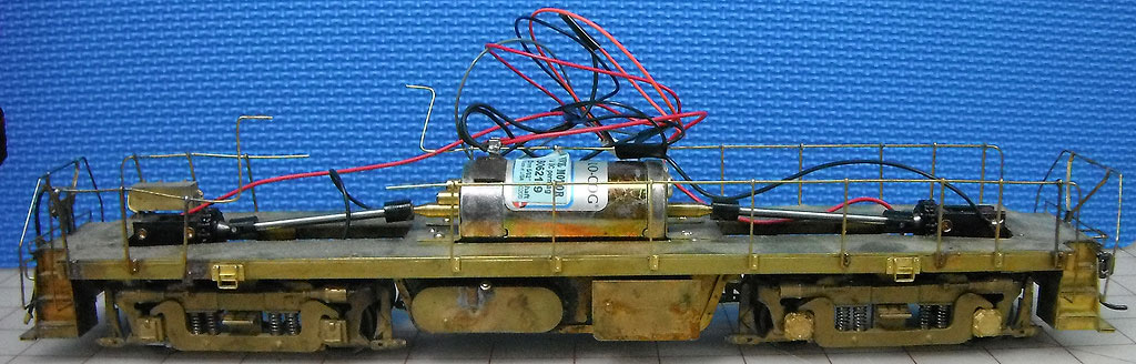

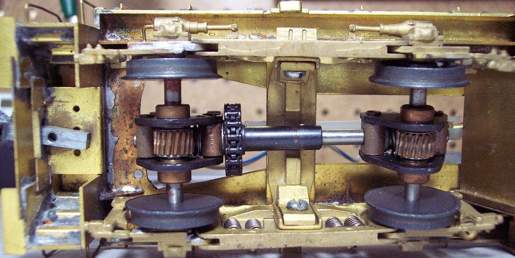

Sorry this is so late. Below are pictures, first how I received this used and then the NWSL new motor and drive.
I did replace the drive chains and Jy fixed and bad truck for me. Other then that I left the wheels alone.
Thanks for the follow-up Dan...photos always a help. I have that same motor available to swap in case the original turns out to be a dud. It's a work in process.
