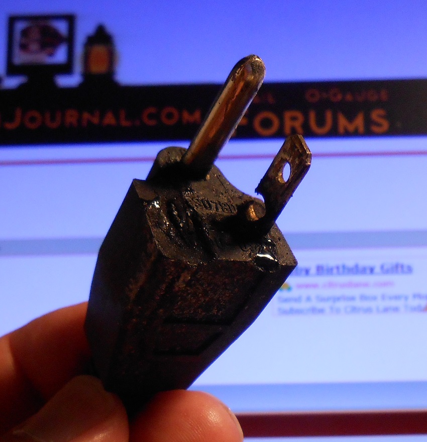

The power surge from lightning took out my evaporative cooler. I thought it was just the fuse, but a new fuse blew while I was putting it in.
---NOTE to myself--- Turn off main power when replacing a fuse, it might be less exciting that way.
I think I see part of the damage to the cooler. This is the power plug to the water pump in the cooler.
- Water Pump Power Plug after Lightning Strike.
- Water Pump Power Plug.jpg (244.56 KiB) Viewed 1807 times

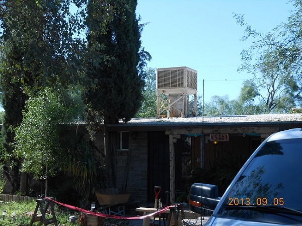

Webenda is your cooler up on the roof? Mine is and at my age I'm no fan of going up there each spring to clean it out, put in new pads, put water in and hope it doesn't leak. And then in the fall drain the water and shut the water off. In 5 years I'll be 75 and then really not thrilled to go up there.
Well, that certainly may have a bit of impact on functionality. Hopefully, you don't have electrical damage after the plug....

My house has plug fuses. The 1 6/10 amp pump fuse was blown. As I screwed a new one in I heard arcing, then the fuse vibrated, lit up inside and said, "Phffft." That would have been fun if I was an adrenaline junkie.
After replacing the plug on pump and socket in cooler, I Ohmed it out. Plug to motor coil, two ohms. Center pin short to motor frame. Other two plug pins open to motor frame. The pump tested fine when plugged into a kitchen socket. Put pump back in cooler, turned cooler on, welded the switch into permanent on position and blew the 20 amp cooler fuse. There is no way I miss wired the new plug… is there? I mean, white to white, black to black, green to green, red to red, brown to… wait, there are two brown wires. I decided to look at the unnecessary wiring diagram. Doh!!! I connected the smooth brown wire (hot) to the white wires (neutral.) The ribbed brown wire should have gone to neutral.
OK, swapped smooth and ribbed brown wires, installed new switch, new 20 amp fuse and now I am freezing here in Tucson. Better turn cooler to low for a while.

v8vega wrote:Webenda is your cooler up on the roof? Mine is and at my age I'm no fan of going up there each spring to clean it out, put in new pads, put water in and hope it doesn't leak. And then in the fall drain the water and shut the water off. In 5 years I'll be 75 and then really not thrilled to go up there.
Yes, but I have a very uncommon 1 pitch roof, so it is easy to work on the cooler, almost like being on a deck.

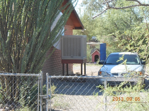

My neighbor fell trying to make the transition from a ladder to his 6 pitch roof. He was in the hospital for a long time with back injuries. He moved his cooler to
a platform on the ground so he does not have to risk another fall. It ties into his existing ductwork.
