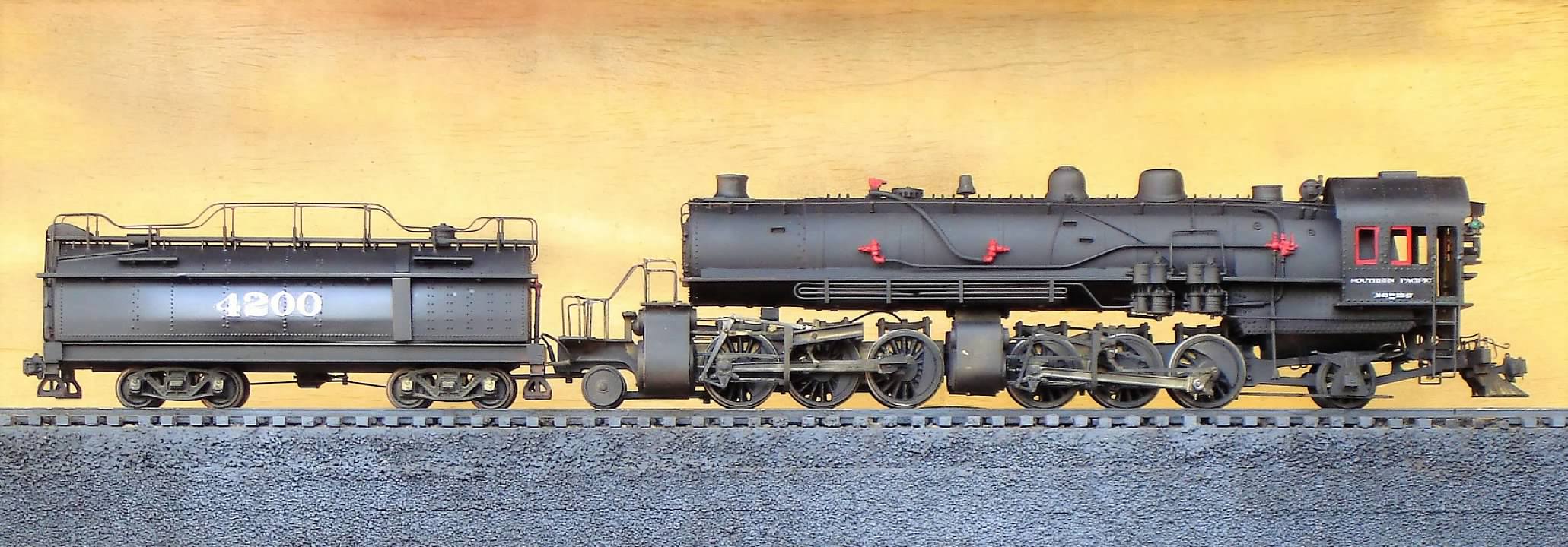

Tonight my Back up Malley was making its sixth trip around the outer loop when it locked up. This is the one about which we did a ten-part construction series in OSN.
Even though you see no drive shaft, this one is one of my very best runners - it has two different ratio gearboxes, two different mechanisms including slightly different driver sizes, and is just glass-smooth.
But it locked up! A very quick look revealed that the rear engine driver bearings had frozen due to inadequate lubrication!
The moral of this story is - if you let a model locomotive sit for four years, best to put a drop of oil on all bearings before going too far with it.
Back on the track tomorrow - too late to test it now.

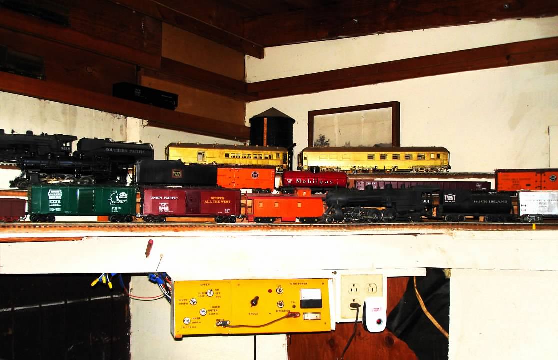

New control panels, everything works. Photo maybe.
Funny story - the panels are Piper Cub yellow with black Leroy lettering. The Greek said “I don’t understand - what is loop one, loop 2, etc. I tried to explain, but it wasn’t sinking In. Baffled - she is very bright with a Masters degree from an Ivy League university, and the concept of a loop puzzled her?
Tonight I invited her to look at the new panels - she said “oh - railroad. I thought you were making airplane panels.”
Now I get it.

Postby bob turner » Tue Jul 09, 2024 2:51 pm
Sorry it took so long:
I have been learning stuff:
My outer loop is steel track, partially exposed by a window. Big Backup Malley has been hesitating in the vicinity, even though I have carefully cleaned and oiled the track.
Years ago, I tried to eliminate the hesitation by installing feeders every eight feet or so - no luck. When we re-did the roof, I cut all of the feeders off, and on reassembly last month, I merely cleaned all the tracks with 320 sandpaper and oil.
But yesterday I really took the time to clean it really good - I mean, really good. No more hesitation.
Same is true on brass and nickel silver loops, but it is seriously important on the steel rail. I used to use Wahl clipper oil, but I have discovered that any light oil will do - even votive candle oil (don't ask).
