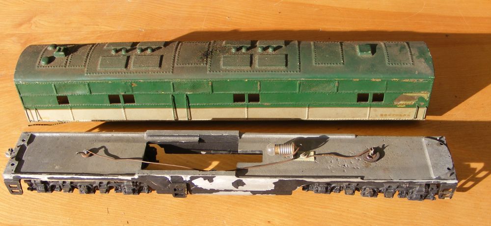

Postby railandsail » Mon Jan 01, 2018 3:27 pm
Well I finally got that fellow to drop by with the other 2 boxes of 'stuff' he had. Turns out there is
1) an unpowered B-unit for that E7 loco
2) a PA loco
So I'll try my hand a photo posting again....
(Woops, photos posted in opposing order??)

Posts: 3132
Re: 1941 City of Los Angeles
Postby R.K. Maroon » Mon Jan 01, 2018 8:43 pm
Thanks for posting all the photos. The sleeve for the Siebers Bros. sides is really cool and probably extremely rare (not to be confused with extremely valuable):
Siebers Bros. was one of several companies that sold locomotives made from Adams and Son castings but there is not much more than a trace of their name these days, as they didn't mark their models (and A&S marked their castings).
The short sides are for the E7, the long sides are for the EB, which I believe is the same for the E6 and E7. That is, there is no difference, at least cosmetically, between an E6B and an E7B. Somebody correct me if I am wrong.
The built-up EB looks like it has the Siebers Bros. chassis. Bob T. will take note of the rivet baton strips, a feature not often seen. Looks like pretty good work at a glance. While, as stated, I don't believe there is a difference between a prototype E6B and an E7B, there is a difference in the roofs of the Adams and Son casting set for their E6 and E7. This particular EB has the E7 roof (which is more accurate -- the roof for the A&S E6A and E6B is greatly flawed).

Postby bob turner » Mon Jan 01, 2018 8:57 pm
Yes. Rivet strips are impressive. PA - not so much. But save the trucks and gears for the E-7 projects.

Postby R.K. Maroon » Mon Jan 01, 2018 9:43 pm
The PA may be an IMP or other early import, but I'm not sure of that. Is any part of this model made from castings? There is a lot more detail on the sides than you usually see with brass sides (Exhibit A would be the Siebers Bros. sides).
As Bob suggests, the drive appears to be US-made. I have a couple of sets of these drives (with the motor mounted to the truck gearbox) and spur gears on the end:
I am not sure of their origin, other than I got them from Bob T. (he will recognize the photo as his own). They could be Exacta but also have much in common with the drive from the all-cast CLW PA.
The FT side looks like Wentzco, as the A&S FT casting set included cast sides. I would guess that all the B-truck side frames that appear in these photos came from a Wentzco.
Postby Nortonville Phil » Mon Jan 01, 2018 10:55 pm
Maroon,
When I look at that PA it looks like a Cast shell to me because of the thickness of the body sides. At least the nose is a casting for sure. Look at the headlight area where you can see roughness left from the sand casting process. I wonder though if Exacta ever made a copper PA.

Posts: 13597
Postby bob turner » Tue Jan 02, 2018 2:47 am
Here is the deal on PAs:
Bob Smith was commissioned by Alco before the first unit was built. He and Winnie were present at the Waldorf Astoria when the real thing was unveiled.
From his masters he made 600 more models for "us".
The first Smith castings were the most accurate PAs ever made in the USA with the possible exception of a scratch built or two. The second run of CLW PAs was wildly inaccurate from the cab doors forward. Whatever that thing is above (no offense) belongs in the brass recycling bin, so that someday it can be made into something with a little class.
