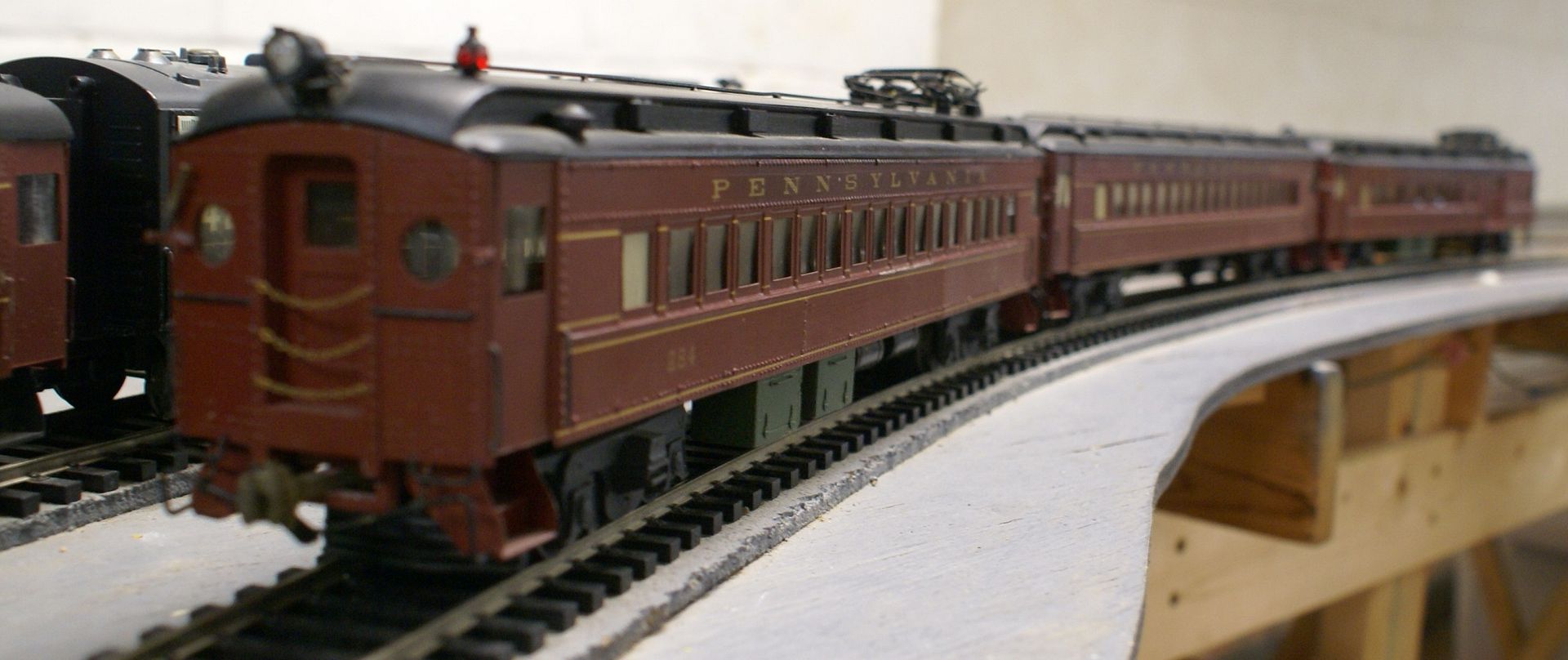

Thanks guys, the bonus is they actually ran upon arrival after some minor cleaning and lube. By itself, just one of the powered cars does not have enough ‘umph to pull the unpowered coach up the ruling grade by itself, so both are required.
Kind of enjoying the grind and growl in operation not unlike the actual Mp-54’s.
I had forgotten how noisy these Wagner drives are, also strange in either direction at constant speed the headlights have an odd fluctuation in intensity that seems cyclical. Weird.

De Bruin wrote:Thanks guys, the bonus is they actually ran upon arrival after some minor cleaning and lube. By itself, just one of the powered cars does not have enough ‘umph to pull the unpowered coach up the ruling grade by itself, so both are required.
Might be a little cautious about load on those drive on a grade -- no idea which gearing they have vs. the weight of the cars.
Might benefit from a drop or 3 of oil.

De Bruin wrote:....in either direction at constant speed the headlights have an odd fluctuation in intensity that seems cyclical. Weird.
The first thing I would do is make sure that the wheels are really clean. If there are wheel-wipers for pickup then inspect those as well to make sure they are making clean contact at all wheel positions.
If there is no problem there, then it may be that the size of the wire between the track pickups and the motor is a bit too small, so that there is a load-dependent voltage drop in the wire. The load dependency would be due to slight imperfections in the gearing. I have found this all too common in old steam locomotives, but with them the load dependency is usually due to mild binding somewhere in the valve gear. If you have an ammeter on your throttle you may be able see the fluctuation.
One test of this theory is to move the headlight wire from the motor (where it usually is) to the truck pickup. Or simply double up the pickup wires to the motor (even temporarily).
Or it may be something else I haven't thought of. Other ideas out there?

De Bruin wrote: ...snip... I had forgotten how noisy these Wagner drives are ...snip...
None of my Wagner drives are noisy, yours might need some attention.
A few drops of oil and cleaning.....

I did actually grease and lube the Wagner drives before testing them, they were pretty well greased already, though the axles pockets were squeaky dry. That's all done now, they're still noisy. The un-powered trucks do seem to have a lot of rolling resistance even after re-lube. Maybe these have more mileage on them then I thought, the wheel in-gauge issues and tread surfaces certainly suggest that.
I think Jim's theory for the headlight fluctuation, that the wire gauge for parts of the harness is inadequate for the load is probably correct, I will experiment with thicker stranded replacement wire.

De Bruin wrote:I did actually grease and lube the Wagner drives before testing them, they were pretty well greased already, though the axles pockets were squeaky dry. That's all done now, they're still noisy. The un-powered trucks do seem to have a lot of rolling resistance even after re-lube. Maybe these have more mileage on them then I thought, the wheel in-gauge issues and tread surfaces certainly suggest that.
Might too much weight and drag on those drives then - think my heavier cars have drives in both trucks to counter that.
