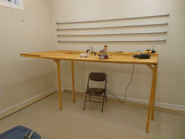

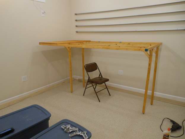

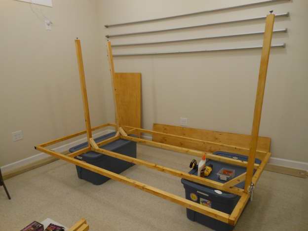

Updated 5/24/2018:
Making progress on the first table. It's upside down as I install legs.

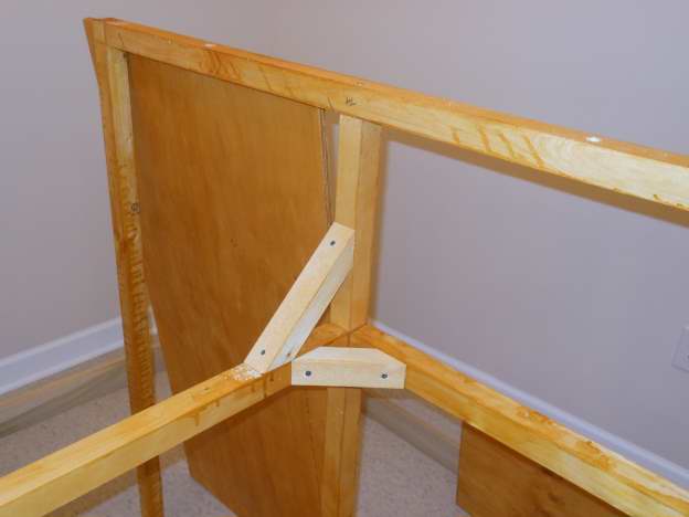

Here's a close-up look at the leg bracing. At the left, that piece of plywood leaning against the frame will eventually sit on top of it.

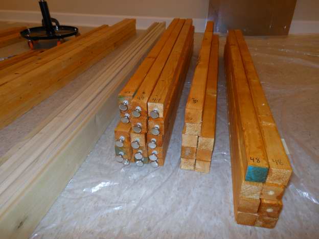

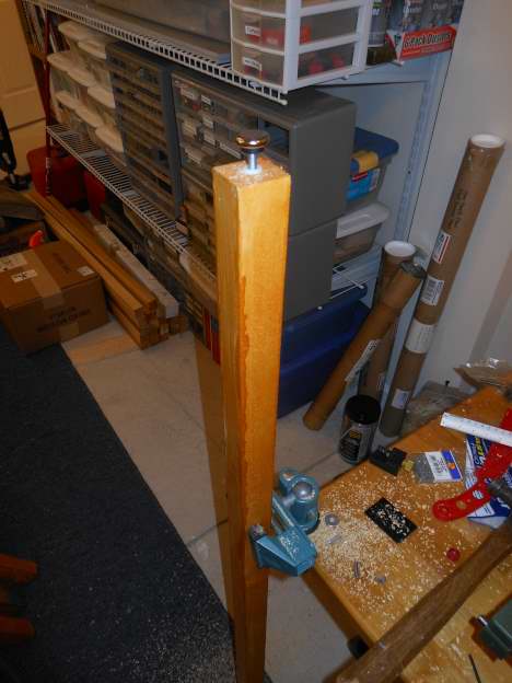

Here's my leg-making set up. That is an interior leg in the vise. At the lower left are a few (18) of the 22 exterior legs that will be required. Adjustable glides are inserted into every leg to allow for fine-tuning the level of the layout.
Shown are 15 of the completed interior legs. I will need 40 in all.
I think I'm starting to pick up momentum! :D

Postby healey36 » Thu May 24, 2018 6:41 pm
Wow, pictures of progress being made...love it.
I know this is way, way, out there, but what's the plan for the underside, i.e. some sort of skirting, or shelving units? I seem to recall Christopher or someone having small shelving units on casters that fit nicely underneath, but they could be easily moved aside when access was required. I went with simple skirting that's stapled to the table edge, than covered with a finished trim board that runs around the table perimeter.
Posts: 4344
Postby G3750 » Thu May 24, 2018 7:01 pm
healey36 wrote:Wow, pictures of progress being made...love it.
Thank you!

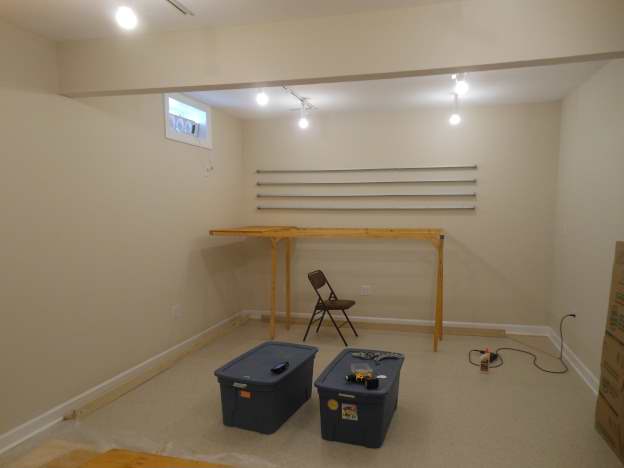

A 1/8" masonite fascia will be attached to the outer edge of the tables. It will probably be anywhere from 6" to 12" high and it's top edge will follow the contours of the terrain. A skirt will hang down from the bottom edge of the fascia.
Underneath, the plan is to store most train cars in plastic bins like the blue ones you see in the first photo. In that photo, you can also see a set of storage shelves against the wall. There will be one more against the back of the backdrop. Cars that are frequently interchanged (loaded for empty and vice versa) will be stored there.

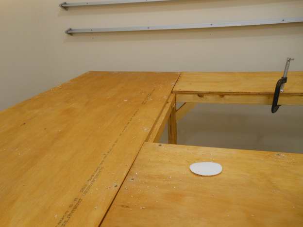

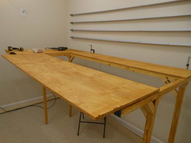

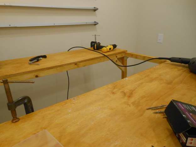

Updated 5/25/2018:
More progress on the first 3 tables (surfaces).
We started with the first surface.
It's not quite in the corner yet. That would leave no room to maneuver.
I started clamping down surfaces to the framework.
Parts of surfaces 1 & 3 (foreground) are screwed down. I found that no matter how careful I am, the fit is never perfect. So I need to deal with my OCD! :lol:
More of surfaces 2 & 3 are screwed down to the framework.
Finally, we have a shot of all 3 surfaces and their framework.
The next step will be to adjust the height, install wall supports, and then screw the table to the wall supports.
