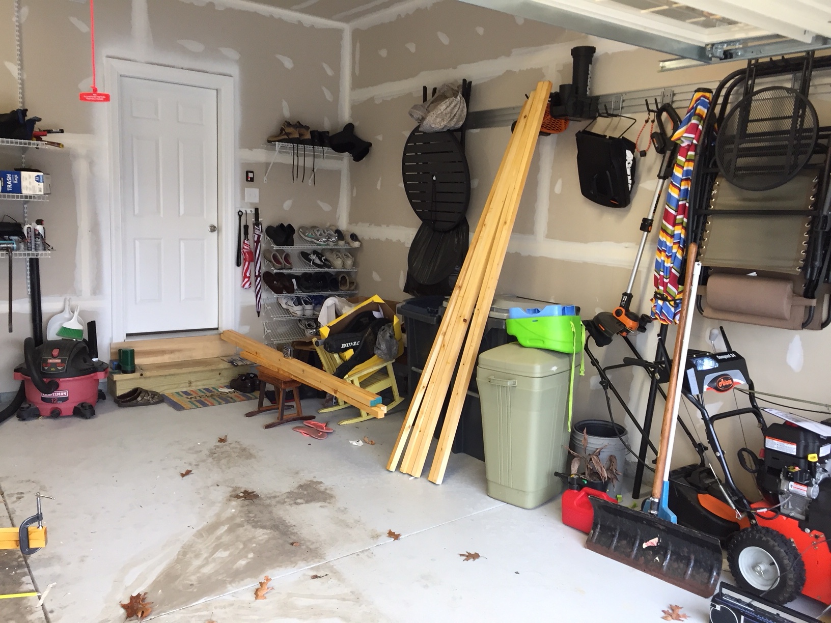

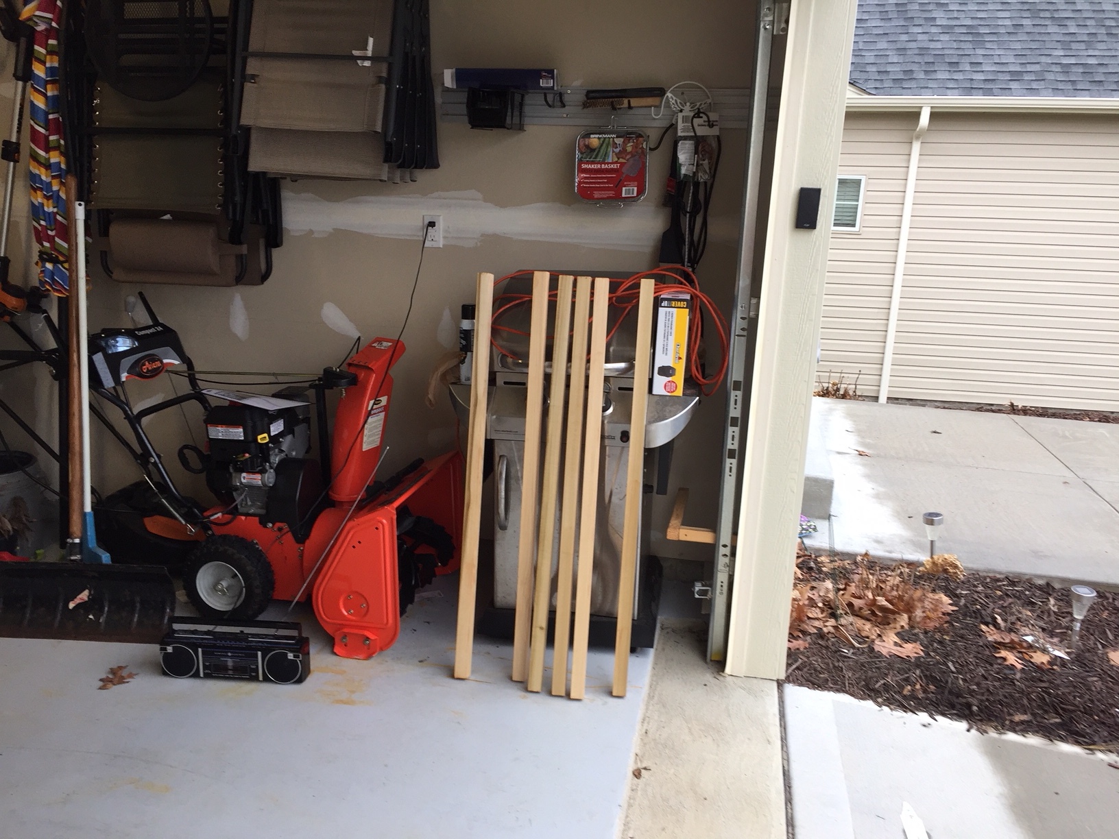

We had a record high temperature of 78 degrees F here yesterday. I took advantage of the balmy weather to open the garage door and stain all the benchwork legs (18). These will support the perimeter of the layout.

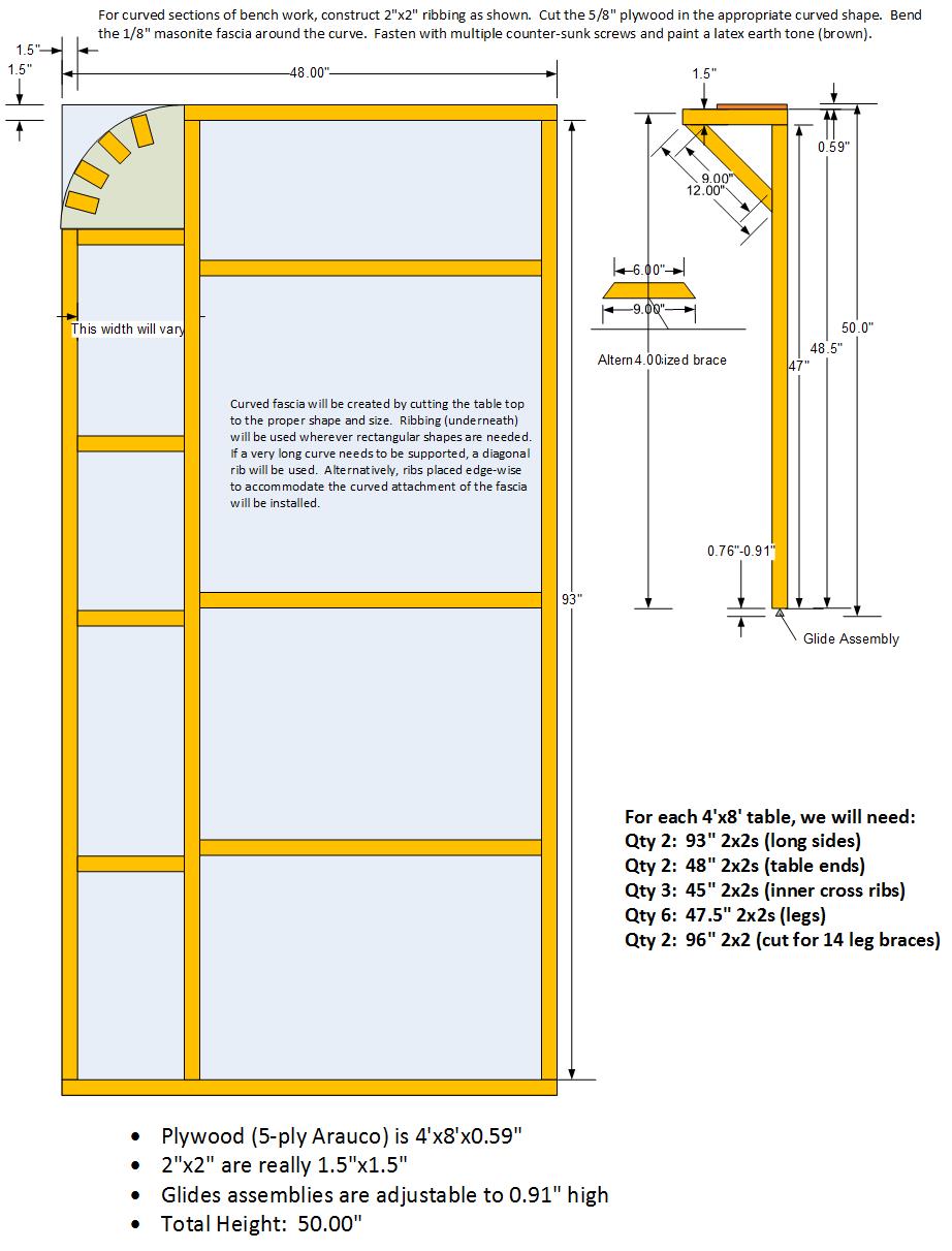

This is the plan for benchwork tables.

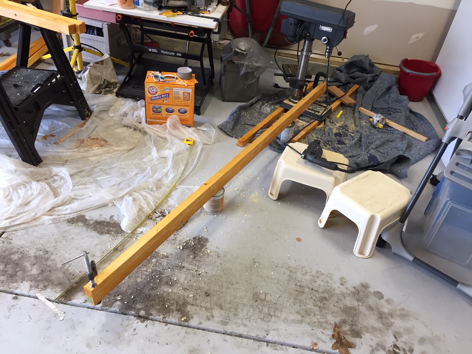

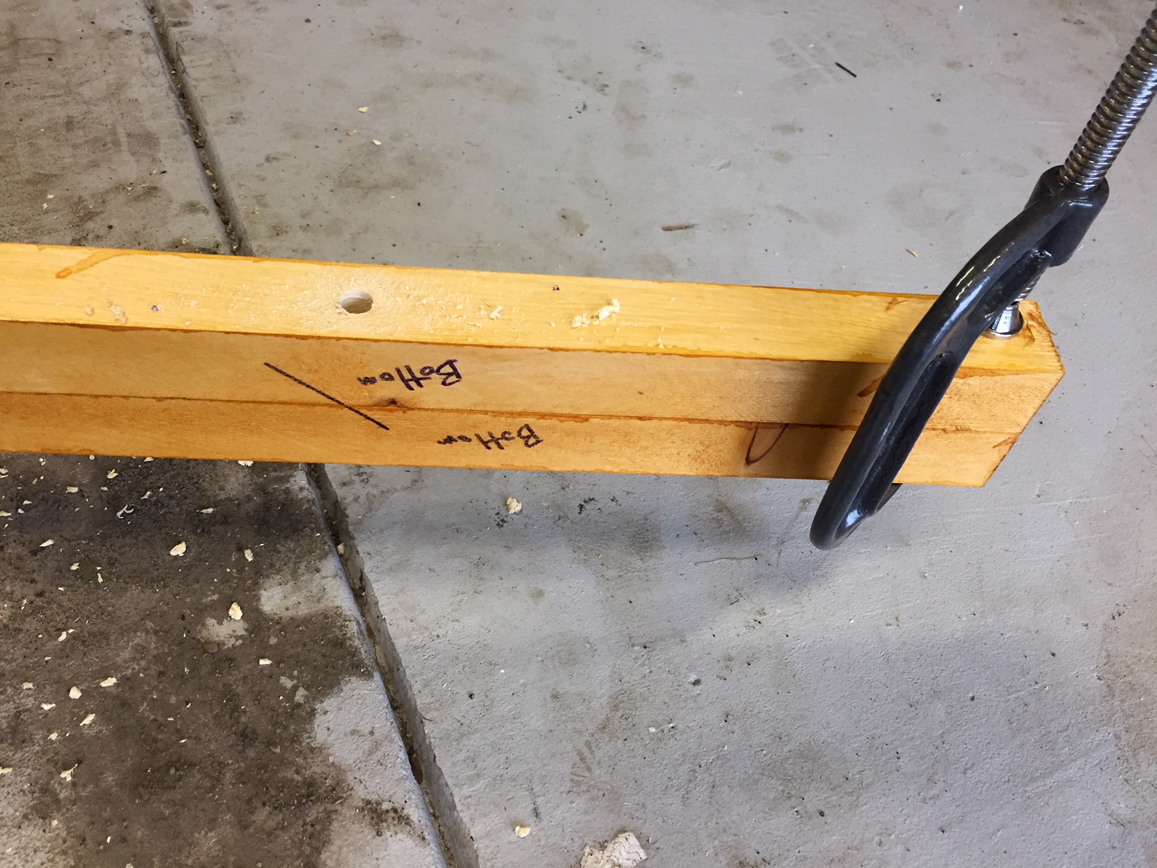

Originally, I planned to drill holes in sides and end ribs for both wiring and for bolting tables together. The plan was to clamp the adjacent sides (or ends) together and drill aligned holes through both pieces. I thought my Sears bench top drill press would be the perfect tool for this work. I was wrong. Whether it was me or the depth of holes or the depth of drill bit needed, it just didn't work. I couldn't adjust the thing to do the job. I ended up clamping pieces together an using a hand drill. I also decided that I would only drill holes for bolting tables together. Wiring will be carried by zip ties with screw holes.

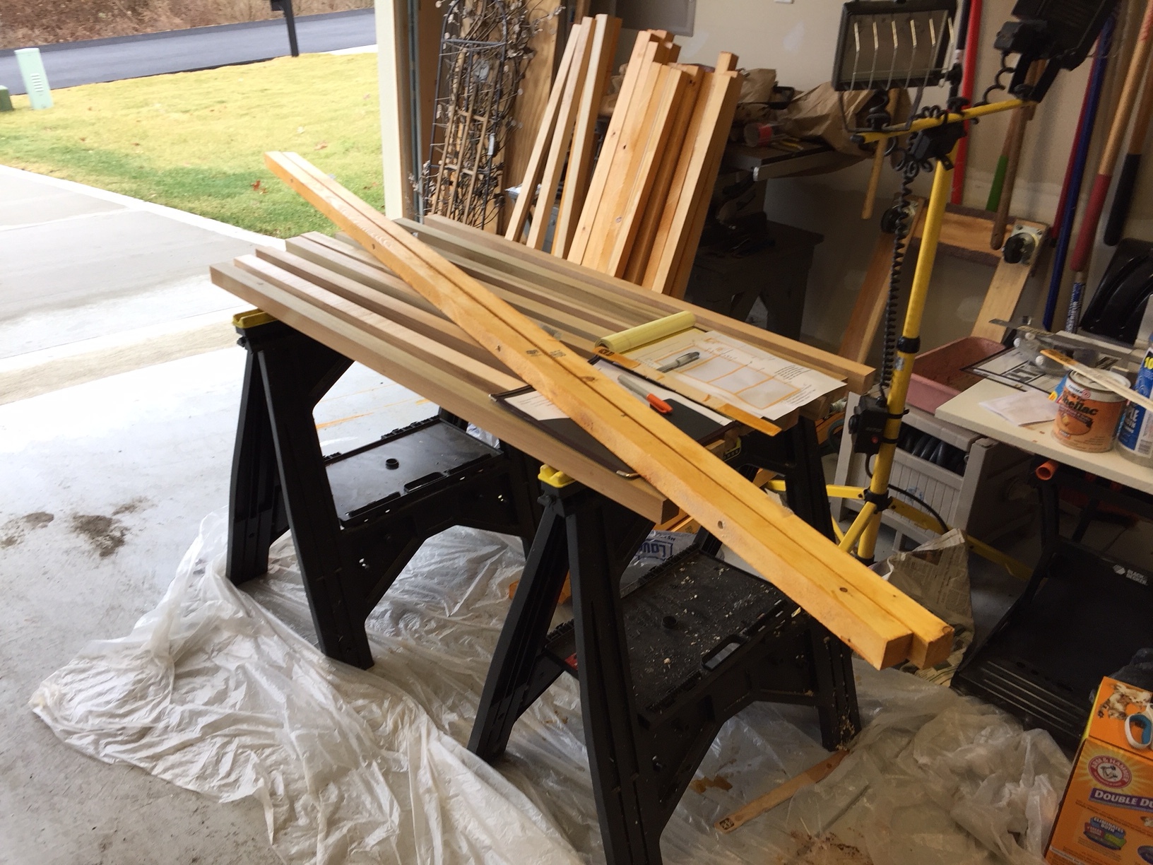

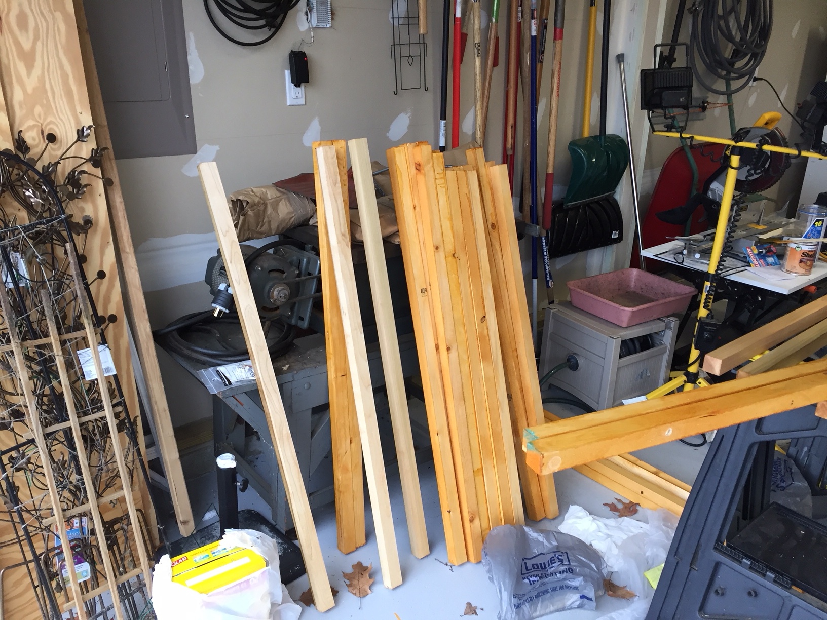

Stained wood. These are some of the "nice" legs that will go on the perimeter of the layout (facing visitors).
Varnished wood - long side pieces.
Some stained and many more varnished legs.
Two sides that I already drilled. They are sitting on some finished (stained) legs.
In the foreground is my set up for drilling holes. In the background is my useless (for this purpose) drill press.
