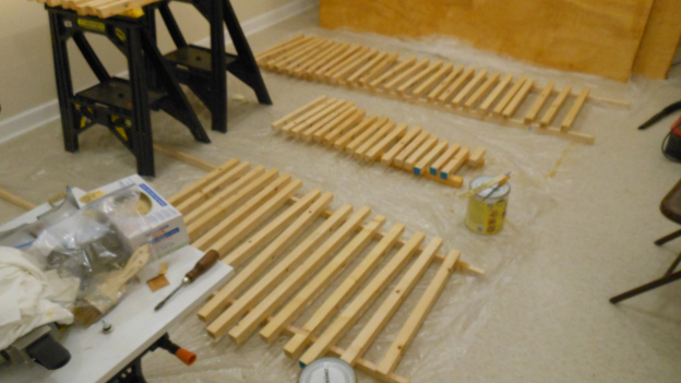

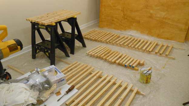

Updated 8/9/2018 (AM):
The shellacking is DONE!!!!!! :D :D :D :D :D
And I never would have gotten it done so fast without the wife's assistance.
As soon as these dry, we will remove the backdrops from the wall, store them in the workshop, and then prepare the walls for hanging the backdrop. I've also got to fill, sand, and smooth the masonite divider wall.

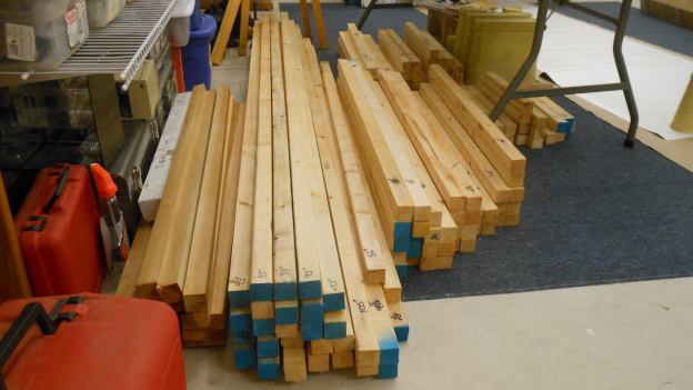

Didn't get to everything I wanted to do today, but I did:
  • Move all the newly shellacked wood into the workshop.
  • Cleaned up the area in preparation for major work next week.
  • Laid out parts of the backdrop on the floor so that they can uncurl.

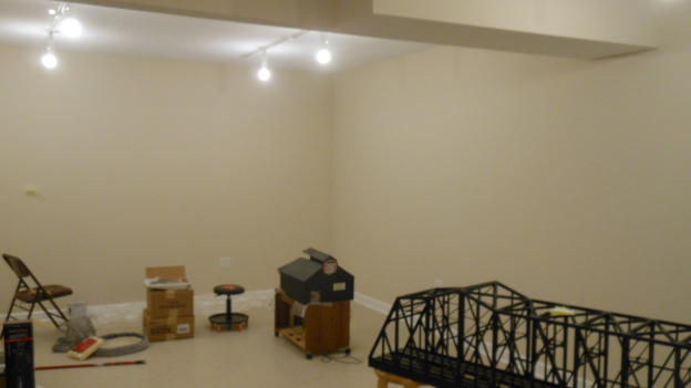

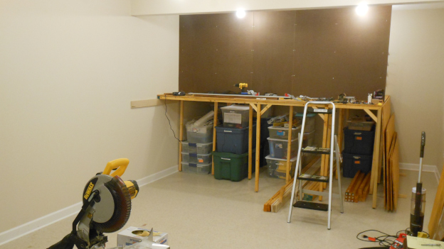

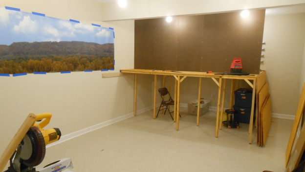

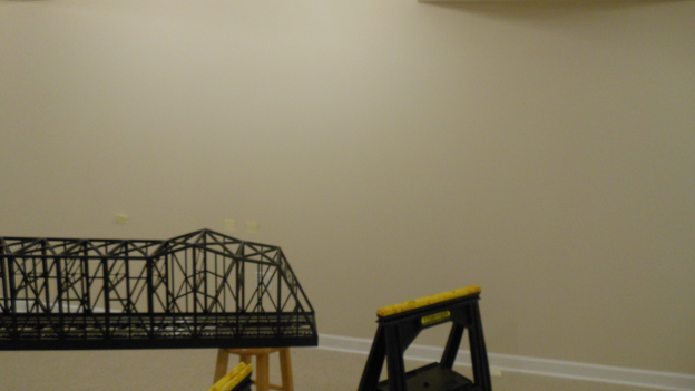

Not a whole lot of forward progress today, but I did manage to spend some time fine-tuning the bench work design for the Steubenville area. It was too humid (we had lots of humidity and rain today) to seal the walls. That will probably happen tomorrow. I did manage to take down all the backdrop sections and store them in the workshop. Then I moved a number of train bins under the Staging Area tables to get them out of the way.
Here's the train room at the moment.

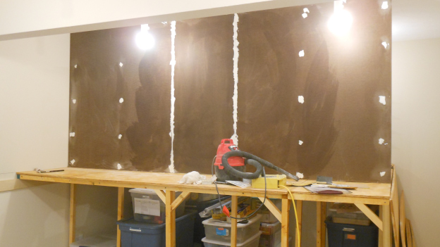

Posts: 4344
Postby G3750 » Sat Aug 11, 2018 9:58 am

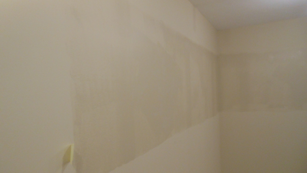

Updated 8/11/2018:
I got the layout room walls sealed with Zinsser Peel Stop, which I had to buy on-line (store didn't carry it). They make you buy 4 cans of the stuff; I barely used half a can. :roll: The other 3 cans are going on Craig's List.
It will probably be the same deal for the wallpaper adhesive. :x Anyway, it's done.
It will probably take a few hours to fully dry. If there are missed spots, I will re-coat it.

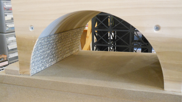

Updated 8/11/2018 (PM):

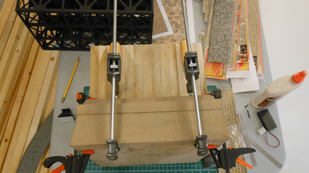

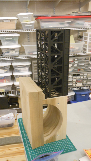

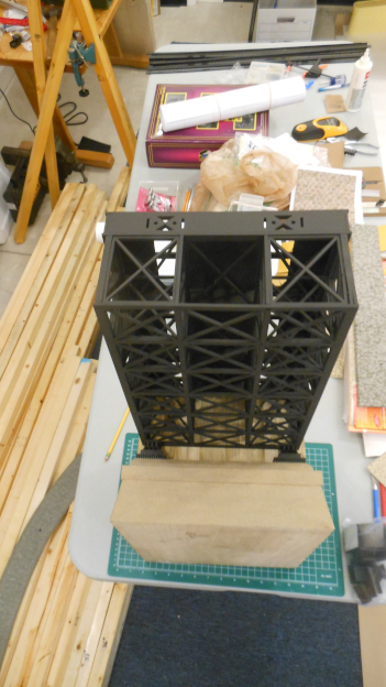

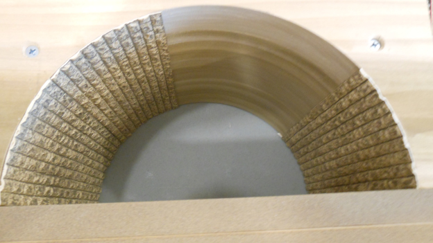

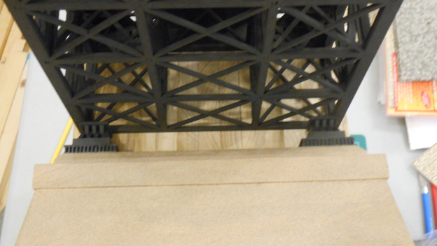

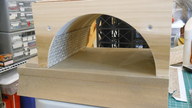

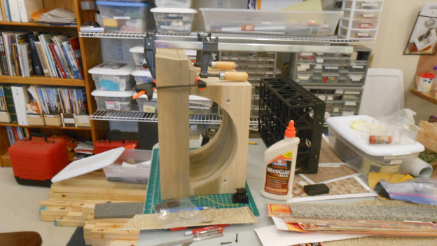

I decided to start work on the Stone Arch at the eastern (WV) side of the bridge. The prototype arch was definitely part of the 2nd bridge on the site and might even have been constructed for the first bridge over the Ohio at this spot.
I'm thinking of covering the western face of the arch with 1:12 stone blocks (printed paper) from the Brickyard program (set printer to vivid, landscape, best). The paper will go inside the rectangle of the bridge. It seems to match up pretty well with the Chooch #8264 Large Cut Stone Wall sections I'm using to cover the arch.
I turned the stone arch on its end (western face up) and test fit the spacer block, pedestals, bridge feet, and 15” plain (no nipple) bridge section. To make the track on the bridge section level with the stone arch, I will use ¼” Vinylbed roadbed on the arch. The track east of the arch will use 3/8” Vinylbed roadbed.
I used orange paint on the end of a toothpick to mark the holes in stone arch where the bridge section will mate up with it. We will need wood screws with a flathead (Phillips) about 1” long. GarGraves track screws of that length might work very well – we’ll test fit them.
I glued the spacer to the base of the Stone Arch's western side.

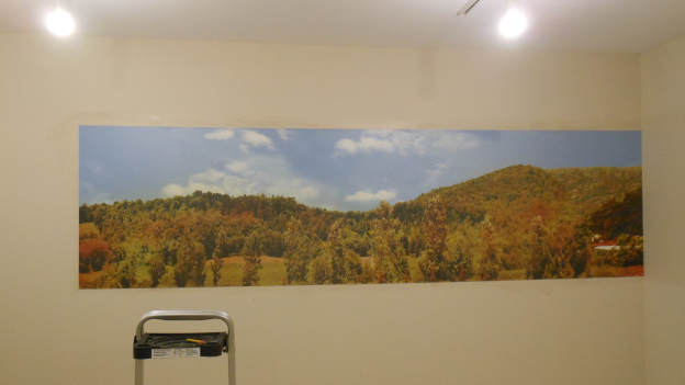

The first backdrop is up (and we're still married!!! :lol: :lol: :lol: )!!!!
Actually, my wife is just awesome at hanging backdrops (no, she is not for hire).

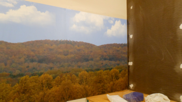

Posts: 4344
Postby G3750 » Sun Aug 12, 2018 3:32 pm
Updated 8/12/2018:
Backdrop installation continues. Steubenville (Panel 1) was installed last night. This afternoon, we have installed Panels 2A and 2B (Hills on the Ohio side of the river).
We forgot to apply Peel Stop wall primer to the area that will hold Panel 3 Bottom (the river itself), so we did that and are now waiting for it to dry.

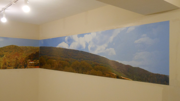

Posts: 4344
Postby G3750 » Sun Aug 12, 2018 10:44 pm

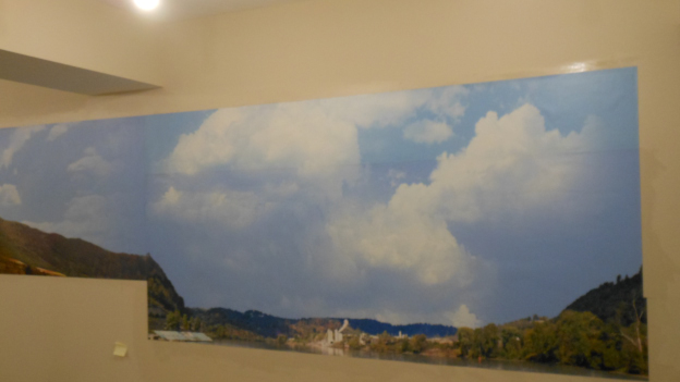

Updated 8/12/2018 (PM):
More backdrop sections were installed today - the Ohio River itself and the sky above it.
I also worked on the stone arch some more. Here are some shots of the arch interior getting its stone lining.

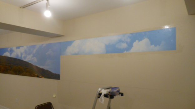

Postby G3750 » Mon Aug 13, 2018 10:02 pm

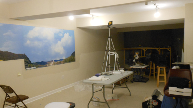

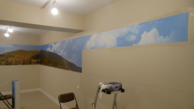

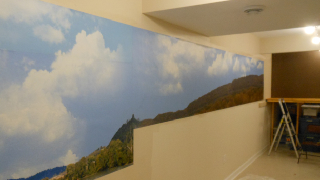

Updated 8/13/2018:

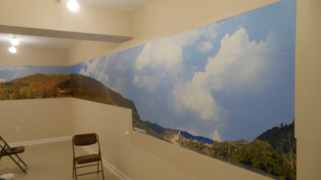

We installed the final backdrops on the long wall of the train room.
For the Ohio River backdrop (2 pieces - 1 top & 1 bottom) we needed a level line higher than the 50" bench work height marker. That's why the laser level (on the tripod) is sitting on a table.
This photo shows both the top and the bottom of the Ohio River panel in place.

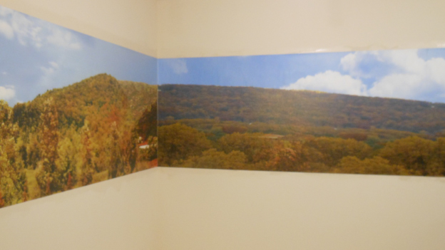

Here's the West Virginia side (panels 4A & 4B).
Finally, the troublesome panel 4C was installed and then trimmed to fit the space. That worked!

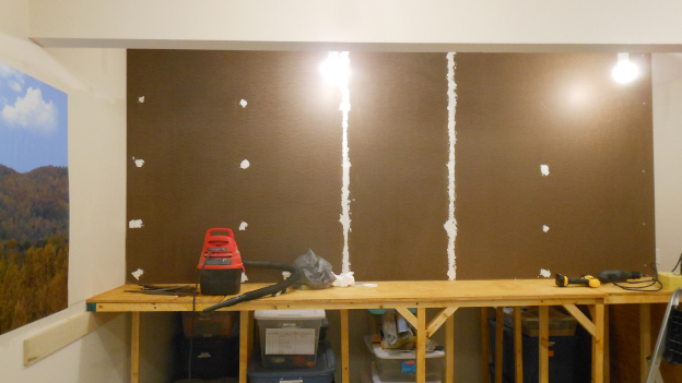

The divider between the Staging Area and remainder of the layout was then prepared by spackling and then sanding.
We're done for the night.
