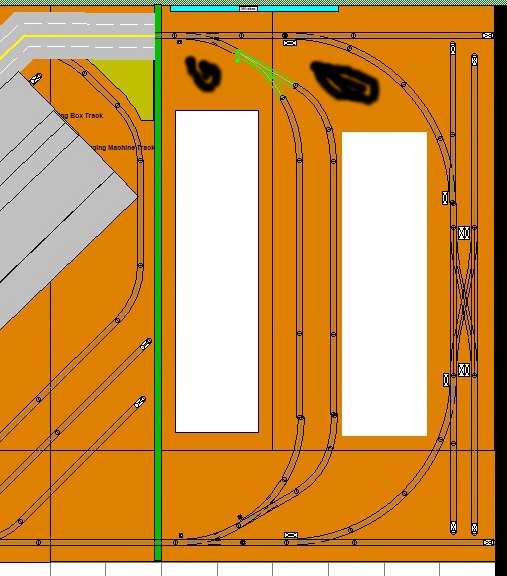

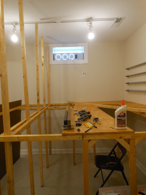

Is that your radon-evacuator on the window above?
No, that is a window fan I bought and installed for venting the basement. In my last house, the basement would get very close with 10-20 people in it. My thought is to have a way to exhaust any accumulated train smoke and maybe get colder outside air into the basement. Don't know if it will have the desired effect.
One assumes hat you can actually get to it with reasonable ease; open the window, etc.?
Rest looks good; more clamps. Good weather for this sort of thing, too!
Well, getting to the window (in blue on the diagram below) has been planned for.
  • The bench work is designed to hold my weight.
  • The open areas can be reached using a rolling stool.
  • There are places (see "spray-painted" areas below) on the bench work to put my feet when I stand (or crouch) there.
PRR Panhandle 2.0 v036-Right-Cropped.jpg (101 KiB) Viewed 2353 times
Opening the window should only be necessary in winter during an operating session or open house. At least that's the theory. We'll see how it works in practice.

One assumes that you can actually get to it with reasonable ease; open the window, etc.?
Seriously suggest that you actually test that theory as early as possible to avoid excess backing up over yourself. Getting up there may prove to be "interesting" at some future date and might prove worth doing to avoid having an elbow removed.....

Postby G3750 » Sun Jun 03, 2018 2:52 pm
Yes, I plan to test it very soon. I need to get some plywood on the table closest to the window first.
Posts: 41916
Postby Rufus T. Firefly » Sun Jun 03, 2018 2:58 pm
G3750 wrote:Yes, I plan to test it very soon. I need to get some plywood on the table closest to the window first.
Good plan. If you need to make a modification, now is the time.

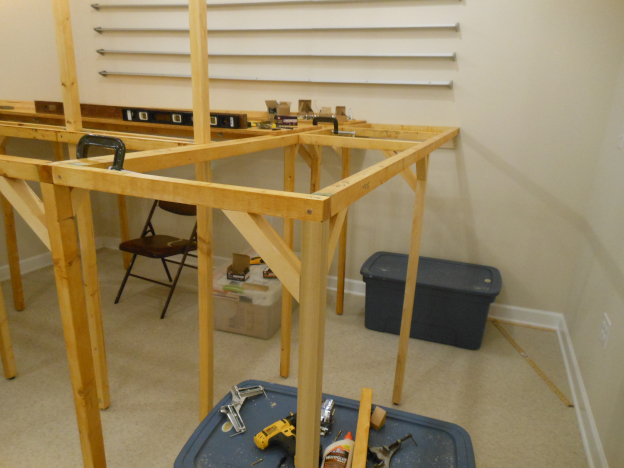

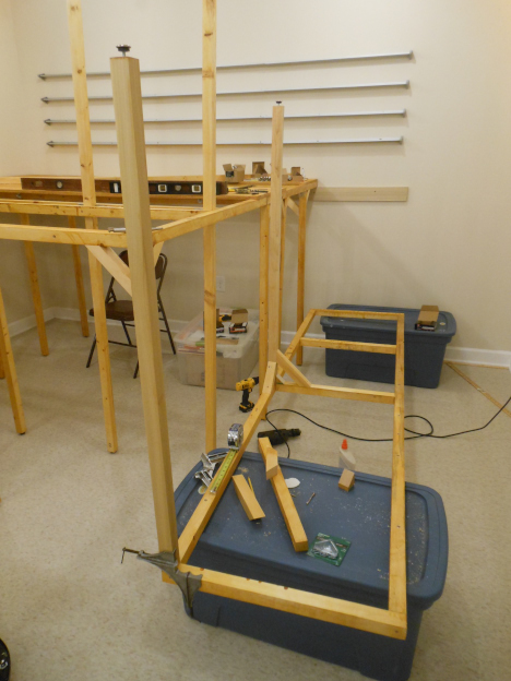

Updated 6/03/2018:
After church I managed to assemble most of the 2' x 8' table nearest the aisle (surface #4 on the diagram). I still have a cross member to add and a vertical upright for the divider. After that, I will install the divider and most of the Staging Area will get its plywood subroadbed.
Here are some photos. This first one shows the table on its back with the legs being attached.
I clamped the new table to the others in the Staging Area. This table's legs differ in several ways from the others.
  • They are outside legs and will be more visible than the others.
  • Because they are more visible, I used poplar so as to improve their looks. I also stained them a slightly darker color than the others (not sure it shows up).
  • Because of imperfections in the floor, these legs are 1/4" shorter than the others. I am also using a slightly wider leveling glide.
Here's a closer view of the table. A cross member will be installed support the final vertical backdrop column. The vertical will go at the extreme right hand side of the table.
