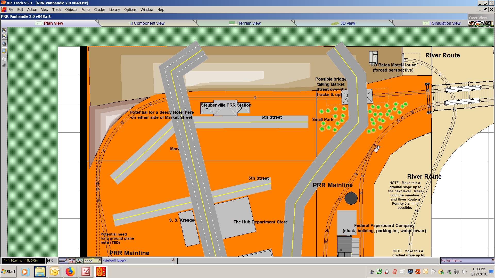

Updated 3/11/2018:
The refinement of the Steubenville side of the layout continues. Here is the view of the northern part of the layout.
Steubenville-N v048.jpg (629.87 KiB) Viewed 2498 times
Since the last look, I've added the correct location of the PRR station on N. 6th Street, the Federal Paperboard factory, a re-sized version of The Hub department store, and 5th Street. Both 6th and 5th Streets will be populated with a prototypical sampling of the correct businesses (can't fit them all).

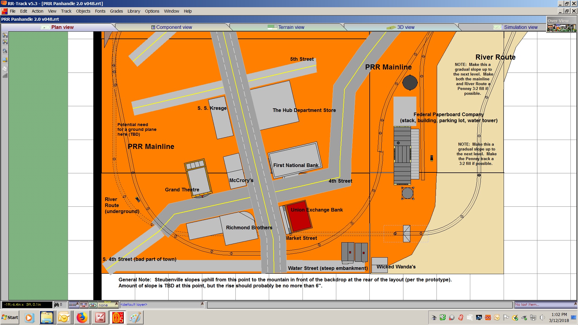

Here's a look at the southern half of Steubenville.
Steubenville-S v048.jpg (589.57 KiB) Viewed 2498 times
This part of Steubenville will feature the intersection of 4th Street and Market Street, the prominent businesses on lower Market Street, N. 4th Street, and S. 4th Street, and the red light district at Water Street.
The terrain will rise from a low point at the south side of the layout to the northern points near the PRR station. Beyond that track, the terrain will rise sharply over then next 2 feet to meet the backdrop.
Postby chuck » Mon Mar 12, 2018 9:18 pm
I think that looks great. You might be able to use more generic HO and N scale structures along that back wall as you build up to the back drop (like the Bates Motel).

Thank you. I will keep that in mind.

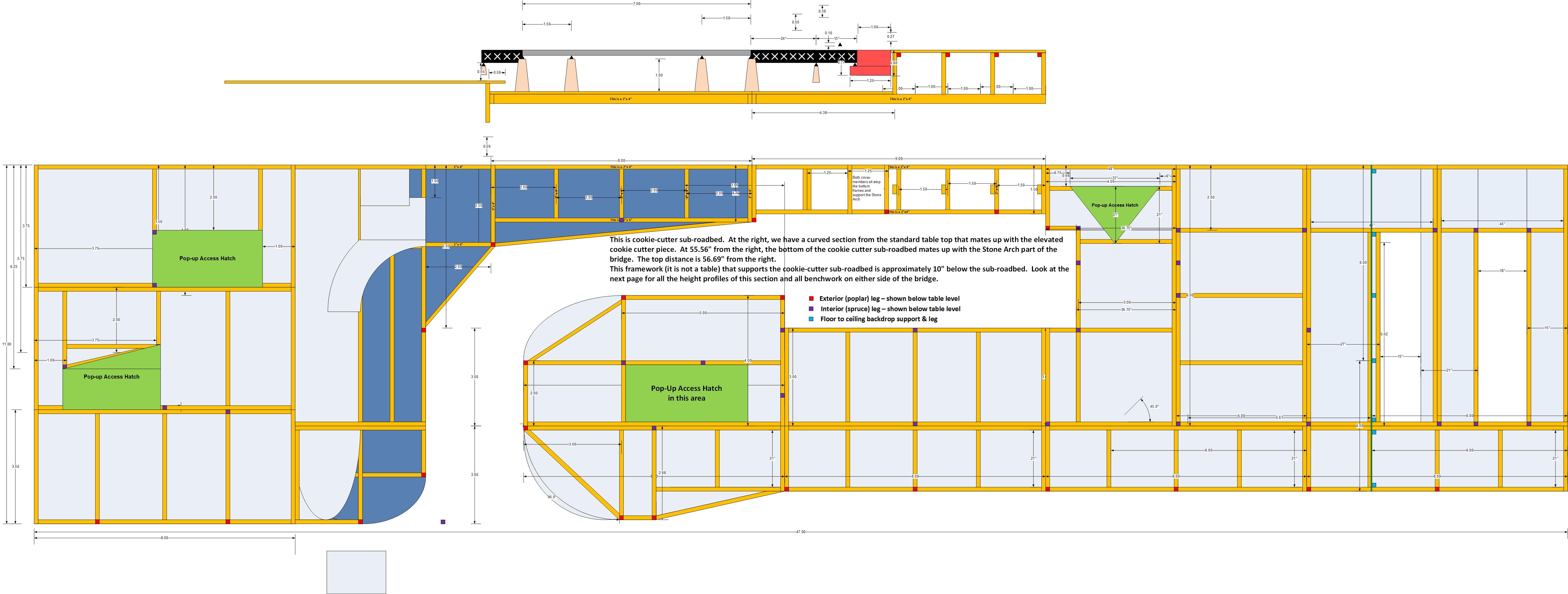

Updated 3/13/2018:
Below is the benchwork plan. Some guidance to interpreting it:
  • The main level (table top) is LIGHT BLUE.
  • Lower levels, either the River Route (which is 9-10" below the Steubenville benchwork level) or the Ohio River and low level (flood plain) West Virginia shore is DEEPER BLUE.
  • Pop-up access hatches are GREEN. I have tried to position those so that all hard-to-reach areas are accessible; ribbing placement is adjusted accordingly.
Table 10 Benchmark.jpg (787.71 KiB) Viewed 2472 times
Above the top view of the bench work is a side view of the bridge section showing the levels of the piers and abutments.

Starting to make more sense now. :D

Looks great...presume that blue area is the river, flowing across the foreground of Steubenville on the left. That should be unique...very neat. I can see some barge traffic...

After the railroad, mills and towns.
