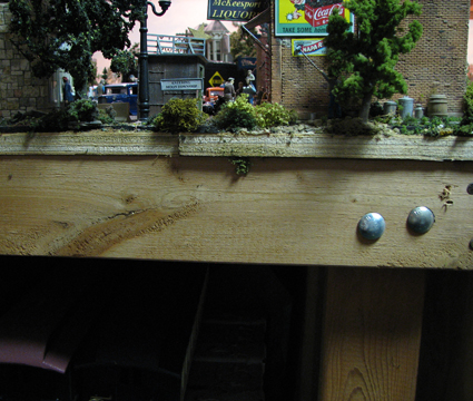

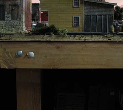

Hi Healey and George, It is especially gratifying to me that when I first constructed my layout in 1995, I used some of the same rationale you both have explained in this part of the thread.
That is, I used 3/4" plywood precisely because I did want it heavy and sturdy enough, like you, Healey, to hold my walking atop it, which I knew would be often.
I used 2x4s for the frame and the inner bracing, configured just as your diagram explains, George, and made 2x4 legs as well.
A second and a third level were constructed the same way, albeit it with shorter legs, of course.
I have approximately 15 such platforms establishing the main level of the layout, each bolted to the other along their sides and ends, where they abut, all of which, combined, makes certain there is no wobbling or shifting around whatsoever.
Every edge of the layout which is not along a viewing aisle is against a basement wall.
Here are two shots showing examples of the very amateur work I accomplished, which is exposed for these pictures along the viewing aisle. I continue to mount the layout to this day, though I keep that little bit of exercise to a minimum, these days.
- IMG_0606cx.jpg (170.76 KiB) Viewed 3170 times
- IMG_0604cx.jpg (192.83 KiB) Viewed 3170 times
