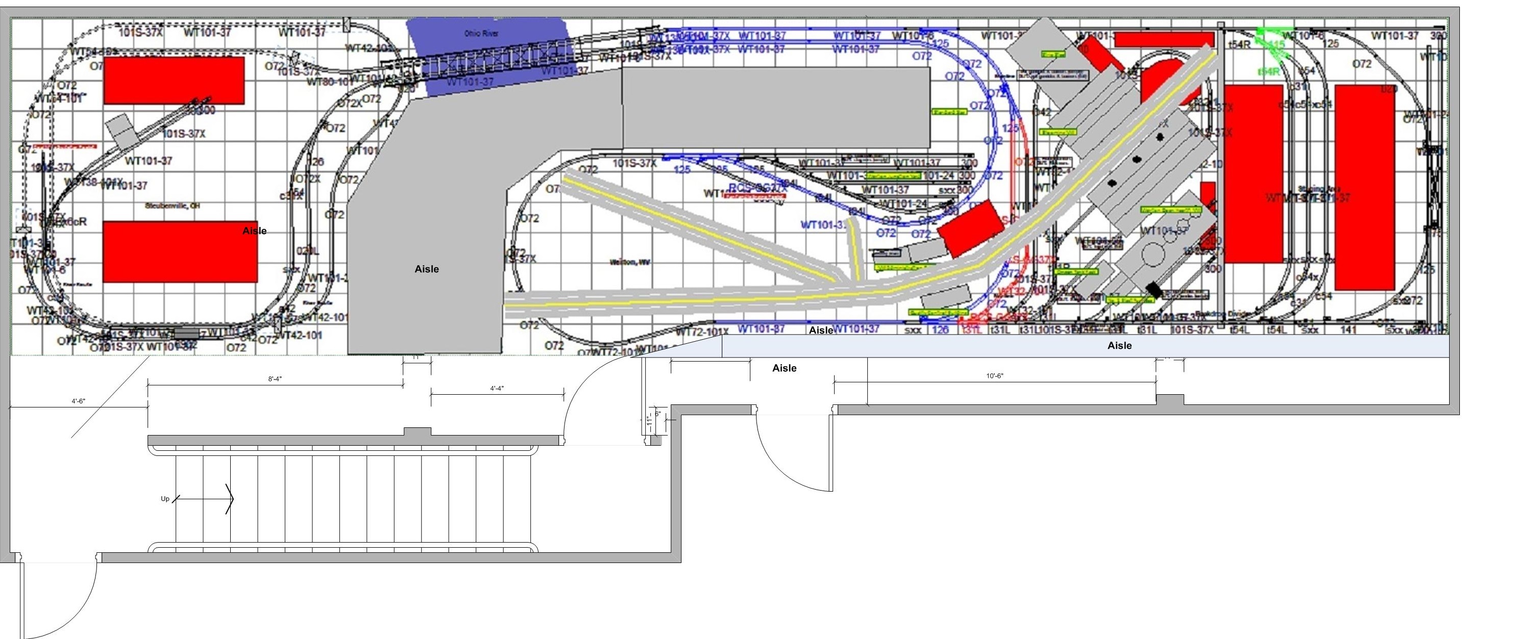

What are the red areas? Pop up access or........... There are a lot of sidings that I'm not sure of purpose other than guessing that they relate to prototype demands?
Is there any way to "see" how the current version of your plan fits into the footprint of the room?

Rufus T. Firefly wrote:What are the red areas? Pop up access or........... There are a lot of sidings that I'm not sure of purpose other than guessing that they relate to prototype demands?
Yes, the red areas are pop up access or hand holes.
The large number of sidings, especially in the Weirton Steel area (I believe you are referring to them) are required by the different operations:
  • Blast Furnace: Empty slag cars in / Full slag cars out. Empty hot metal cars in / Full hot metal cars out.
  • Open Hearth: Empty ingot buggies in / Full ingot buggies out
  • Blooming Mill: Full ingot buggies in / Empty ingot buggies out. Empty slab cars in / Full slab cars out.
  • Strip Steel: Full slab cars in / Empty slab cars out. Empty coil gondolas and box cars in / Full coil gondolas and box cars out.
Rufus T. Firefly wrote:Is there any way to "see" how the current version of your plan fits into the footprint of the room?
Boy I am glad you mentioned this. I rechecked the dimensions of the room and the terrain differs from the map, so to speak. The left half of the room is actually 13'6" wide, not 14'. At 20'10" from the left wall, it narrows to be only 12'8" wide all the way to the right wall. So, I am in the process of tweaking the layout a bit to fit those dimensions while retaining adequate aisle space along the front of the layout. Thanks Rufus!
The good news is that we can make the adjustments while preserving the general shape of the layout. This will work!
Glad to be of assistance then; good to know that the pieces fit..... :mrgreen:
Rufus T. Firefly wrote:Do you need some "inspiration"? :lol: :lol: :lol: :lol: :lol: :lol: :lol: :lol:
Actually, I think I'm good there. :lol: [/quote]
Well, if you're sure........ :lol: :lol: :lol:

I have rendered, as best I could, the train room and the layout's placement within it. Yesterday, I took a number of detailed measurements of the room and created a Visio drawing of it. Then I placed a JPEG of the RR-Track layout on top of it. It's not perfect, but it should convey the main idea. Anywhere you see solid white or gray areas are aisles. I couldn't extend those to fit the odd shape of the areas, so I created blank spots (bluish-gray) and labeled them as aisles as well. The spaces are actually, in fact, contiguous. I think we end up with aisles that are minimally 30" (maybe 34") wide.
The leftmost door leads to the workshop. The center door opens to a closet under the stairs. The rightmost door leads to the roughed in powder room / furnace room. The stairs lead up to the main floor.
Train Room4.jpg (666.62 KiB) Viewed 16033 times
Your thoughts please,

Postby healey36 » Tue May 16, 2017 5:27 pm
Looks like an outstanding plan to me, lots of options for scenery, good operational variability there to keep things interesting. Lots of access. The freakin' bridge looks like it won't aesthetically overwhelm the layout...very nice. It's probably way more than I would bite off at this point, but that's just me.
As a tinplater I would make one recommendation from a track-plan perspective - make sure you have at least one loop where you can grab a cup of coffee or a beer and just let them run. There's something deeply soothing in doing that at times.

healey36 wrote:Looks like an outstanding plan to me, lots of options for scenery, good operational variability there to keep things interesting. Lots of access. The freakin' bridge looks like it won't aesthetically overwhelm the layout...very nice. It's probably way more than I would bite off at this point, but that's just me.
Thanks Healey!
It probably is a bit much, but I'm going to go for it! It should keep me out of trouble for quite a while! :lol:
The mainline is a folded dogbone. Realistically, I could probably run at least 3 good-sized (10-15 cars) on it simultaneously or a train continuously without operator intervention.
