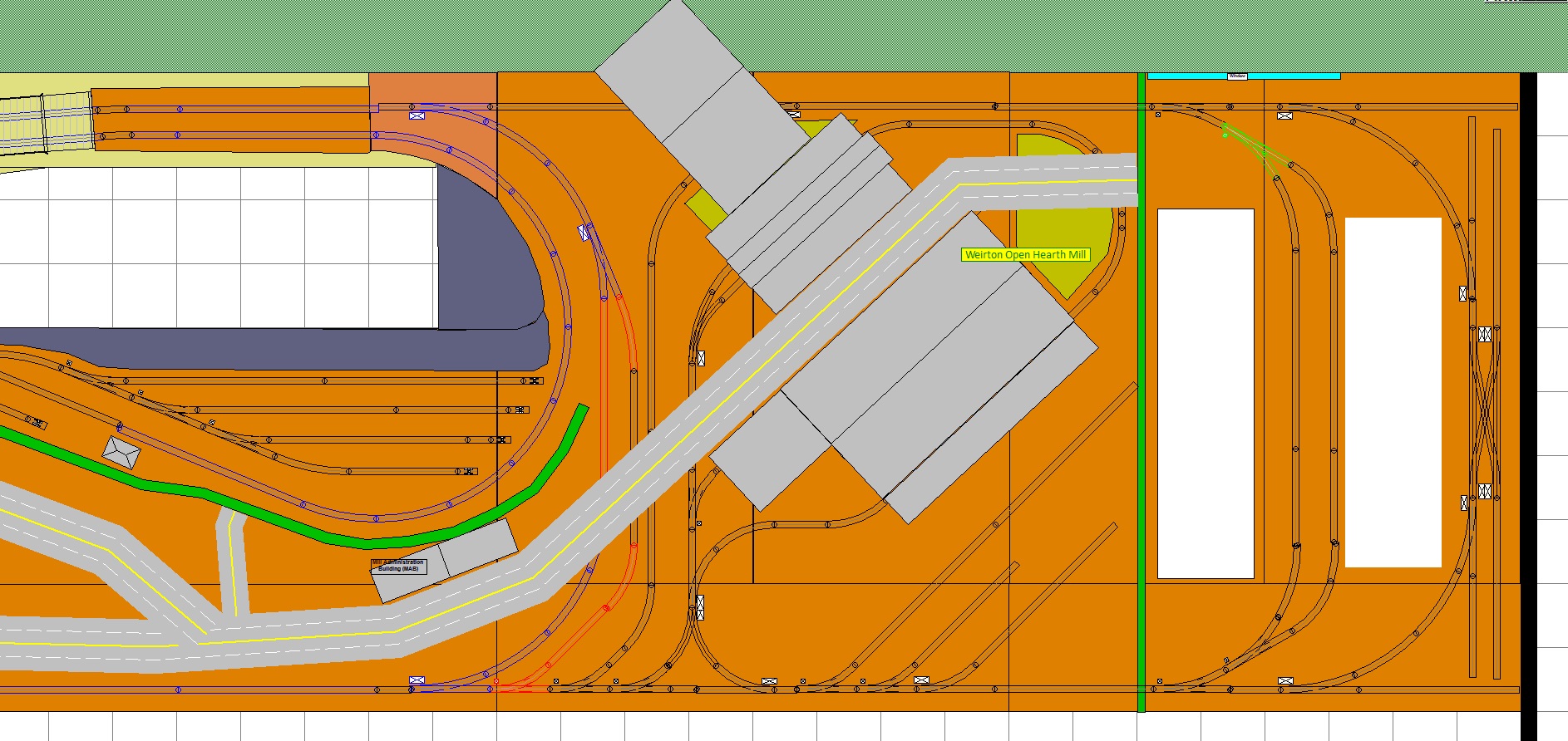

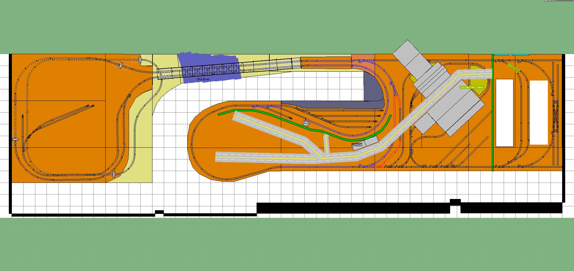

Postby G3750 » Tue Aug 29, 2017 5:53 am
Updated 5/29/2017:
After much thought and measurement, I have constructed a detailed room plan and within in it, a detailed track plan. Walls (except the top) are shown in black. You can now see the available aisle space.
PRR Panhandle 2.0 v032.jpg (696.8 KiB) Viewed 4676 times
Let's take a close-up look at the Eastern end of the layout first.
PRR Panhandle 2.0 v032-R.jpg (484.03 KiB) Viewed 4676 times
Moving right to left (east to west), here's a partial list of the changes:
  • Resizing of the Staging Area. It is now 6'x11'. White spaces within are open areas (holes) in which the operator can stand. The basement window is shown. The back of the divider will be used to hold train storage shelving. This area will be used to make up and store trains.
  • The Weirton Steel area picked up about 11 sq feet (down from the previous 22 sq feet). I think it is enough to accommodate at least part of a blast furnace (cast house, kettle, and 1 stove) jutting out from the backdrop (divider). The lime green areas are pop-up access hatches. The back of the Open Hearth building will be open to give access to derailed cars. The Strip Steel and Blooming Mills will be supported by the table top but reachable from underneath.
  • The specific track geometries were tweaked. We now have a loop of track within the mill complex for turning a train (thanks Chuck!). And a wye was added. This gives us a lot of flexibility in turning outbound trains.
  • The divider will hold a backdrop composed of Weirton Steel buildings (photograph).
  • The blackish/dark gray area is Standard Slag; track directly below it (south) is for dumping slag.
  • Weirton Junction was lengthened. The bottom most track is reserved for cabin cars. The two tracks above it are for freight / steel related cars.
  • A doubled-sided backdrop will divide Weirton Junction from Weirton itself. On the Weirton Junction side, this will be a photograph of trees with some actual trees in the foreground. On the Weirton side, the backdrop will climb as it heads up County Road. It should just be high enough to split the scenes.
  • Aisles are approximately 2.5' to 3' wide. There is one 2' wide section near the bridge. I had to make some real fine adjustments to keep the O72 curves.

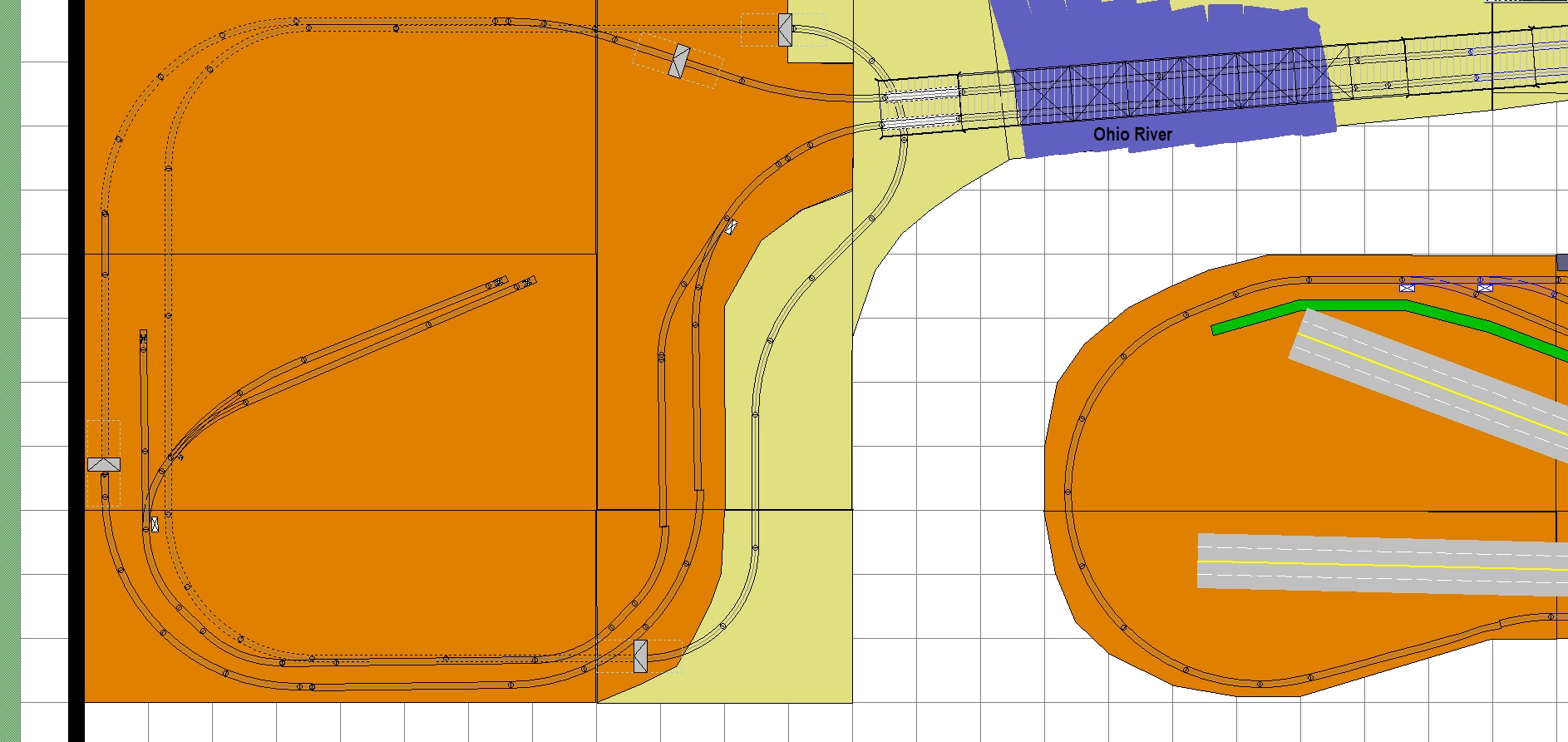

Looking at the Western end of the layout:
    PRR Panhandle 2.0 v032-L.jpg (337.84 KiB) Viewed 4676 times
  • The bridge module has been redrawn to accurately reflect the size and position of the approach spans and the arch. Track east of the bridge will be positioned on fill. I'm trying a new technique here.
  • Tracks west of the bridge have wide sweeping curves (O138 in one case).
  • The mountain is significantly larger (7'x8') than the one planned for Panhandle 1.0.
  • I am still debating the fate of the coal mine. At this point, I have a lot more space to portray downtown Steubenville and I am inclined to use it for that purpose.
  • Access hatches for Steubenville have not been created yet. Their position will depend on the placement of streets and buildings, which has not yet been elaborated.
  • Below the level of the layout (shown in a yellowish color) is the River Route. This will be a completely separate loop. It will use the TPC-400 to permit conventional running. It will give any visiting smaller kids a chance to run a train.
Postby rogruth » Tue Aug 29, 2017 1:29 pm
Lots of coal trains on the river route.

Postby rogruth » Tue Aug 29, 2017 7:57 pm
I seem to recall that you mentioned that traffic through the bridge was always the same direction. I took that to mean one track was east bound and the other west bound. With the reversing loop in the plan that would now be changed. I think. Might that change your signaling plans?
On the west/left end there are some small white rectangles crossing the track. Are those tunnel portals? If so, try to be very careful where you have switches oops turnouts inside the tunnels. :roll: :roll: :wink: :wink: :D about the switches. This is 3 R O.
The east/right end past the scene divide is the staging area. You are going to put shelves on the back of the divider for car storage. I like that because it has them near-by to where they can be put in use. How thick will the divider be and how will the shelves be mounted?
Posts: 4344
Postby G3750 » Tue Aug 29, 2017 11:00 pm
rogruth wrote:I seem to recall that you mentioned that traffic through the bridge was always the same direction. I took that to mean one track was east bound and the other west bound. With the reversing loop in the plan that would now be changed. I think. Might that change your signaling plans?
The bridge will have 1 east bound track and 1 west bound track. The reversing loop is really for use by the Weirton Steel switcher(s). Trains will have to travel between the mill and Standard Slag. I had not given much thought to signaling the layout for bi-directional travel. Most of the yards are accessed through trailing point turnouts.
I have learned my lesson well about switches (turnouts) in tunnels. :oops: No, no, and hell no! :lol: Yes, those are tunnel portals, but I have no turnouts inside tunnels this time around.
The divider will be a sheet of masonite (1/8"?) supported by six vertical 2"x2"s. The masonite side will hold the backdrop. The shelves will be mounted on the other side to the 2x2s.
Postby rogruth » Wed Aug 30, 2017 12:11 am
OK. That looks good then. I assume you will make some adjustments as you go.
