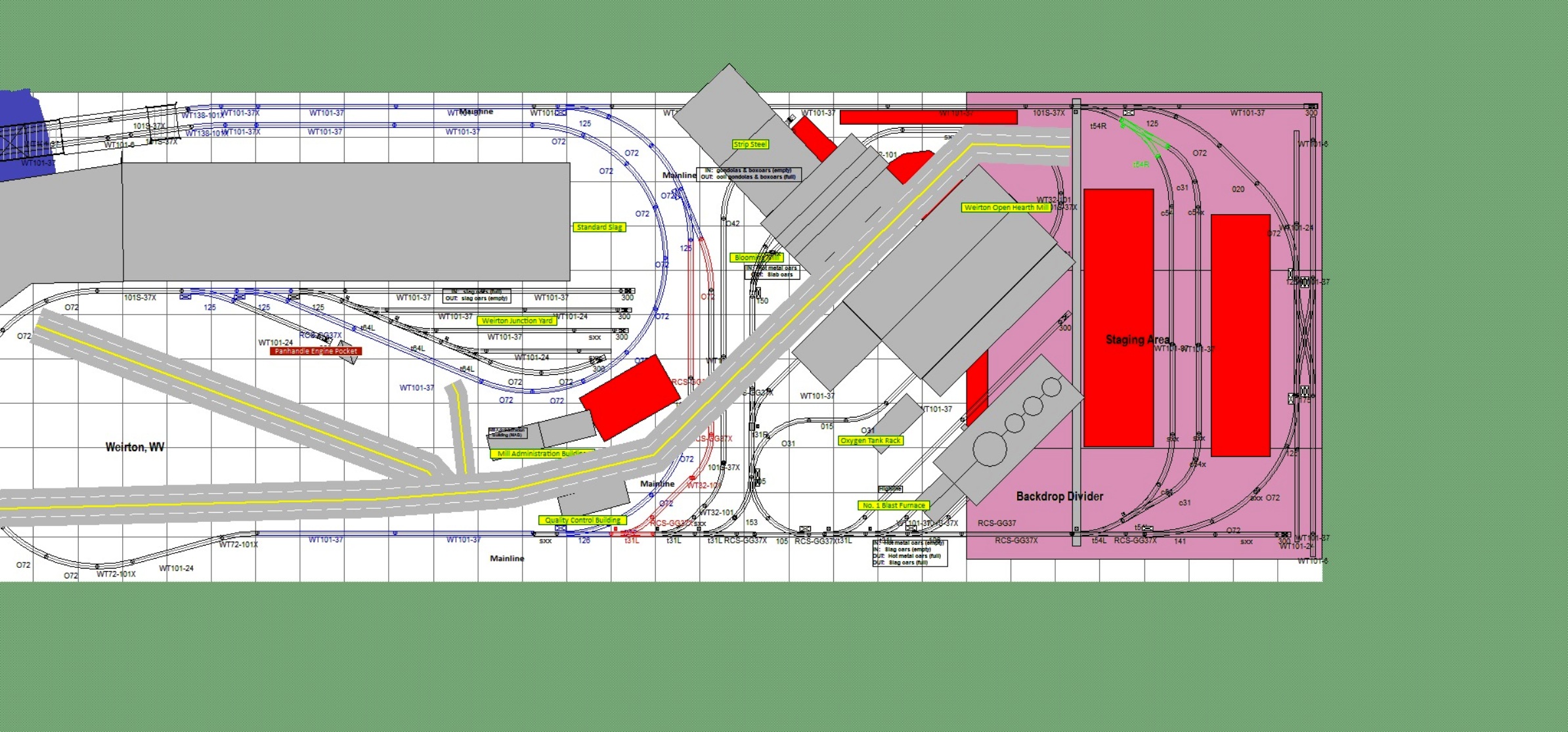

Postby G3750 » Sat Aug 19, 2017 12:53 pm
Updated 8/19/2017:
I've been doing a lot of thinking (always dangerous :wink: ) about the Weirton Steel and the Staging areas of the layout. Here's the new look.
PRR Panhandle 2.0 v027-Right Side.jpg (1.02 MiB) Viewed 4718 times
The major changes are:
  • Shrunk the Staging Area. In the process I lost 1 holding track, but gained 22 square feet in the Weirton Steel Area.
  • Enlarged the size of the Open Hearth and modified its shape to better reflect the prototype.
    Open Hearth.jpg (34.45 KiB) Viewed 4720 times
  • Modified the track arrangement in the Weirton Steel area to add a wye. This helps in moving hot metal cars between the Open Hearth and the Blast Furnace, and also prevents fouling of the main line (in order to access the switching lead).
  • Added spurs in the yard that serve the building. For example, the Blast Furnace now has a Highline, a spur for slag cars, and a spur for hot metal cars. The Blooming Mill has a spur for ingot cars and for slab cars; an old photo tells me where the doors should be in the building.
  • I haven't fully fleshed out the size of the blast furnace, but if I specify it as No. 1 (the smallest), I have some flexibility there (modeler's license).
Your thoughts?

Postby healey36 » Sat Aug 19, 2017 4:20 pm
Holy-bejeebers, that looks massive in scale. You may need 2x10's for table-legs to support the weight! It would be impressive, much like the bridge. I think I would be tempted to lop a third of the back side off and build it as a bump out from the partition...scarfs up an awful lot of real estate.

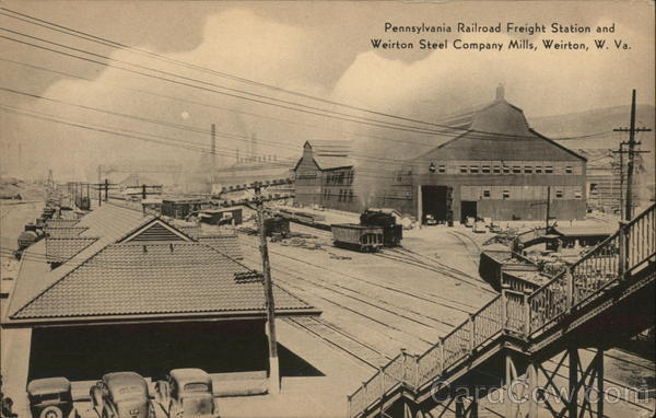

Have any more pics of that station in the last two photo's? Would like to see more of that.

Postby G3750 » Sat Aug 19, 2017 5:17 pm
healey36 wrote:Holy-bejeebers, that looks massive in scale. You may need 2x10's for table-legs to support the weight! It would be impressive, much like the bridge. I think I would be tempted to lop a third of the back side off and build it as a bump out from the partition...scarfs up an awful lot of real estate.
I will cut off a bit and push it back against the backdrop at an angle. I'm not familiar with the tricks needed to make RR-Track like non-square buildings. Doing that will leave more space for the Blast Furnace (another large structure). I'm just trying to get enough of these buildings to convey their presence. I will probably cut the Strip Steel (building at the top of the row of mills) in half so that it doesn't visually "leak" into the bridge scene.
Like I said, right now it's play time. We'll see what really gets built as time goes by.
Not sure if I have any other photos of the station. I'll poke around. When I worked in the mill in the early 70's, it was serving as the shoe store (steel-toed boots).
Postby chuck » Sun Aug 20, 2017 7:49 am
I like it. Staging areas are a necessary evil in model railroading unless you have pole barn or abandoned movie theater to put in real yards.
Make sure you have enough clearance on that back track (backside of the double crossover). It looks pretty tight and you don't want to derail or scrape equipment/walls when making the turns into/out of that crossover.
